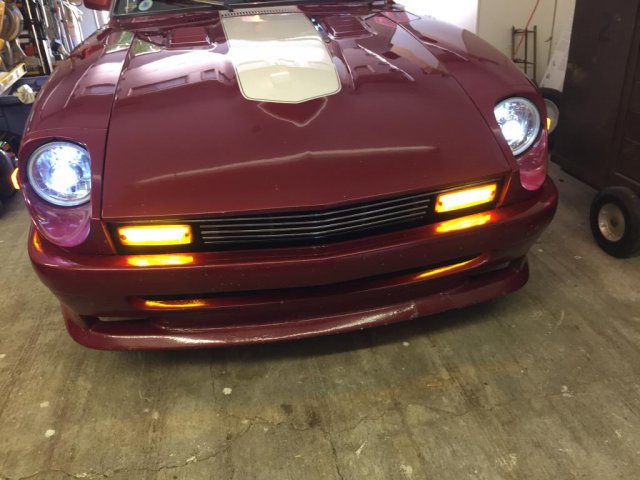

Well, turns out it wasn't the hi/low switch after all with the passenger side hi beam not working. When hi beam is selected there is a "click" on the drivers side but not on the passenger side. Basically that means that the power to actuate the hi beam solenoid is not getting there. Now it's time to remove the wheel, remove the fender liner, remove all the electrical tape that is on the wiring and check each connection and check voltage at each connection. Some partially good news is that I need to pull a wheel anyway to get the model/serial number off the Willwood calipers so that I can order new pads when I get new rotors. I'm trying to determine if I can use a Spec 37 rotor in place of the Ultralight rotor. It is more expensive but also is much more durable and comes machined true where the Ultralights don't. Last time I put the Ultralights on I had to have both of them turned on the car to true them up and eliminate a lot of vibration whenever I used them. I think while I'm in there I'll also extend the wiring for the DRL's so that they can be easily hooked up in the future. Found out on the front turn signals that it has white LED's and Amber LED's. The white LED's are basically the parking light function and the amber LED's are the sequential turn signal part. That also would allow someone to use a clear turn signal sense if they were so inclined. Samuel has been really good about the one non-working LED. I was able to confirm that it worked in his Youtube video of the lights but then it wasn't when it got to me. He is actually bugging me to get them back to him ASAP so he can fix it. It's driving season, though, so he's going to have to wait a bit.
Well, the diodes didn't fix the issue. I've been referred to Ben and he is in Israel right now. I'm supposed to call them back tomorrow to see if they've been able to contact him and, if so, what he has to say. The problem is I let someone else put this system together rather than just doing it myself. I'd know all the nuts, ballasts & diodes of it if I had. I foresee the passenger side front end of my car coming apart in the near future.
OK - the answer here is a 2-prong electronic flasher WITH a grounding wire. I got an EF-32RL off Amazon and it works great. Evidently the key is the grounding wire. Without it the electronic flasher won't work on our cars.

Well, reversing the diode caused me to lose both low and high beams on the passenger side. Removing it I have low beam and no high beam, like when the diode was in the original position. Dapper is sending me some more diodes to try. If that doesn't work I was told Ben would probably talk with me about it since he's the in-house Z expert.
My biggest concern about the LED conversion was that it be brighter than the stock lights. I was having visibility issues with them during the day. Actually had a state trooper pull me over because he didn't see the turn signal working. That is definitely fixed. The other issue was visibility at night. The headlights were also week and the dash lights were so dim I could barely see the speedo and tach. The white faced gages and higher wattage bulbs fixed the dash and it looks like the HID's are the answer for the headlights. Still have a lot of work to dot get the car back to it's 2005 glory. Don't even want to think about how much that is going to cost me. Anyone need any plastic manufacturing equipment? I need some more commissions!
Pretty good day today. Disassembled the front turn signals and flipped the LED panels. They now sequence flash from inside out. Learning curve for Samuel at ZLEDslights. The EF-32RL electronic flasher with ground wire arrived via UPS today. Once installed the turn signals now work fine AND sequence from inside out. Tried reversing the diode on the passenger side and then had neither high nor low beam. Removed the diode and had low beam but no high beam. Contacted Dapper Lighting and they are sending me several diodes to confirm if that is the problem or not. In the meantime the low beams are great for around town and general highway driving. Attached are several photos and a couple videos of the lights. HID Headlights LED Taillights RearLED side marker light Front LED side marker light White faced gauges with new, higher wattage, dash bulbs - and a working clock. LED turn signals in action http://vid321.photobucket.com/albums/nn390/BuckskinRanch/280Z28/IMG_4993.mp4 http://vid321.photobucket.com/albums/nn390/BuckskinRanch/280Z28/IMG_4992.mp4
