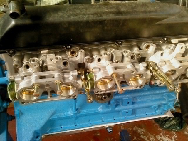

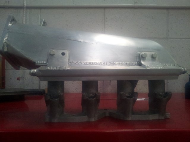

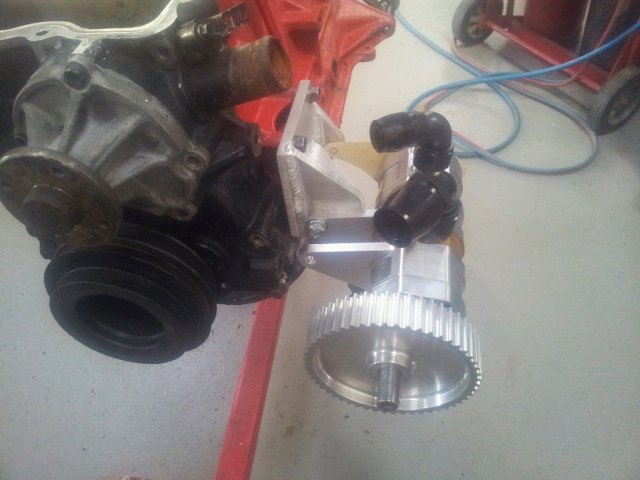

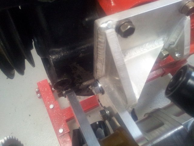

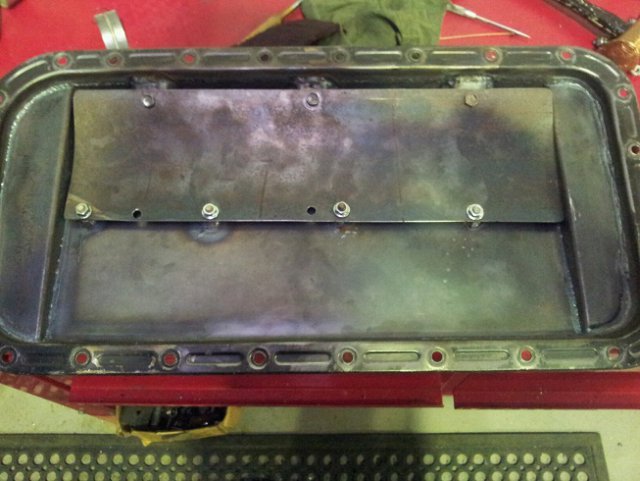

  3. More pics of todays work , made the oil pump bracket and started on the inlet manifold ,

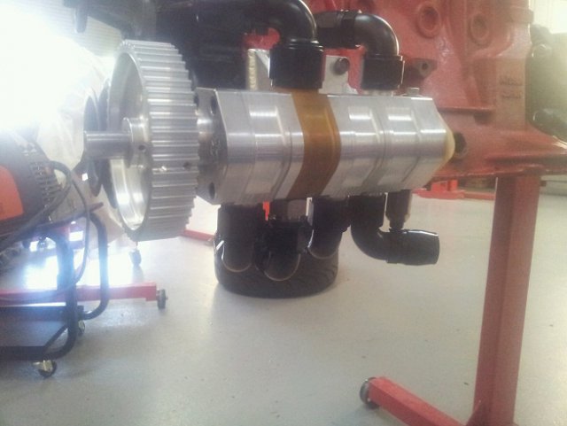

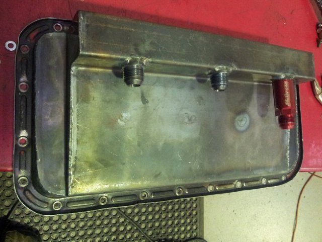

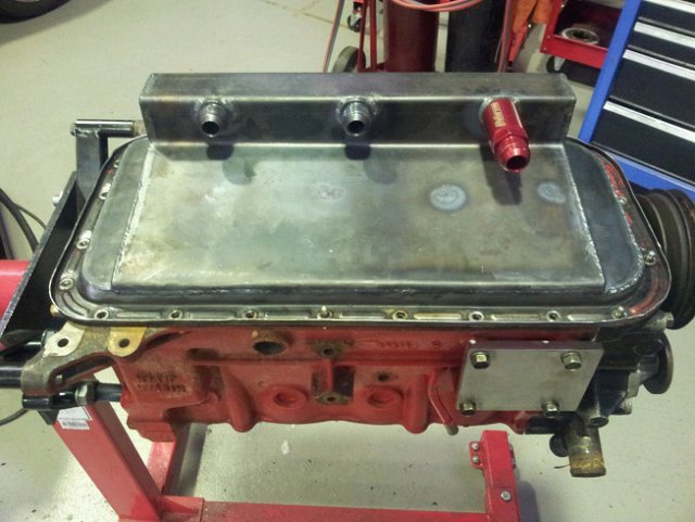

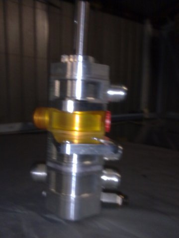

  4. Well im putting the FJ20 back in the zed, but i need to make some parts so though id put some pics up and show the fj20 off. Not to many in the US but there a great motor and i love them this one will make 600hp engine and will run E85 ,i will post pics as i build new parts hope you like the build. first post the new dry sump just finished it, i will have it all cleand up and painted tomorrow

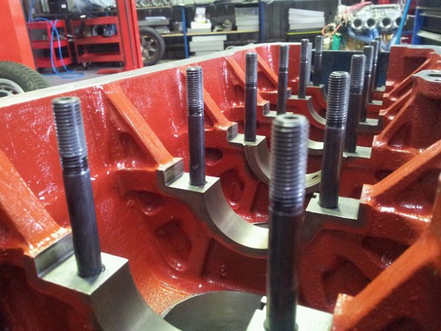

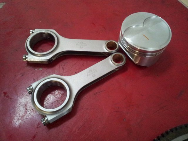

  6. Yep pump gas 98oct power well on my engine dyno i hope to see 350hp my dyno reads very hard , a good L28 race motor on my dyno reads 310hp Parts list the stroker kit is my own i make it from a rb30 crank offset grind to 89mm honda size egle rods 137mm , forged 90 mm piston 1,2 1,2 3mm rings 3cc bump i make a new flywheel to sute n42 block torque plate honed, releaved and painted internal, decked to clean ARP studs main and head 7in race balancer ally sump, turbo oil pump new timing chane and guides, adj timing gear wade cams 310d 600th 106c hsd valve springs and ally retaners head is a p90 that flows 360hp 237cfm at 28in at 600th 46mm valve big port inlet manifold OER style 50mm webers It will be a strong top end power band 4000 to 8000rpm i have made the pipes to suit, will put more pics up soon

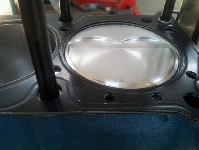

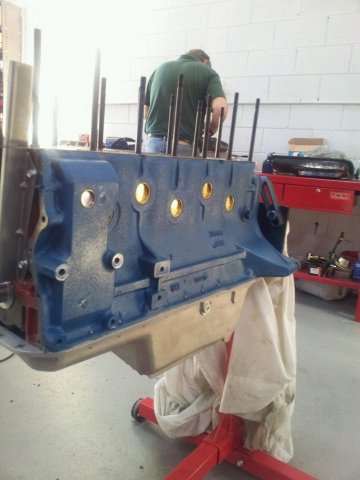

  7. Some pics of the 3.4 stroker ,this one will have a P90 head with 10.9 comp

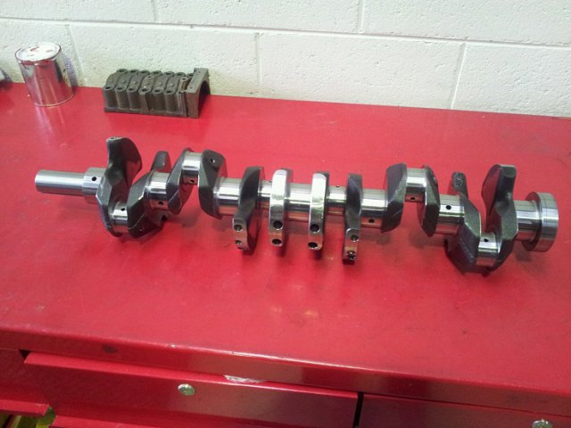

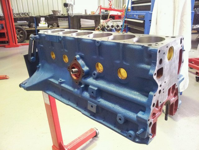

  12. OK i start with a 85mm RB30 crank and i have it offset ground and i use a honda H beam rod thats 137mm long .Then i have the front of the crank welded up , and then grind it the same as a L engine . theres lots more to it but thats what i do . I then make a new flywheel thats in the kit when i sell them ,as the RB is shorter than a L series and i will get more pics up soon ok

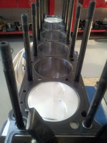

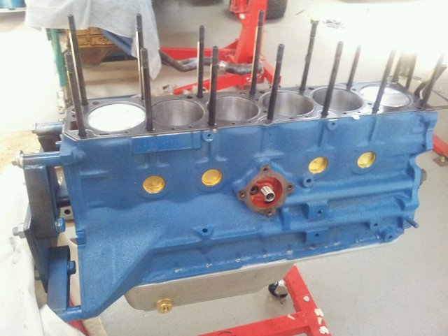

  17. You guys lol. Over the next weeks i will build a stroker 3.35L bottom end 89mm stroke and 89mm bore with a p90 race head and 47mm OER carbs and i will go thro all the steps to show how it goes together, with all the block prep and grinding . And i will go thru all the parts and specs so u can do it over there ,i dont need to sell the 3.35 3.4 its just so you can see what is out there, please lets get on with the car stuff on this thred please ,we are all big boys and can take a bit of sh t now and then lets move on ok thanks pmc

  22. I realy have just made the water system like the RB for ease, and it was the only thing i could do realy ,the cold water will go in to the block and out thru the top hose like the RB .And it will have 3 bleed hoses out of the inlet manifold ,are they needed mmm dont know yet , As for the oil pump i have a ausy pump ,a friend makes them for me its a 4 stage unit . I will have 2 in the sump 1 in the head and i for vac also in the sump

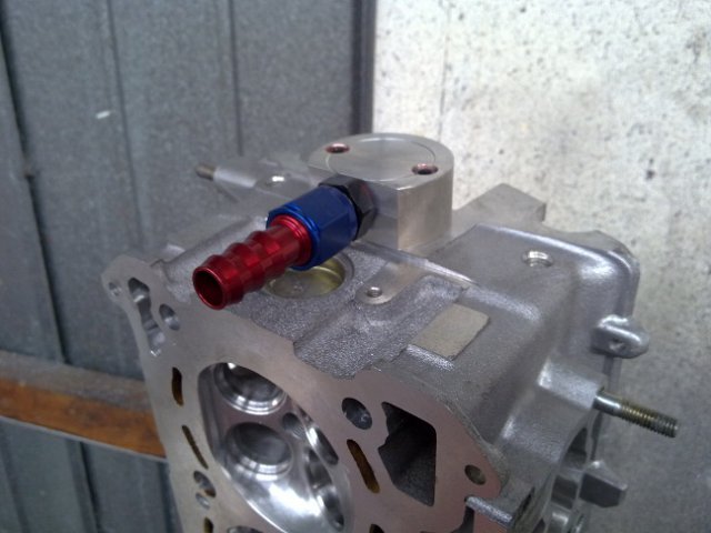

  24. The rear oil reterns have to be welded up as they dont line up .as its drysumped i have used a stage off the pump to remove oil from the rear of the head. By removing the rear plug ,like most RB engines extra oil retern kits. The water pump was the more of a chalange , well not the pump the water in to the block as the Lsearies pump wont work as there is no frunt cover ,so i have removed the welsh plugs from left hand side of the motor ,and made a cooling chanel that feeds the hole side of the block ,and used a electric water pump to feed it .i will take some pics of it to day.
