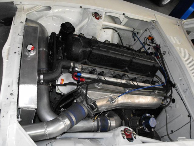

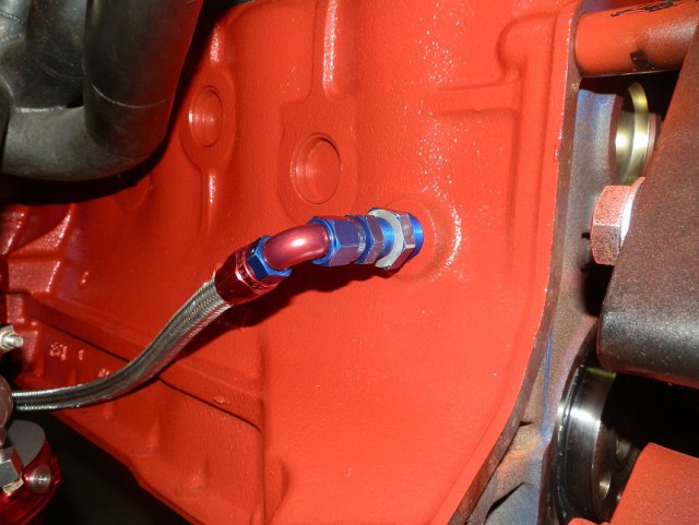

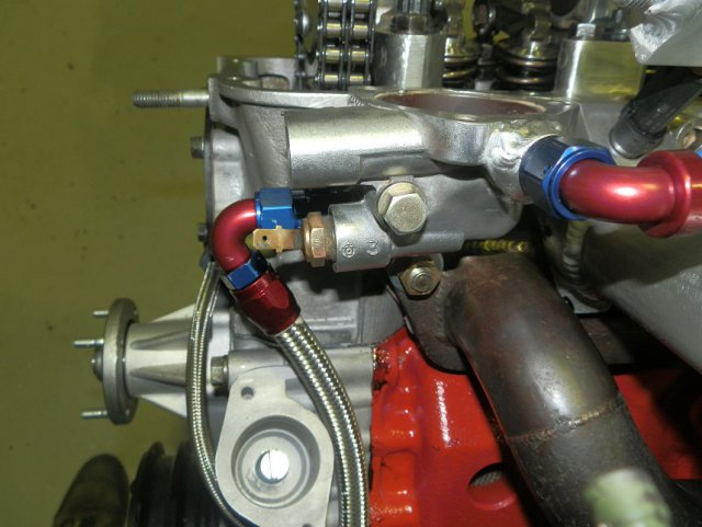

  4. Better to feed the turbo cool water from the block and then feed it back under the thermostat ,

  6. Well , was it a street engine hell no lol it was angry and ran on E85 fuel boost was 25psi with a 66 to4 garret and was crasy to drive in a light zed engine spec was 88mm bore f54 block rb30 stroker crank 89mm rods were honda, piston was flat top forged custom , head was p90 with 46mm valves inlet standard size exhaust with race ports with 230cfm intake 155cfm ex , inlet was a custom made by me, so was the exhaust , cam was a 280d 500 lift 112 centerline , motec ecu with ls1 coils one of my disys , was a fun thing but very hard to drive fast for long races ,

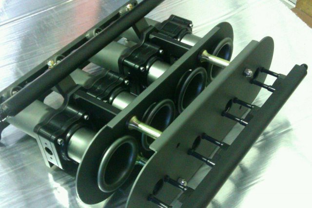

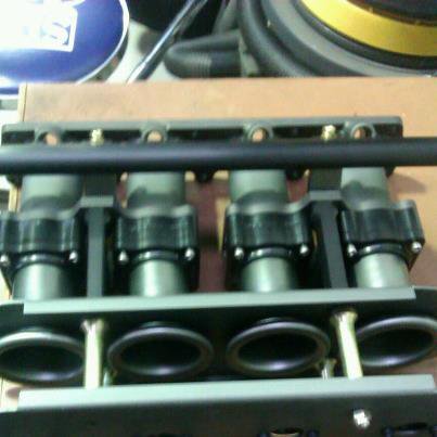

  16. We do have them for that head and the 50mm itb flow more than the head will and there is no power to be had from the bigger bore , infact we tried some when we made this set and lost so much torque under 6500rpm , we found the 48mm set would make the same hp in 2L form as the 50mm up to 8500, and made more than the 55mm set as well . the 50mm set made power to 10000rpm in the LKA 2L . pmc
  17. Yes not cheep to make but works so well the L 2.3 made 300hp at 7500 ,, and we are making a L28 manifold as well,so the stroker gets some good air lol
  18. For the crasy people that like the Lka conversion 50mm itbs hi low inj
  19. And there fricken cooooool , and they make more hp than NA RBs and sound horn at 8000rpm

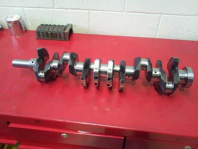

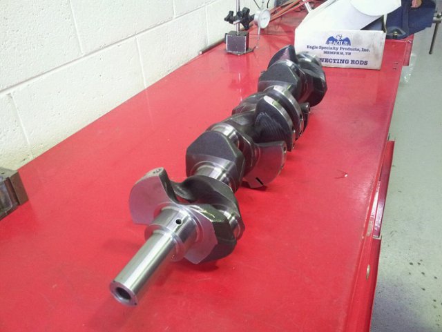

  20. Hears our RB stroker crank for the L 28, stroke is 89mm with a 89 bore its a 3.322 . 3.4 with a 90 mm bore and is a gem to drive . We also do a 96mm stroker
