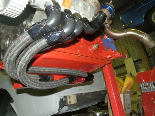

  3. made the oil lines tonight getting close now

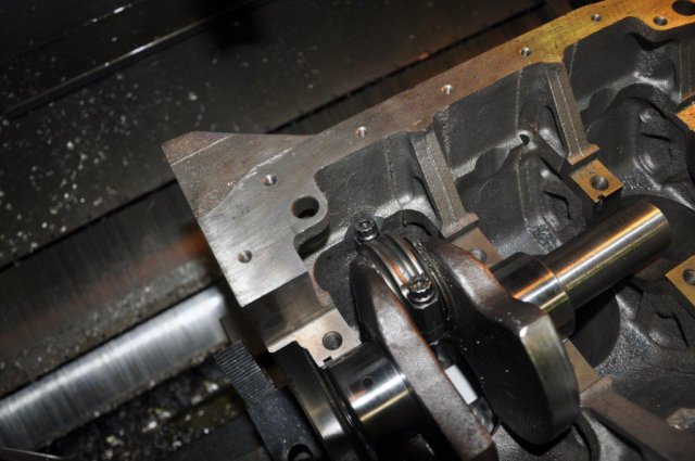

  10. Hi all this one is L18 BUT ITS 2.3L with a KA24 head We make the crank and crank gear , the tenchener is a L28 type that we feed oil to the slack side is SR 20 , we drill and tap the block to fit it, there is lots of work in there ... This engine makes 300hp on the engine dyno and we now make a 2.6L from a z24 block that is a real torque monster

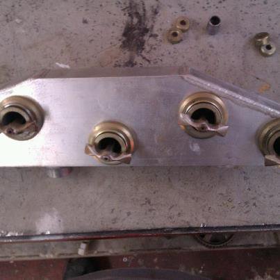

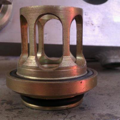

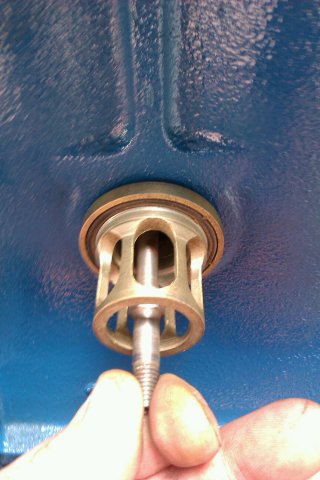

  12. No there not thermostats , the water passes thro them in to the block thro the core plug holes on the manifold side i remove the core plugs and fit it in there place , so the hole block gets cool water , there is no factry water pump now its blocked off. i will post more pics and show how it all works soon .
  13. Im testing it both ways Tony at the moment the water is going in the block , but next week i will be reverse flowing the water so in the head and out the block, i think it will work even better that way . I will be making it a one peace ally thing when it all works.

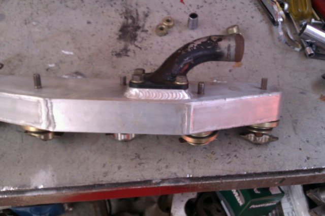

  14. Hi this problem has had me flat out for weeks and i have nearly got it sorted i have made some new parts up to feed the block along the hole side of the block to get cool water along the back cylinders along with head mods i have got the egt equel on all cylinders and will soon have it ready for race testing . hear are some pics. And i can not take the credit for the idear the bloke that did this 20years ago never finnished it i just found it and thought wowo that might work The idear is to run a electric water pump in to the side of the block and then remove the water out of the head like a FIA head , so far its working very well , in testing i have been able to get my 3.3 stroker to run flat out for long full lode tests with stable 180f temps ,motor is making 360hp engine on pump fuel 36deg of timing at 11.comp .

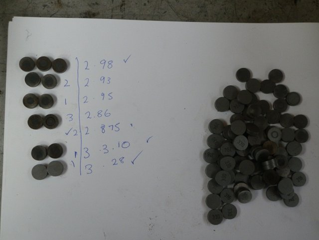

  23. Haha i have to do 3 a week its a pain in the bottom lol , 1 thing i will tell you about getting it right is you should use 2 sets of feeler gages 1 on each side of the bucket,, or you wont get a good reading , in the nissan manual it says to do it this way ,but most dont and never get it right , The bucket rockes and moves the shim with 1 feeler gage ,with two it make the shim sit flat on the valve and gives the right reading . have fun lol
