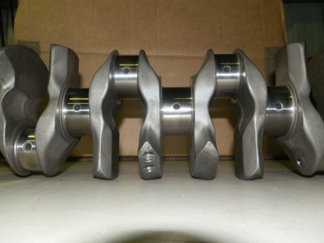

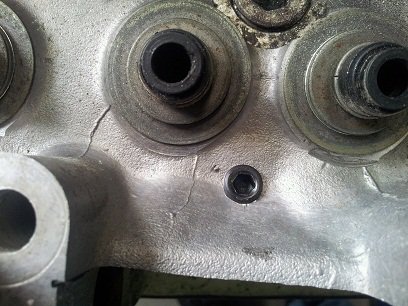

Well just finished the crank. It needed lots of work as i found a crack in it, so i welded it up and spent some time making it race ready come up a treat , also found a crack in the head ... So i replaced it and ported it the same as the old head as it had made great hp before , there is a lot of work to go but its getting there

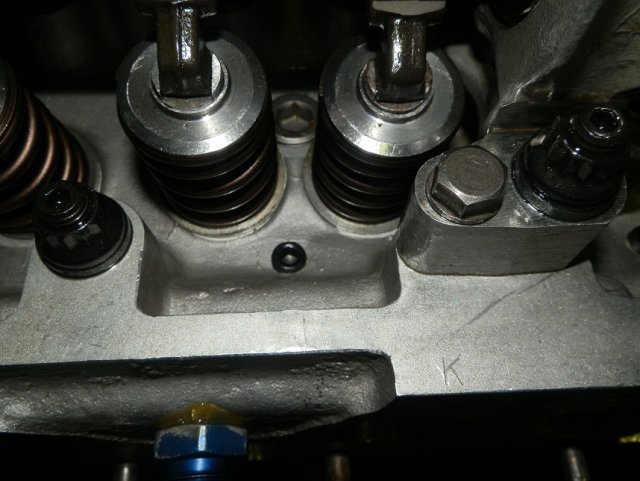

It was all the rage to fit the hose of the back , and it wont hurt i still fit them some times, there is way to much oil up there But its a easy fix to the head only takes 2 min with a drill and the oil problem is no more , The oil drains at the rear on the block can do with some love as well ,the casting is very ruff ...

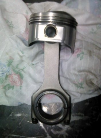

Over the Last 25 years i have built many L28 motors with diffrent rod lenth from 130 133 137 140 mm and my normal combo i run 140mm fj20 rods and a custom piston ,, is it better than other combos ,im not so shore if its better but it makes good hp and it revs very nice . I seen this combo many years ago in GTU cars and its been good to me . One time i built a motor to find out if the rods made a difrance and i set it up with L28 rods and pistons to set a bench mark , then we put 133mm l24 rods in with custom pistons .. gess whot no change . with in 3hp and no real gains ,to keep it fair i used the same rings on the pistons . Then i went to 140mm custom rods and a 28mm comp hight piston , the test was not so fair as the last test piston and rod were much lighter , and power and torque were better not by much only very small amounts ... Its the exhaust that makes or breaks a good engine at 8000 . And port volume. The rod has little afect over it ,,, But a nice piston thats short and light will make more power ... -

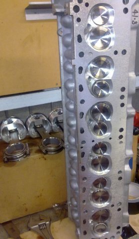

WELL i think your wrong thinking that 5500 is lots Simon . if you wont top work done it cost money and it takes so much time to set a race head up ,, i work hard to make the best heads and motors in australia . Theres a old saying you get what you pay for , and i only work for people that wont the best and i work dam hard to keep them happy . yer there are people that think its a lot but there not asking for a race head , sorry for the rant pmc some pics of a hand ported e88 rally motor that made 300hp with 10.8 comp
Well thats a good one what type and spec do you wont , race, streat drag with all water mods i need more info to help you , a all out race head with 360hp flow with cam and springs big valves and all the good stuff is $ 5500 with flow sheets ready to bolt on

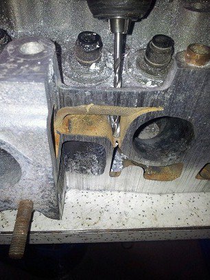

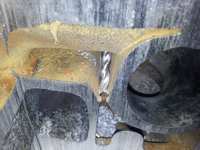

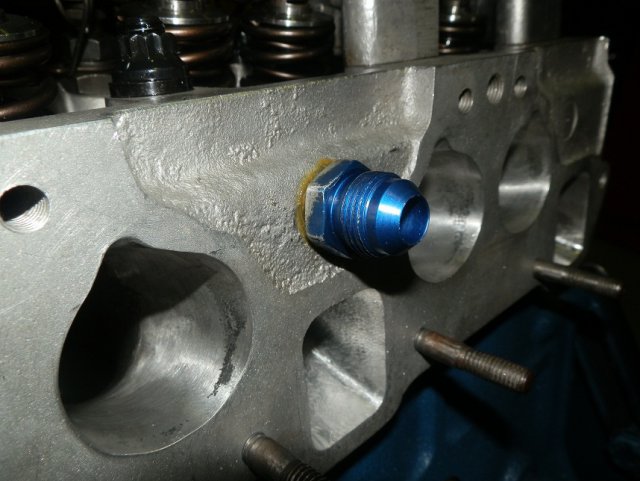

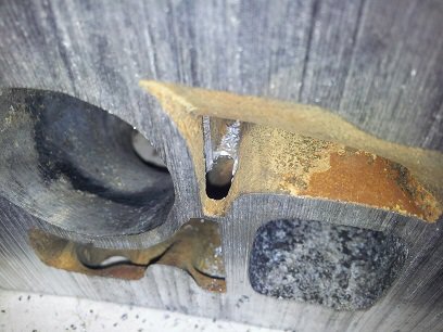

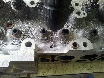

Sorry for the lack of detale i have been mad bissy at work, over the next days i will take some more pics and do some sort of plan for people that wont to do this mod at home . Doing this with the drill i was able to remove the bridge ,all of it on all ports , and it was done in 1hour , so its a very easy mod .
I did all the ports with this methed i did a dummy run with the cut up head then did the good head of the motor ,, YES tony i did try to do it thru the plugs that were there but could not get the hole bridge removed and as is did all ports i needed a new hole and new fix .i know this has been done before but iv tryed to get more out and this is just a difrent angle at the fix thanks peter mc
I ran a stock 3.7 welded diff and shafts , for 3 years and ran 10.00 more times than i can remember with over 500 hpatw and lots lb torque ,, dont know how many tail shafts i smashed , but the diff and shafts never gave me any truble

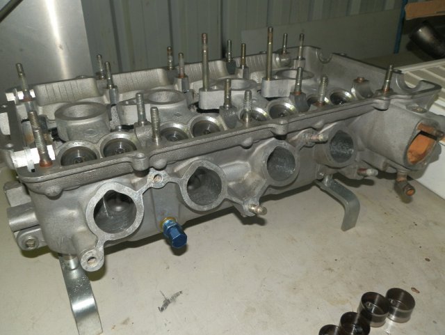

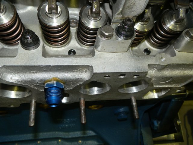

When on the dyno the other day , i found no5cylinder was not the same temp as the rest so i got to thinking, how do i fix this not just mask the problem . i know there is a thred with 24 pages off help but i need to realy fix this, not just do things that help so i cut up a p90 to get a good look for my self and found a fix, and hear are some pics So back on the dyno what happend , more power and more timing and all plugs look the same , and the engine was crisp
