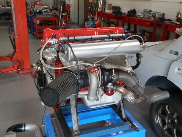

  5. That is the hotest spot in the engine bay not a good spot for a air cleaner at all . I had to fit heat shelds there to stop the paint coming off ,

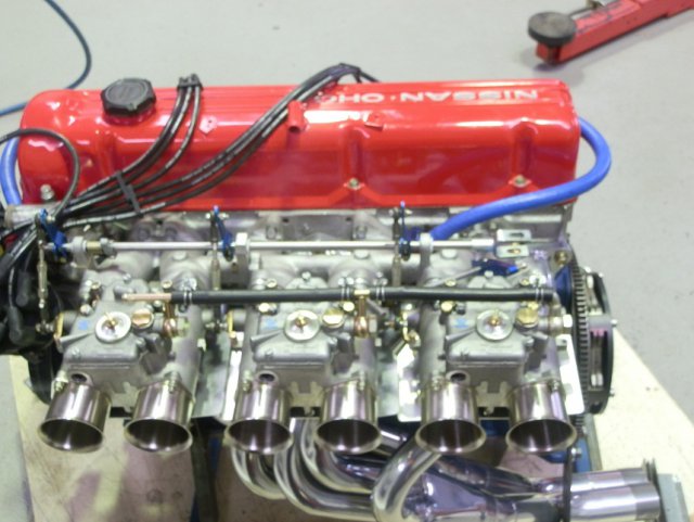

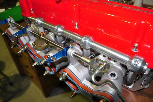

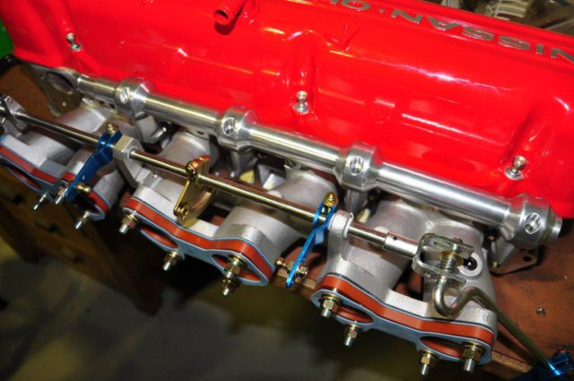

  6. More pics . Dam there is some work in theses engine builds ,

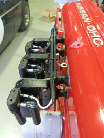

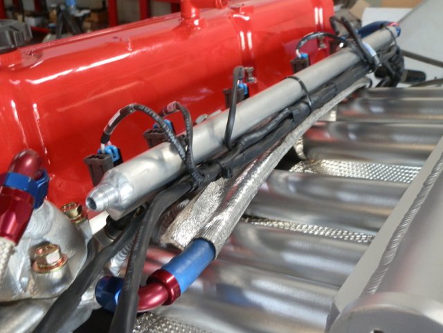

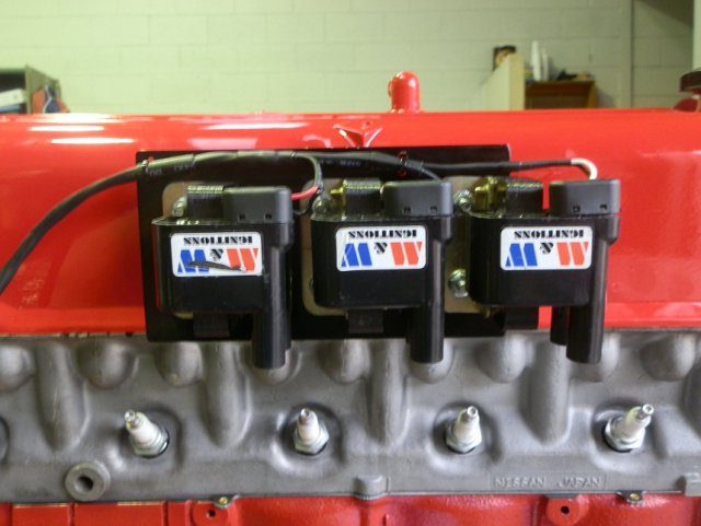

  7. The coils are mounted on rubber soft mounts as per instructions from autronic the ECU maker , also it made it very easy to mount on the rocker cover ,

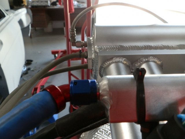

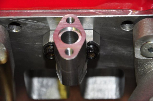

  8. It was before we did the new water setup so its got the internal water mods and rear water hose .

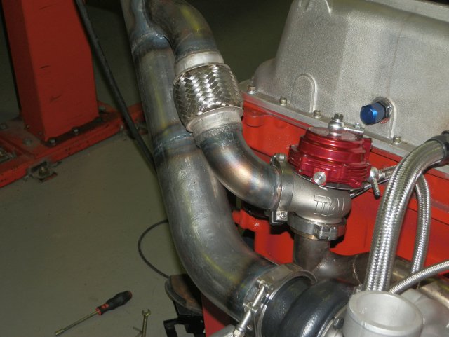

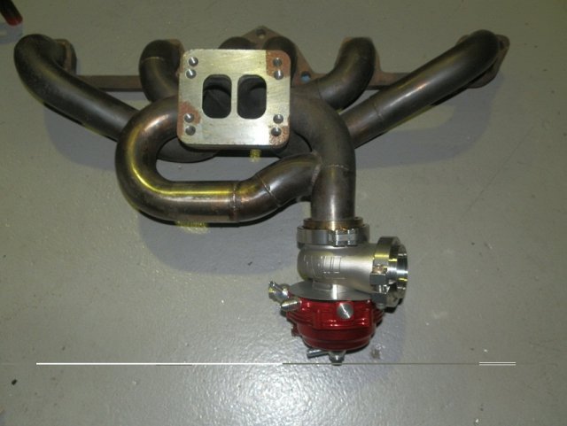

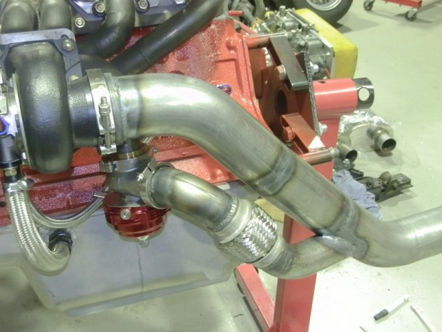

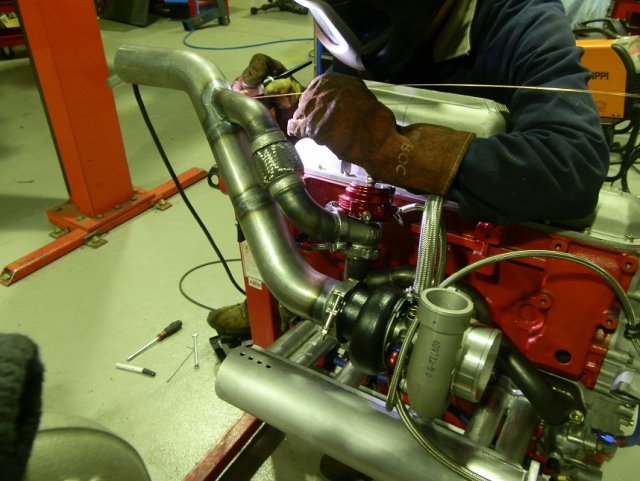

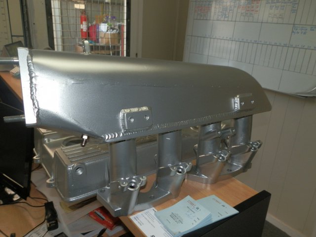

  10. Just thought id post some pics of a turbo im doing L28t

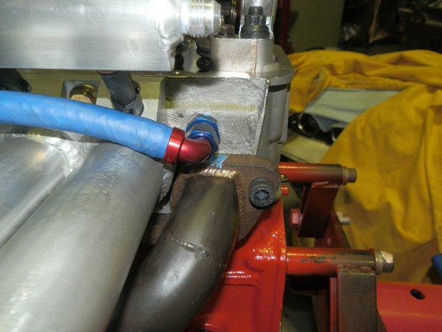

  12. there both water ways the oil is on the other side.

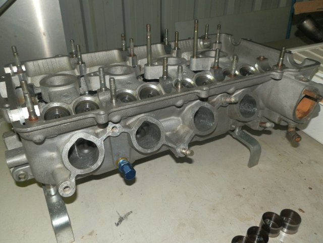

  18. NO there all the same size , as for selling them id have to do the hole head as there is lots of welding and other work ,the hole side of the head is flat. And i drilled all the flashing between the ports, theres lots of work in it but it works we are well over 370hp now at 6000 , this engine also has new valve position canted and moved 2mm away from the bore , she ant no normal p90 hahah
  19. Some pics of the stroker crank (96)mm and my new water system , more pics of the build soon taking the L to new places
