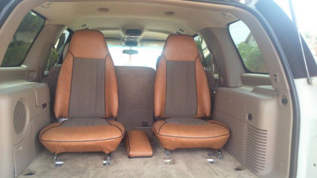

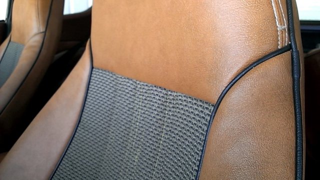

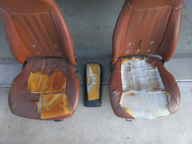

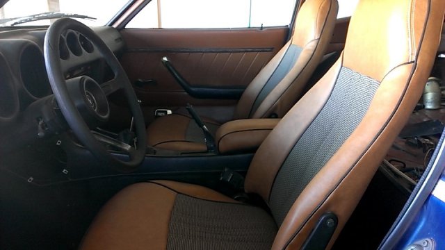

Here's the last picture I took before putting it back in my garage. Not really put back together but tons of progress was made in the last year. The engine feels pretty good, huge portions of the metal have been fixed, seats reupholstered, nice fbody fuel tank properly installed, internal racetronix fuel pump running beautifully, carpet kit cut, door interior all there except the driver door panel not being installed. Excited to get back at the end of the school year (I'm teaching Music at a high school here in Washington) -

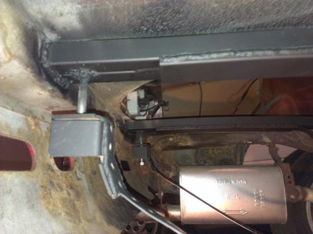

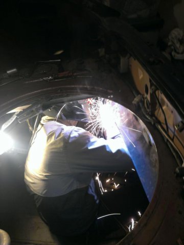

Couple more randoms of the full rockers in the middle of alignment, some rust, a couple of welding shots, and the passenger door rust I'll have to patch. -

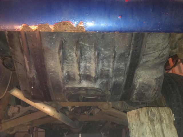

Pictures as promised. Wasn't done with a regular mig, no gas, so the welds still need some more grinding down and cleaning up, but I sprayed it with a thin coat of black primer for now while I get a chance to clean them up more down the road when I'm actually prepping for paint. Note I have way more pictures of rust but for the sake of comparisons and seeing a few in between shots this is all I'll upload. Cut up Passenger side Driver side -
Rocker panels and other bits have been done for almost two weeks now, just haven't had a chance to upload pictures. I'll have them uploaded sometime tonight once I've sorted through them for before/after deals. Still have some more bits to weld including some floor patching and the frame rails, plus the holes from the old bumpers in the back but for now it's really coming along and starting to take shape. It's far from any sort of ground up restoration but a lot of major issues will be taken care of. The passenger door aligns quite well and closes, but the driver side door (unfortunately) closes just as poorly as before and I haven't quite figured out why. It's no different from before swapping the rockers, so I know it's not that, but it's still bugging me that it's harder to close and almost needs to be slammed to shut completely. -

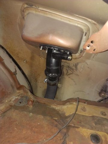

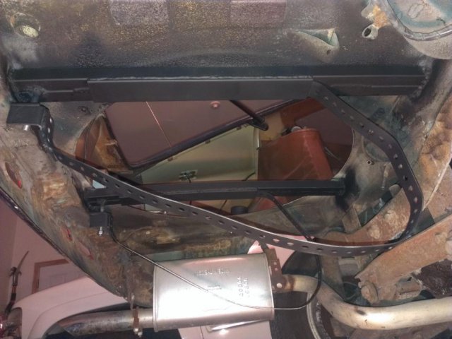

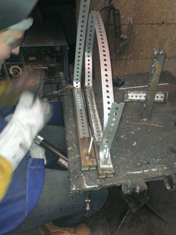

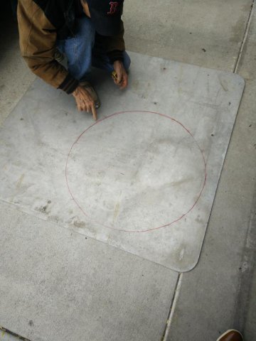

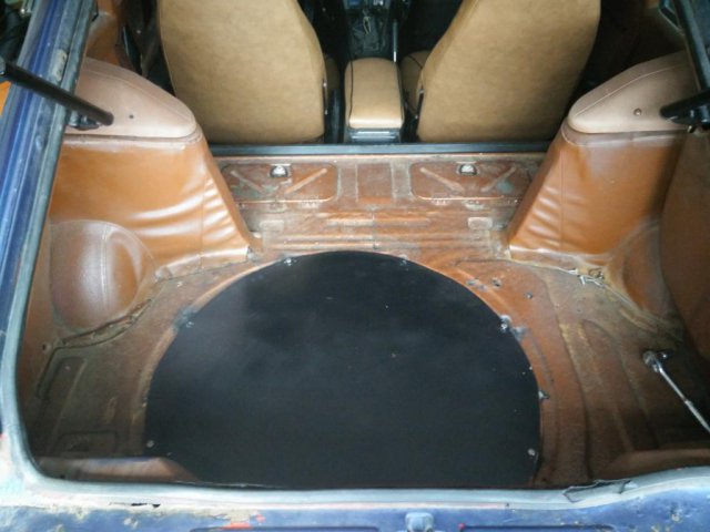

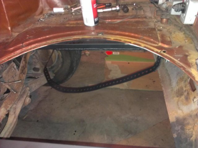

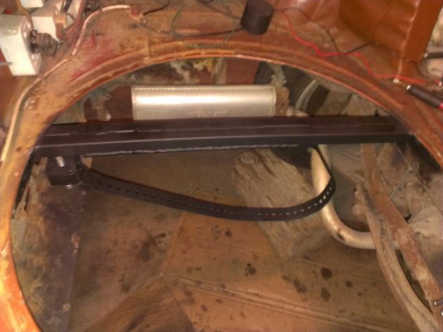

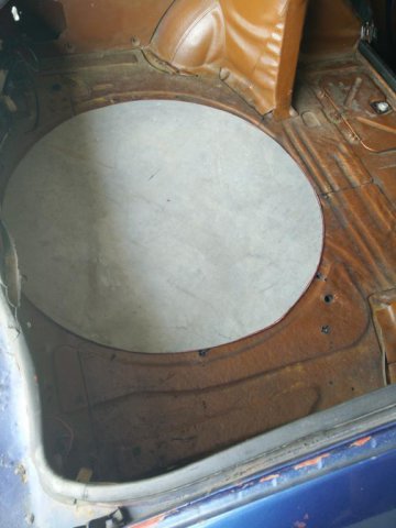

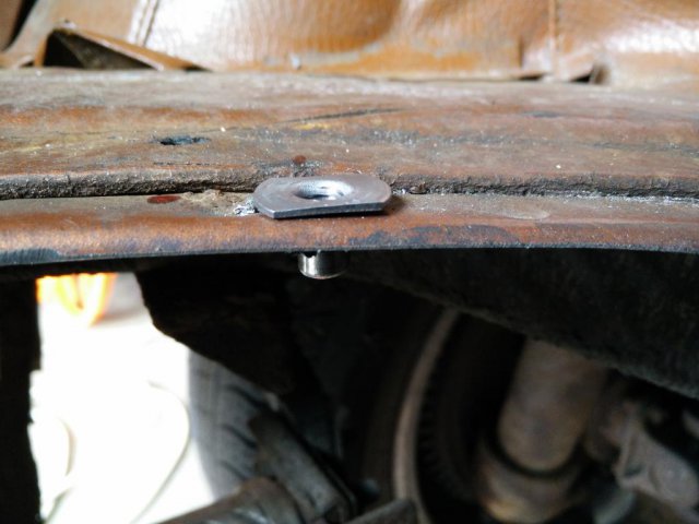

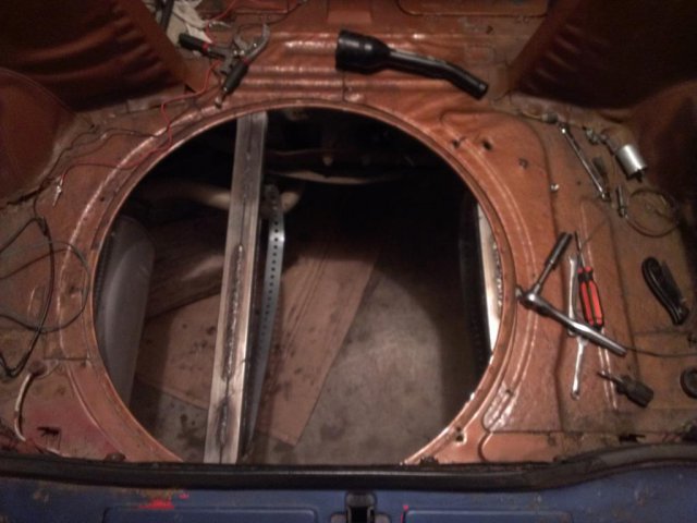

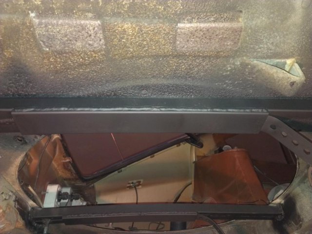

Haven't been posting much lately. Been trying to apply for full time jobs and I was in Oregon for a few days just recently checking out a job offer. Finally made a cover for the tank. Made from aluminum my dad got at the scrapyard. It's bolted around the sides so I can access anything I want on the tank or the rear end down the road. Welded the fancy little things you see around the circle so I could bolt the plate down. It works well enough for now Dad cutting the cover and a mockup Fancy schtuff Gives you an idea of placement pre-welded Aaaand, painted and bolted on (mostly, you get the idea) It's not perfect but it'll do for now. -

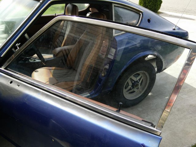

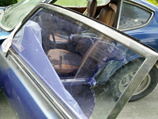

Been raining a lot here the last few days. Haven't done too much last weekend, but earlier I got the chance to clean up the glass, particularly the nasty tint that was left on the driver side window. Took a couple hours of scraping even after using a window film adhesive remover. Before (note that this is just a couple minutes after I had started. don't have a true "before" pic): After: -

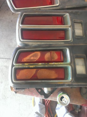

Frankenstein lives: Obviously I haven't put everything back on yet. Threw the taillights back on super fast just so i didn't feel too ratty, but she moves! Still finishing the back piece for carpet. Not sure if I'll have that totally done tonight, but pics will come as soon as it's done and I've thrown them on for a test fit. -
Didn't get a chance to get some pics or video of the car moving today because we've been getting some pretty good rain. I'll get something once it's sunny again. In the meantime I started cutting up the carpet that I bought over a year ago. It's all laid out and ready to go. center piece at the rear of the console was finished earlier. I'll have pics up in the morning when I finish the rest. -

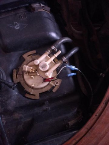

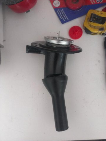

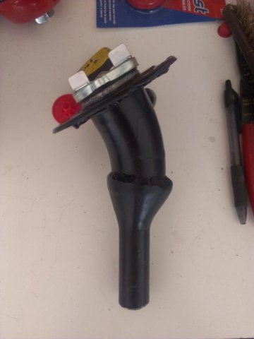

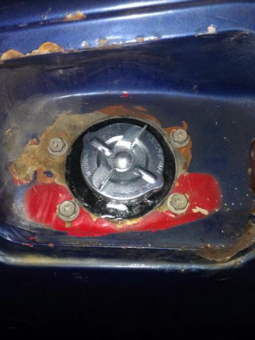

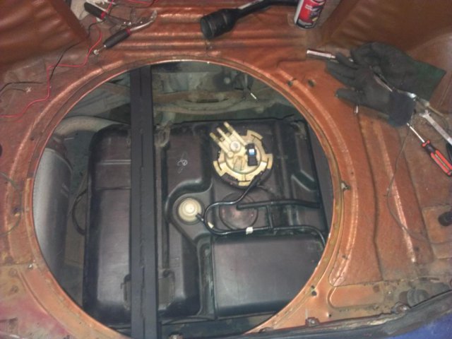

Used some test leads yesterday to check the Racetronix pump that came in the Camaro tank. It's working beautifully, the guy that last did the job did a terrible splicing job. I'm redoing wiring later today and seeing if the stock connectors on the pump assy aren't busted as well. If not, I removed the evap sensor and ran the wires through the hole. I'll do some more custom stuff to make that work with some quick disconnect cables. It's satisfying knowing that pump is working though, shouldn't have any pump issues for a long time even with an engine swap. Will update post with my final wiring when I get to it later tonight. Update: Pins on the pump assembly were busted or at least bent enough that the original connection wasn't making proper contact. Fed the wires through the hole where the evap pressure sensor used to be (since I can't use it anyway), and respliced them to some quick disconnect ends. Cut the hoses down to a more appropriate size too now that I know I'm using the internal pump and put the interior trim back over the filler. Looks much more complete than before, just need to make a cover for the spare wheel hole. With that, the fuel delivery is pretty much done. Will be wiring the sending unit next before I put the cover on. Won't be accurate until down the road when I get new gauges, but this will work for now.
