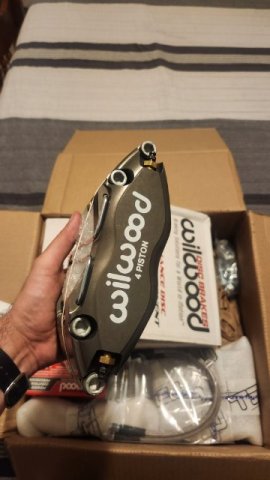

Got the front wildwood brakes installed today! A couple small quirks along the way on my install: First side I installed the rotor on the adapter ring to the hub wrong and the caliper didn't line up. It has two separate mating surfaces, one for a 240z and one for the later 280z hubs. Since I've replaced my 280z hubs with the T3 hubs, I failed to realize they're essentially a universal hub for early and late models which is why they had an extra shim ring of about 10mm to account for where the 280z mounting surface is. I took the ring off, so technically I had to install them where the 240z ones are, unless I wanted to run my rotor ring AND the hub spacer shim that they came with. Avoiding too many unnecessary pieces so I redid that side to mount on the 240z mating surface of the adapter and we were fine. Problem 2 - because I ordered the 280z brake kit, the included hardware also assumes you're still using stock 280z hubs. It's on and worked on my short drive, but I noticed in the picture where they're installed that the bolts don't go all the way out to the mating surface for the wheels. Quite a few threads left unengaged. It's probably safe for the time being, since I thought about the forces on those specific bolts and it's not really in or out since they're perpendicular to the rotational force applied by the brakes. I also didn't feel like I had particularly few threads engaged as I was bolting the rotor to the hub. Probably safe for casual driving, but it's a high priority fix right now to get the correct length bolts from T3 or locally. Better safe than sorry! Other than that I'm really happy. Bled the system with my new Motul brake fluid, which should cope much better with the heat off the turbo vs the cheap generic O'Reilly fluid I had before. -

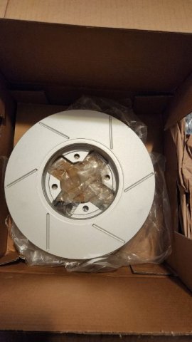

Three weeks until I'm home and properly working on the car before a long road trip. I've been creating a detailed list on some Google notes of everything I hope to accomplish. I'll update once I truly get to it, but for now just wanted to share my excitement for my new brakes. Was in Utah about two weeks ago for a handful of days for a music conference and my brother was kind enough to let me borrow his truck to drive up to Logan just for one evening to have a quick dinner with the siblings up there and I took a quick trip to my folks' place late in the evening and opened up some of the parts to keep my motivation haha. Also had a big box of new seals from Resurrected Classics. They were kind enough to give me a steep discount on their weatherstripping kit when I asked if I could get it without the door seals since I had already purchased the S30 world seals before they released their kit. Looks like they were kind enough to give me the discount and kept the door seals anyway! I'll be making a thorough comparison of it against the Precision kit I have, mostly to see if it's truly far better for some of the worst fitting parts. -
