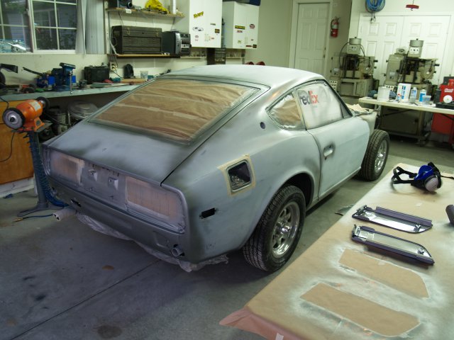

You will have a line show through between those two areas because the feathers are too short. I would rewipe about 6' past the two spots and join them. Just a thin final wipe and use a block about 24" long so it will straddle them. You should be using 220 grit now. Stay off the body line untill the very last. You are sanding a compound curve. The body line should be from the door and daylights out over the wheel arch and reappears to the end. Compare it to the other side. If that is rattle can primer you need to take it off or your base coat might lift. If you are going to have a pro shoot it ask them about it now. Some prefer to do the primer sealer themselves. If he says rattle can is okay then take it to someone else.
I sold my L28ET. Now I have my Q45 up on stands to pull the engine trans and diff to put in my '70 240Z. I'm having trouble finding time right now but it's a start.
I would remove it because of the delayed shrinkage. Build it up in thin layers. When you sand, straddle the spot with the 24" flexible block. You can get them from ebay or Eastwood. After you get it close as you can paint it with high build primer and block the whole car the same way. You will find spots that need more work. If you don't spend the time you will have a paint job that will make you want to sell it. Patience, I spent months doing mine. I didn't have any experience but I do now and I'm not afraid to do it again. Buy the right tools!
A line sander is too ridgid. You have created flat spots that will show through the paint. The "feathers" should be 10 times longer and also the bondo feathers into the evercoat making the flat spots. You can rewipe the area way beyond what you have and use a 24" polyurethane board sanding diagonally accross the area in an X pattern. If you paint over that you will be disappointed. Cheap fillers continue to shrink.
The only problem I see with that is the glass filler is harder and will resist the sanding slightly more than the Evercoat causing an uneven surface. As long as you don't sand through the Evercoat you'll be okay. If you covered over any rust then you did waste your time.

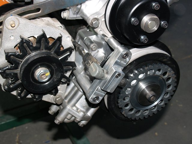

AC yes ps no. I made this for my S30. We have to muscle our cars around but AC is a must. A larger diameter code wheel and different adaptor hub might allow for the ps pulley. I spaced it out away from the damper to avoid any possible feedback. In fact the stock fan won't quite clear. James said he will be using electric fans.

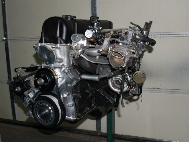

It's just a mock up. Actually I sold the engine to a guy in CA. He is putting it in a nice '73 with MS so I imagine we will be hearing from him.
I'm glad you like it. Feel free to copy it but don't ask me for dimensions, I might make more of them since I just sold the complete engine today.
