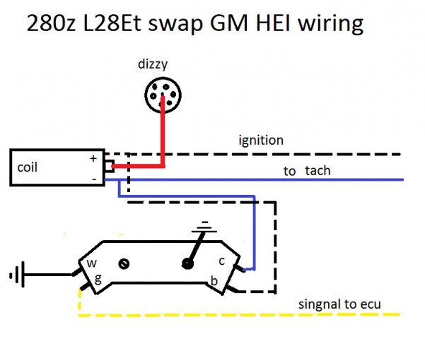

I'm about to the the GM HEI mod on my L28ET powered 78 280Z. I've gone over lots of schematics and wiring diagrams and think I have it right. Does this look correct to you guys? Thanks! Rick

Like so??>?
