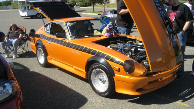

  2. theres a lot you can do leave the fuel injection alone ,a mild cam advance cam timing to the 4 degree mark and it will have a good low end punch and autocross well.these are mine,the orange one is turbo charged on the factory computer and wiring harness
