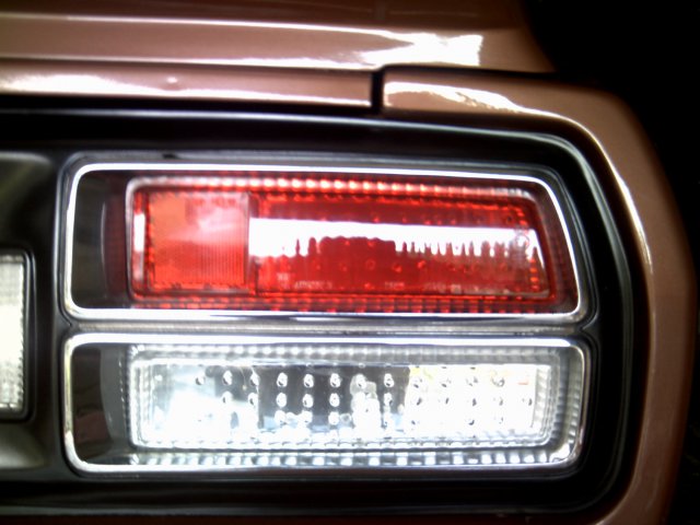

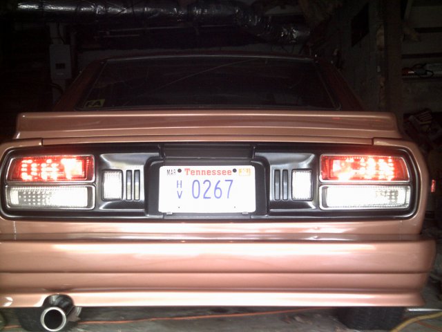

Well the lights are pretty much finished and here is the link to watch the video of the signal light. There is still an issue with the flasher affecting the voltage supply to my circuit which causes the LED intensity to change. The pictures and video are not the best quality and so they look better in person then in the pictures and the brightness of them prevents me from getting a head on shot, overall I am satisfied with how they look and just need to fix the flasher issue.

For the brake/running lights I am using 2.1 volt @ 20ma that is 13,000 mcd. The back up light is 3.2 volt, 23,000mcd @ 20ma. The driver for the signal light is going to be a LM3914 dot/bar display driver circuit running in dot mode with a RC charge and discharge triger.
Here are some more pics of the stop/running light without the covers on because I am waiting on Klearz to modify my existing one to be transparent. The running light will be LEDs spelling out DAT on the Left and SUN on the right. The brake light will be all of them lit up. I wonder if you can get a ticket for the running lights being too brite. If so I might be in trouble, hopefully the cover will dim them down a bit. Oh yeah there is also one of the back up light with LEDs and the cover on. It is a world of difference from the old light.
