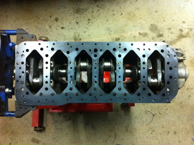

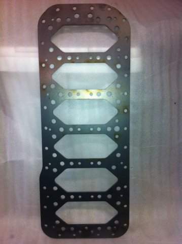

  11. These were once sold here in Australia and sent overseas, before I could reach the pedals of a car. The only reason they became unavailable is personal reasons for the original designer/manufacturer, a family friend of mine. He used to be a well respected racer and engineer, who still holds lap records to this day. While having a garage clean out, he passed on to me the design for me to use and manufacture once more. He shall remain nameless, as a mark of respect. Life takes you to funny places and he is no longer interested in cars. Now, his experience was that he DID get benefits from the use of a girdle. He claimed it gave better rigidity in the block and crank, aswell as acting as a bit of a windage tray. Also said that it moved the harmonic vibration further up the rev range, which also changed the sound of the engine. He was a smart cookie and never did something unless there was a reason. After modelling the design on CAD, I have started making small batch runs made from high tensile 6mm steel plate. If there is enough interest, I can make more. Spacers are required to bolt through to the mains caps, ARP studs or even Unbrako socket head cap screws with hardened washers have been used. You can see there is provision to drill and tap into the webbing of the block, using countersunk screws. Or if you are using a sump like Arizona Z car's, just bolting that through should suffice. You can use a modern sealer like threebond instaed of gaskets. That's about it. The way I see it, I have spent thousands on parts to make my car go faster, it is a bit of insurance to "look after" my investment! What are peoples experiences and thoughts?
  12. The gentleman who designed and made these years ago was a clever man who raced these with great success and reliability! The issue is not just block flex and reinforcing the rear mains, but also crank flex/whip and harmonics. Then there is the builder who is for these locally, he himself is no dummy. Working with Gibson motorsport here in Australia back in the day, still in the performance tuning industry 20+ years. For me the price of the girdle, compared to the price of a complete performance engine, is negligible. I see it as extra insurance as we all cannot afford a rebuild after events!
