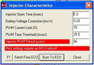

do I need to use the resistor pack for my injectors?
ZXT_bean replied to ZXT_bean's topic in MegaSquirt
im not having any reset issues.. just cant get it to idle properly with out popping and back firing.. here is a thread that will tell you my entire setup, along with screen shots and everything. msq, its all in there.. I know the new 3.57 ecu can run the low imp. inj, am I better off using the PWM or the resistor pack? http://forums.hybridz.org/showthread.php?t=152497 -
As many of you know, Ive been trying to trouble shoot my install for quite some time now. I made the decision to rewire the megasquirt again to make sure all the connections where good, and I had everything wired correctly. I am using the stock turbo 270cc inj, also am using the new ms2 v3.57 ecu. My question is do I need to use the dropping resistors? I cant for the life of me get this car to idle properly, and thus can not further tune the car. Any and all help is greatly appreciated. Thanks again

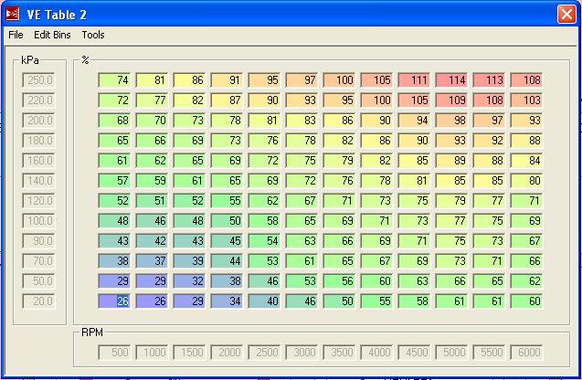

softopz, I figgured out that i could open the file using winzip.. so I loaded up your tune. does your car run on this tune? I still seem to be getting way to much fuel. Id like to share a log with everyone, but im not sure how much it will help at the moment. -

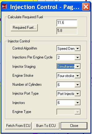

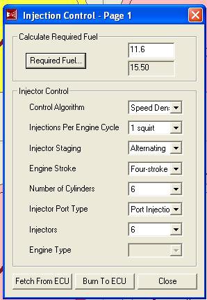

well it turns out I dont get a tach signal if I have the J1 jumped on pins 3 & 4. I do how ever get a signal if I put the jumper on pins 1 & 2. Now that it seems like I have all the jumper and such in place, It still wont fire over. It will sit and crank all day. Now ive gone through all of my ignition setting, they all seem to be correct. All my jumpers seem to be in the correct locations. Is there something horribly wrong with the tune im trying to use? Do I still have a major setting wrong some where? Ive changed the injector controls so that It will simultanously inject 2 squirts. here is a screen shot, and another copy of the tune. profunctionprep1.zip -

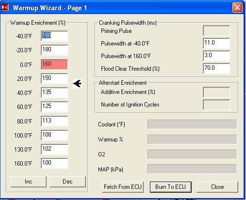

i did a compression check when i purchased the parts car, it was about 125-133 across the board. not sure if thats low, but they were all in the same area. as for mods on the board, I havent done any. I have v3.57 board. so its all jumper shunts. I beleve I have them all in the right places. fuel pressure is in the high 40's. Ive had the car running. but now that ive tried to make this new tune, I cant seem to get it to fire. -

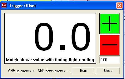

this according to the individual coil tests confirms my firing order. cyl 1&6 are paired to pin #10/coil A cyl 2&5 are paired to pin #12/coil C cyl 3&4 are paired to pin #11/coil B which confirms the A_C_B firing order. For my coil, that diag above is correct. Now that I have all my timing and firing order sorted out. The car still is a no start. I know its getting fuel, and obviously spark. I know my trigger wheel is clocked correctly, 6 teeth counter clockwise. What would be keeping it from firing? am I not giving it enough fuel? To much? All of my tunes screen shots are in the first post, any and all help is greatly appreciated! -

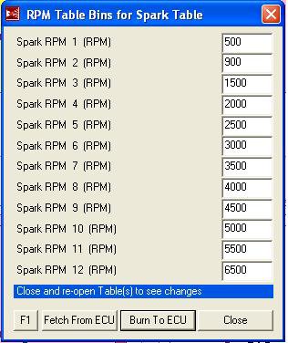

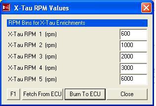

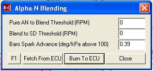

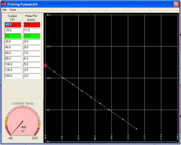

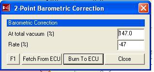

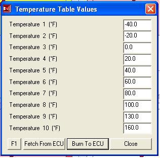

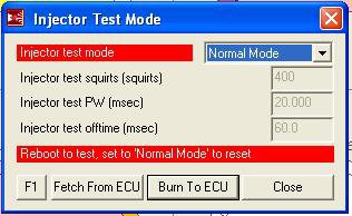

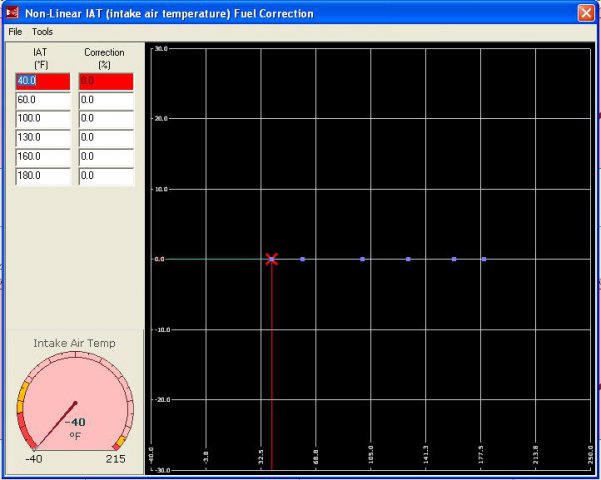

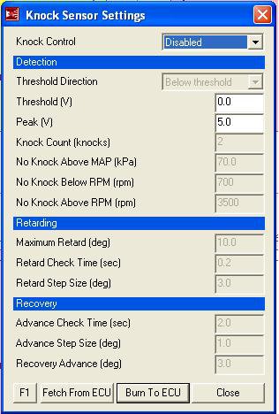

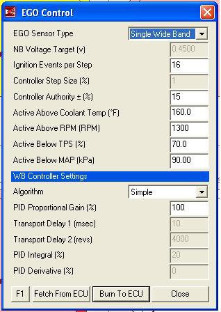

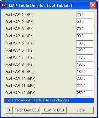

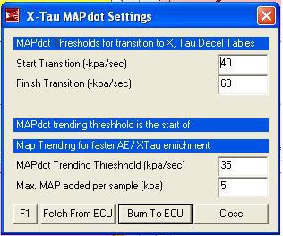

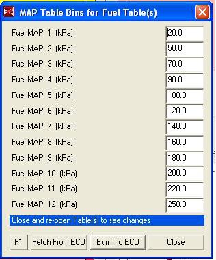

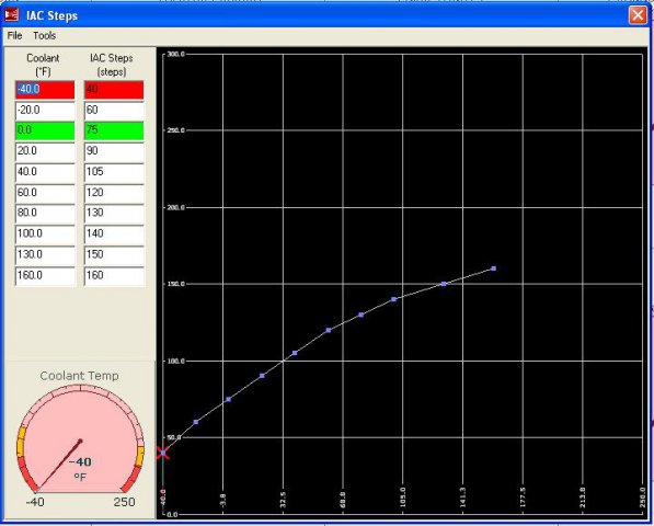

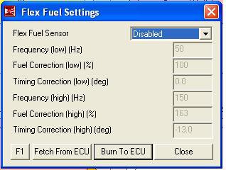

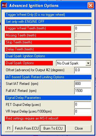

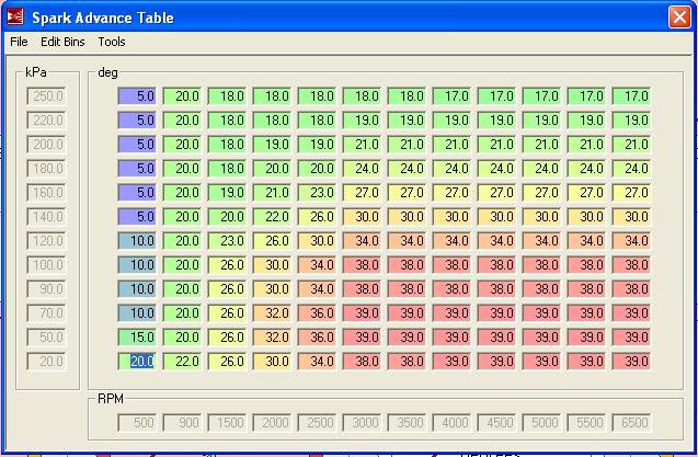

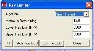

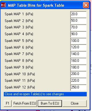

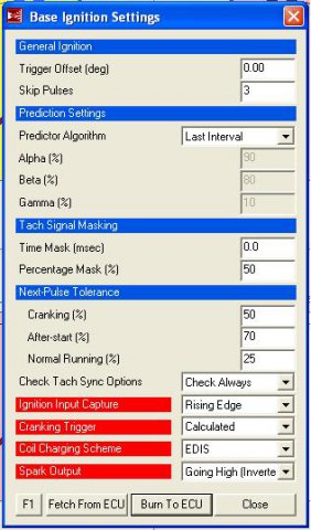

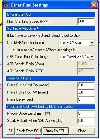

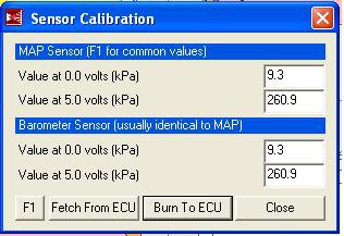

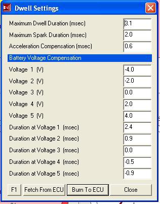

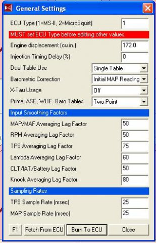

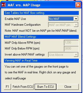

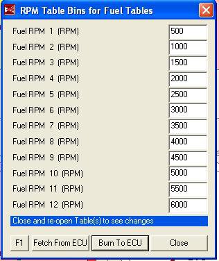

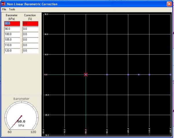

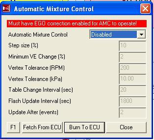

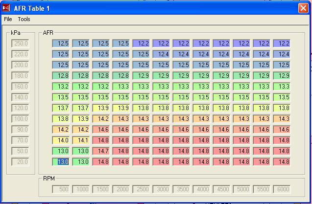

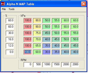

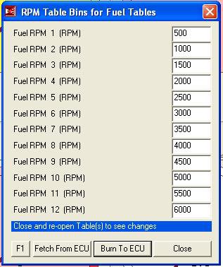

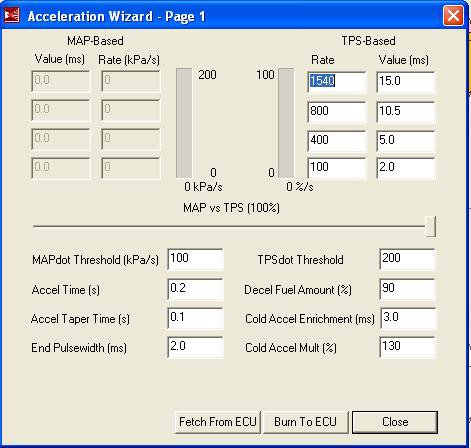

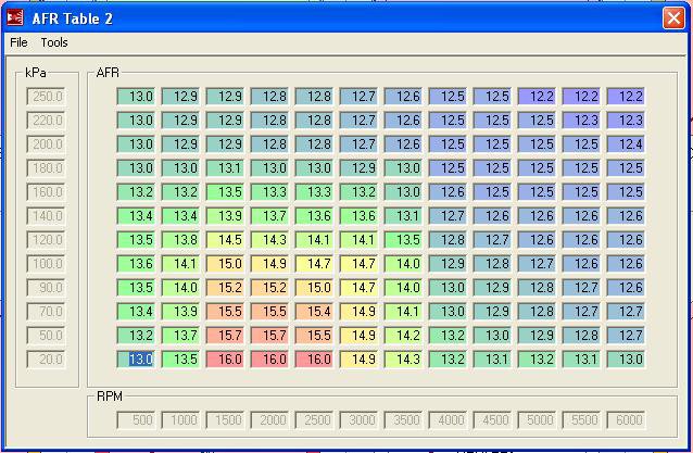

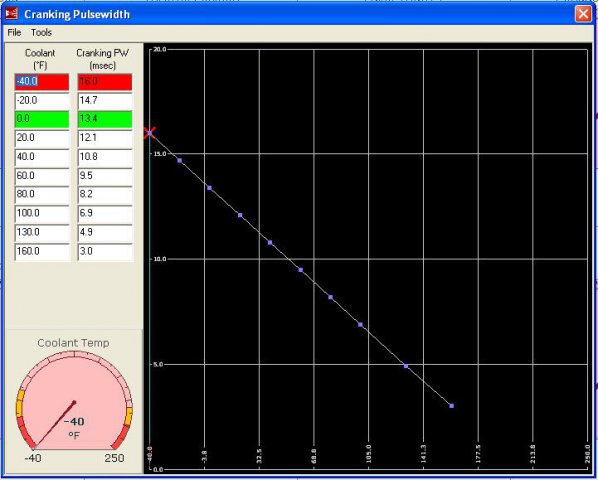

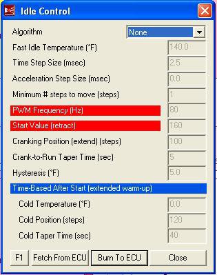

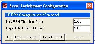

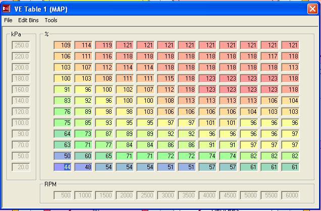

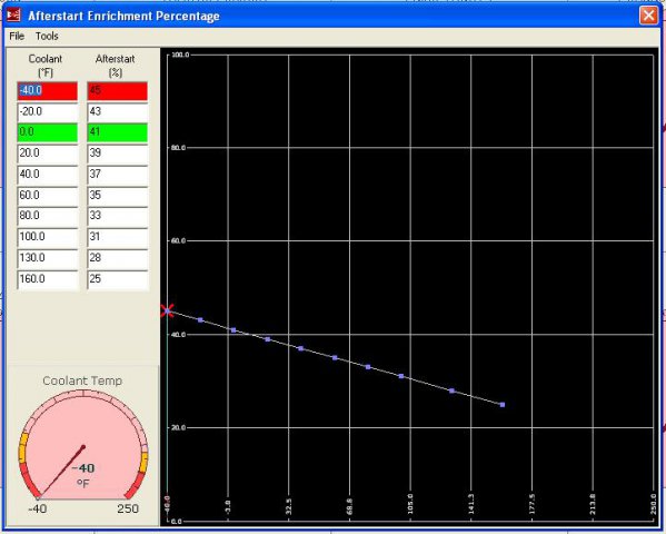

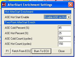

Mods, this could possibly be used as a sticky if anyone else agrees. Ok, Ive been trying to tune this car on and off for the past 6 months. With absolutely no luck Ive come to the members of HBZ to ask for help. I will try to describe everything I can in detail. Please im still a MS noob, im still trying to figgure most of the programs out. The car is a 1980 280zx. Now has a l28et from a 81'. Now also swaped to 5spd. As for the MS side of things, MSII v3.57. Using 2.890 code. I have a 240sx tps, Gm IAT & CLT sensors. Still using the factory 270cc turbo injectors and pump, as well as the factory turbo. The only real mod done is the huge FMIC, and the fact that I am using a Ford EDIS ignition system as well. I have it clocked as per moby's directions. I also have LC-1 wideband dedicated and mounted in the car. Im getting the propper reading in megatune, but not the gauge for some reason. Here are some of the wiring diagrams ive followed during this build, maybe this thread will help some other oncoming noob like myself. Just for reference Ive collected a few screen shots trying to put together a base tune to start with. Now this is what I have come up with, this is not to be trusted or used at the moment, My car currently does start, but cranking time is through the roof, and will not hold an idle or stay running under its own power. As why I am coming to everyone here for help. Here are all the screen shots in order, if there is anything I have entered wrong please feel free to chime in. Ok, on with the screen shots. profunctionprep1.zip
