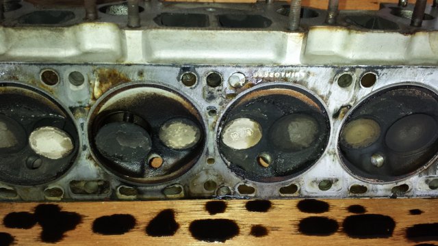

	When I changed the head gasket the first time, I purchased a Felpro. I was a little suspicious when I pulled the head and found a Felpro already installed looking identical to the new one. I had decided to change the head gasket because of an oil leak between #3 and #4 cylinders and high compression reading indicating excess coke. Sure enough, the new head gasket leaked in exactly the same place, and now I had the lumpy idle. After a lot of research, I finally decided to spring for a NISMO head gasket. I even ended up talking directly with Nissan Motor Sports to determine I needed one with an 85mm bore and 1.2mm installed thickness. PN 11044-E4620. Before pulling the head for the second time, I decided to do another compression check. #3 came in at 125 psi while every other cylinder came in at 190-195 psi. Obviously I had a valve seating problem. With the head off, I removed the intake and exhaust valves and cleaned up the valves and seats. With the re-worked valves and new head gasket, the engine fired right up and idled almost 300 rpm higher. I had no idea just how bad the cylinder was affecting the idle. She now purrs like a kitten. Sam280Z thanks for pointing me in the right direction. Just a heads up for our fellow Z car owners. Nissan Motor Sports indicated they now only had 42 of these head gaskets left in stock. Considering the legacy status of these cars, I suspect there will not be another production run when these are gone.

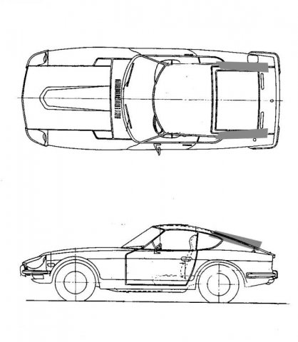

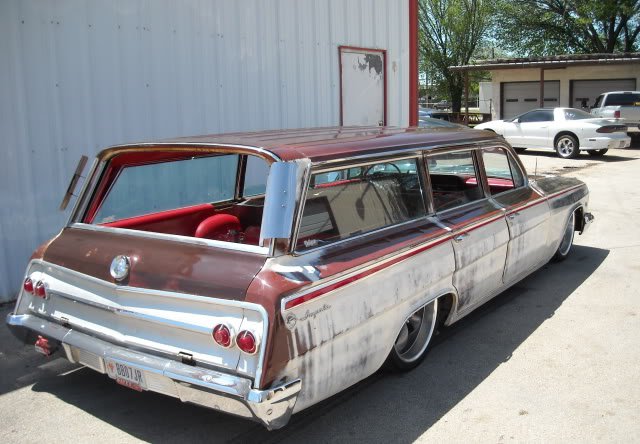

	Has anyone tried this type of air deflector?djwarner replied to djwarner's topic in Windtunnel Test Results and Analysis I was thinking about a station wagon air deflector running across the top, but I found this picture on the web
	I was reading a 2001 post by Michael regarding aerodynamics and exhaust fumes and spoilers. His in depth description of why 240z aerodynamics were so poor got me thinking. NACA scopes are effective because they roll a vortex into the duct to help break up the laminar flow. I got to thinking about the low pressure area over the rear hatch and the relatively higher pressure on the sides of the cockpit. It occurred to me we could put a curved air deflector over the sail directing air onto the hatch to help to detach the laminar flow coming over the top. I envisioned a deflector like those used on station wagons to keep the rear glass clean. Attached is a picture suggesting my idea. the air deflectors are colored gray. Comment from the more aerodynamically literate among us would be appreciated.

	Interesting thought Sam. When I finished cleaning #3, I noticed just how much the passageway had opened from when I first removed the head. If the stock cam has something like .440" lift, .030-.040" reduction in the passage way would significantly reduce airflow in my opinion. My impression of the lumpy idle was that the odd pulse seemed to have more power rather than less as a miss would have. A leak down test would be in order though. Thanks for the suggestion. Of course, my Series I 240z was an old car when the first ECU was put in a car.
	I can understand heavy detergent use can prevent carbon/coke build up, but have my doubts about washing away glass like hard deposits like those I found while de-carbing my cylinders. Before attacking with a wire brush, I tried soaking in Seafoam, strong detergents, penetrating oil, and anything else I could find in the shop. For those of you who haven't heard about walnut blasting http://www.youtube.com/watch?v=TMQDdb4szUY

	I had already used Seafoam three times shortly before pulling the head. The build up on the valves are not spongy or porous, but rather a hard coke. On the #3 valve that I could get to, the coke just laughed a hard wooden probe. Coke is actually like an amorphous glass, breaking through the outer layer to gain access to the coke/metal junction is almost impossible.
	While replacing the head gasket and de-carbing the combustion chambers, I also cleaned the back side of the #3 intake valve because it was open. It had some .030-.045" layer of hard coke on it. Only later did I realize that there was no easy way to get to the closed intake valve without disassembling. Since this was beyond the scope of repairs as planned, I put the engine back together with only the #3 intake valve clean. I didn't think the extra clearance would make a significant difference, but the engine has a distinct lumpiness now. So I'm wondering about how to remove the coke from the other valves while installed on the engine. I've been using TECHRON but I'm still seeking other methods since the hard coke is not going to allow speedy results. I've heard of people using crushed walnuts with a sand blaster nozzle and seen some photos showing promising results. Has anyone tried removing the intake manifolds and blasting crushed walnuts with the engine in the car? Open to other suggestions.
