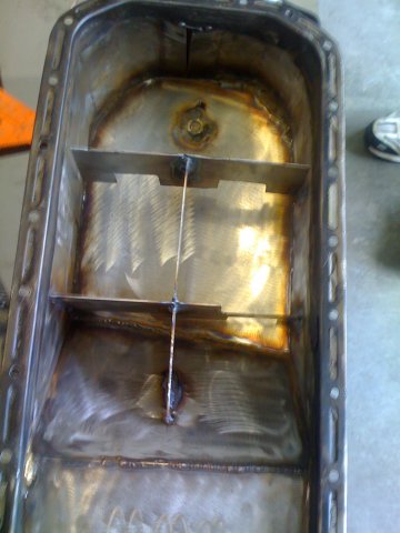

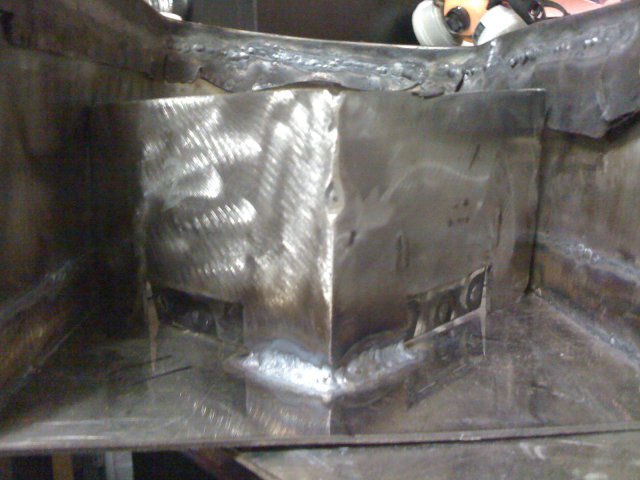

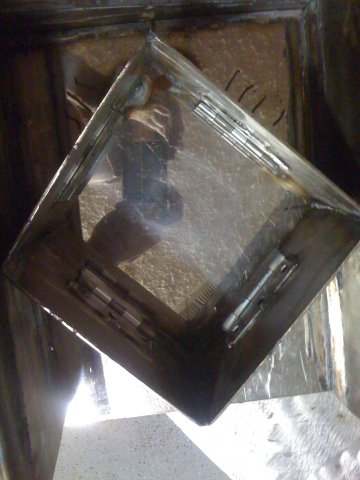

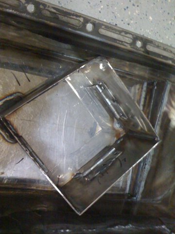

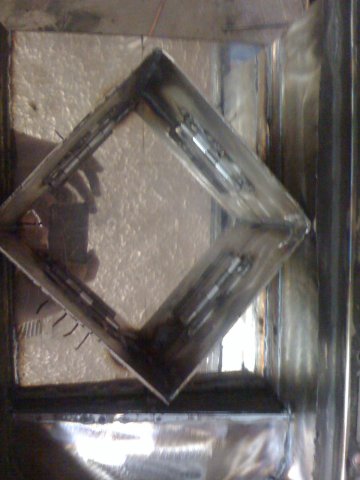

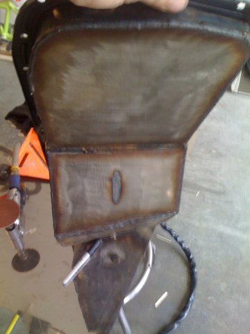

  3. I put the baffles in tonight. I used 4 door hinges. take a look

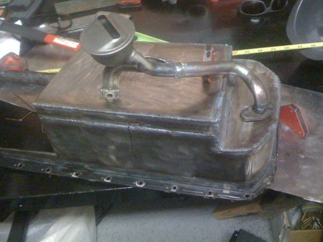

  4. I fab up the pick up tonight.

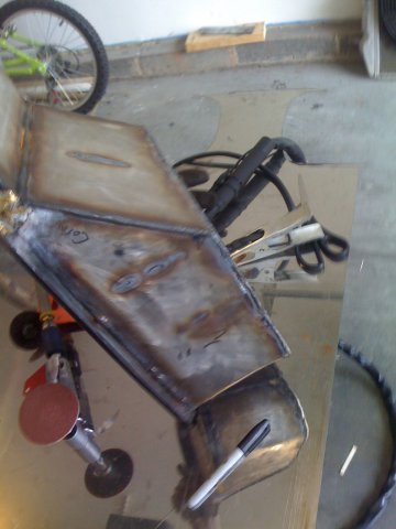

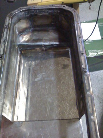

  7. thanks motoman. Just let me know when your ready. I worked on the pan alittle more today. I added alittle more depth to the pan for alittle more oil. As soon as I get the pick up I can fab it up and add baffles and show the finished product.

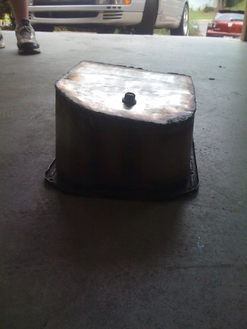

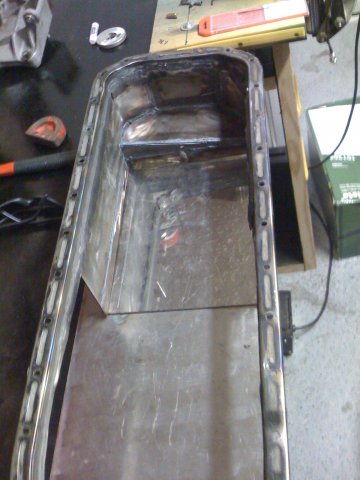

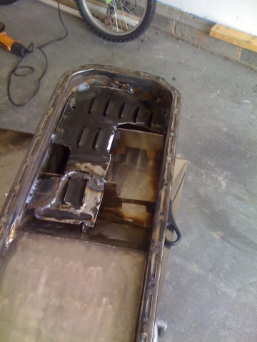

  9. here are some pics of my progress with your pan. It's coming out awesome. I have to say this is going to be alot better than than the one I made for myself. check it out Ignore the the pick up.It's the unmodified rb20 pick up.

  11. pm'ed you. I'll get started asap

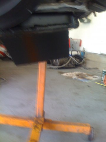

  12. Years ago when I got mine it would not work no matter what I did. I took mine apart and found one of the passage ways was not drilled out all the way. So I drilled it out all the way and it has worked for the last 15 years.

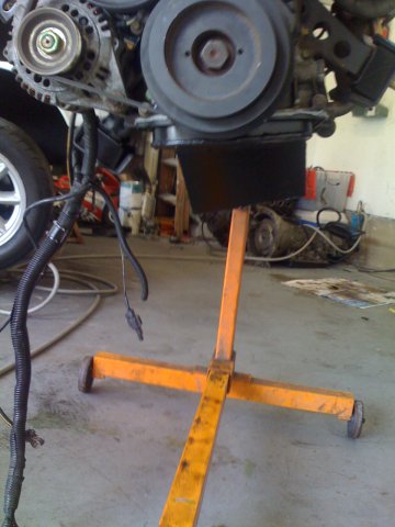

  16. Any engine uses both engine coolant and engine oil to cool the engine so if you can have more oil available the cooler the engine will run. It acts as a oil cooler. And I wanted to have more oil in the pan so I would not run in to any oil starvation problems. Let say at any time there is 2-3 qt of oil in the engine so that means there in still 4-5 qts of oil in the pan. Thats alot of oil still in the pan and that means that there is less chance of oil starvation when braking and high g turns or just giving it hell. I have been giving my engine hell with no oil psi problems.

  20. I cut up the pick up and added a couple inches and made it work.
  21. Here is some pics of mine I made. I was told it wasn't going to work but it works great. I used the stock rb20 oil pan flange and made the rest. build cost was nothing.. It holds 7.5 qts of oil and oil psi is perfect during high g turns and high speed to all out braking.
