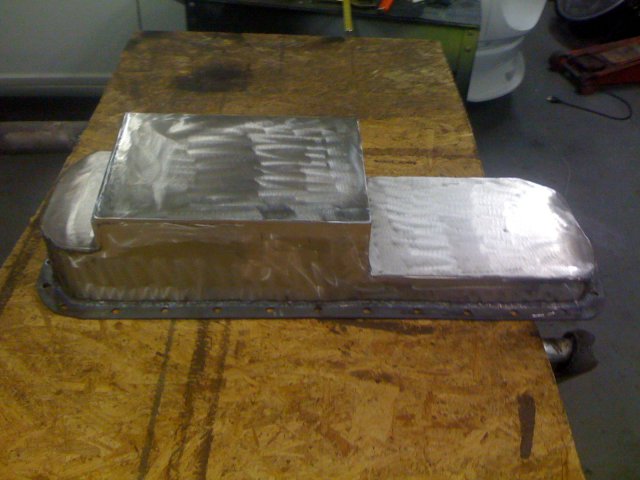

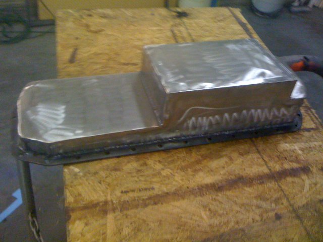

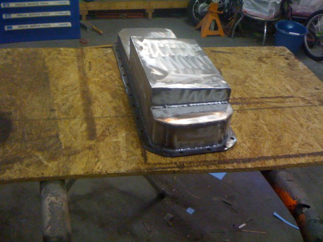

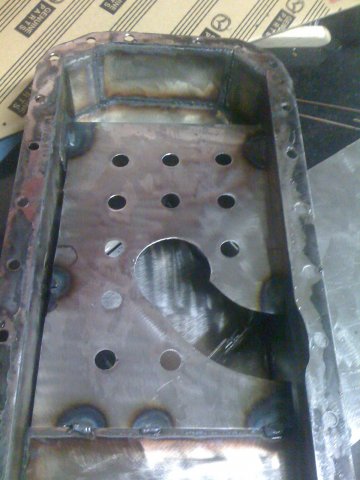

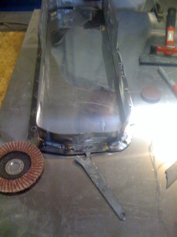

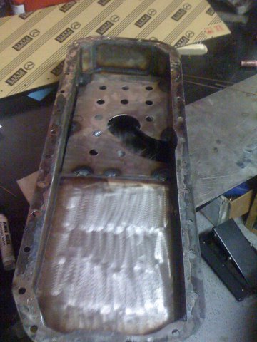

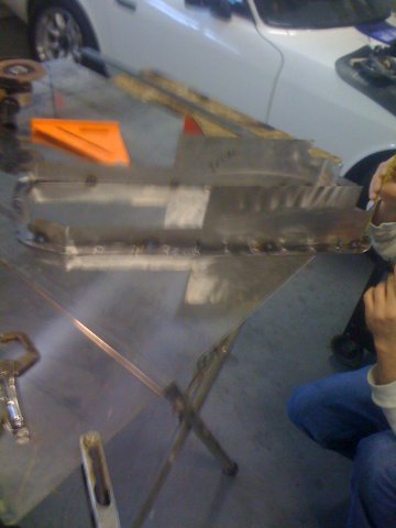

Almost done. added windage tray and leak tested. I have one leak to fix and its done... just have to let it dry so I can fix the leak.. Tanuki your's is next.
thank you
thanks Motoman:mrgreen:
It should not matter. My pans are not really that deep.

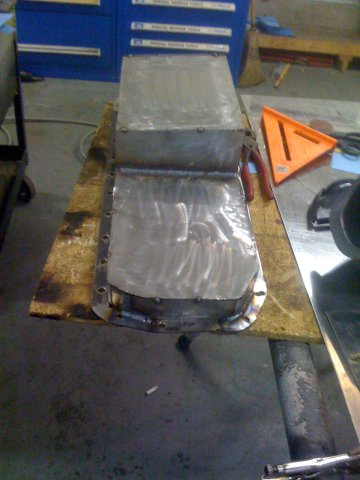

The engine sets in the engine bay at a slant. The exhaust side sets lower than the intake side in turn making the engine set at a slant. So the oil will naturally drain back into the pan.the bottom of the pan sits at a slope. One side of the pan is lower than the other. I can get more pics later. Let me know if you have anymore questions thanks Patrick
I like to keep my costumers happy:mrgreen: I think I have 1 more but I'm taking orders:mrgreen:

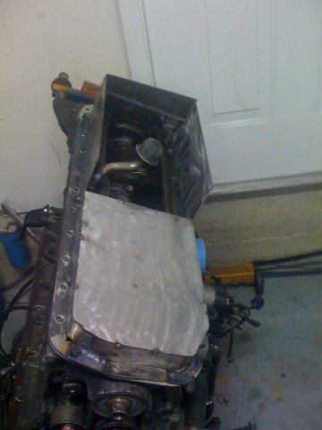

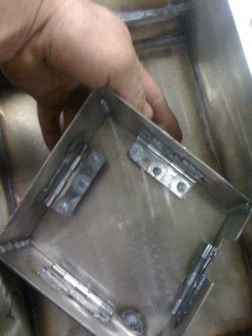

I would be very embarassed if I forgot the drain plug. the pickup is done, I was on a roll today

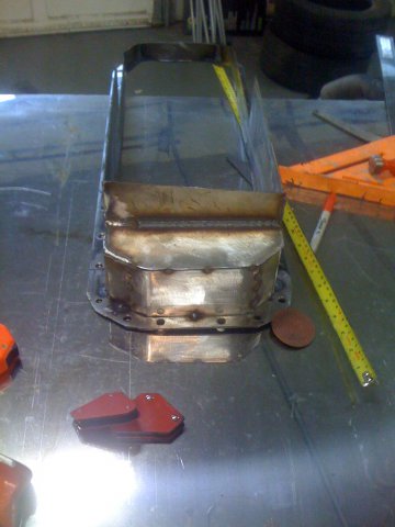

I have about 6-8 hours into it now but my brother was over and there was alot of BSing going on and some beer drinking. I have built a couple of these so far and I have made templates of each sheetmetal cuts. My first one took me forever to do. Now it's getting easy. I have all the sheetmetal tools to make life easier. I love my plasma cutter,it's like a hot knife through butter.
thanks, It's been fun I was out looking at it and I almost forgot the drain plug. LOL That would suck

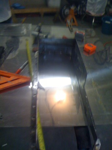

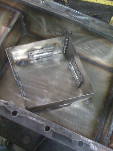

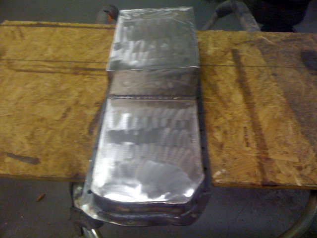

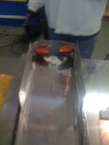

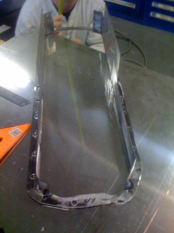

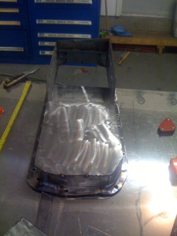

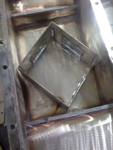

I just wanted to share the oil pan I built for linluv84 today. It came out great and I'm almost done. The only thing left to do is to install the hinges for the baffles.Man I'm tired LOL here are some pics of the build
