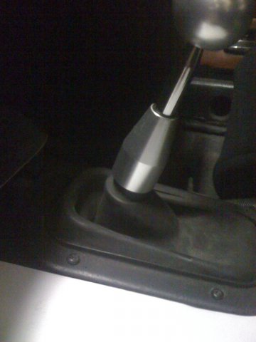

The shifter in my 280z sits about 1 inch foward if that. I know what picture of the 280zx your talking about. It doesn't look anything like that here is a quick picture. let me know if you guys have anymore questions.
