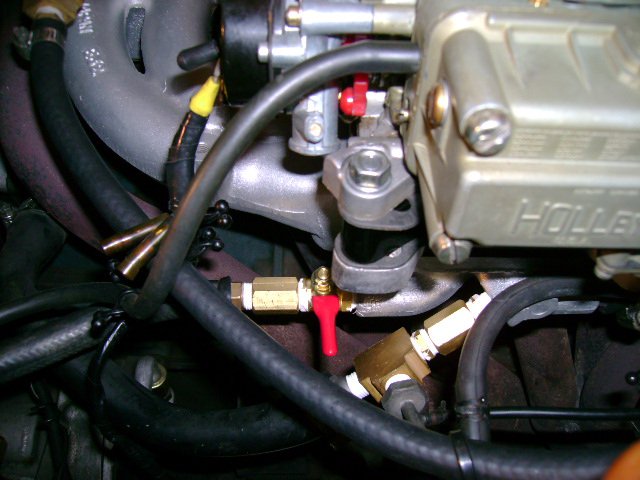

I've done some work and came up with the idea to use a 'tap' or water cock/valve to stop or regulate the flow of coolant through the intake manifold. I could've bypassed the manifold completely, with no coolant running through the manifold at all. However, I wanted the option to use the heated manifold for warmup during the cooler winter months (A problem with previous setups when I didn't hook up the coolant through the intake). Today I started my engine and let it warm up to the point of thermostat opening. I was able to touch the base of the manifold with my hand without it being really hot like the radiator and radiator hoses. This was with the valve shut. When I opened the valve to let the coolant flow, the temperature of the manifold increased quickly to match the temp. of the rest of the cooling system. I could get tricky here, and setup some kind of thermostat arrangement, coolant through the manifold to speed warmup, then shut when engine is warmed up sufficiently. That might be overcomplicating things...maybe? The potential problem I can see with this is to accidentally leave the water valve open and advance the timing to where the engine makes best power. Ping city! Hmmmm, how to have the best of both worlds........ automatically? Ideas? When I get the chance for better weather, I'll take my machine for a run and play around with the ignition timing. The E32 was only 3km/h slower on the 400 meter run (G Tech) compared to the Arizona manifold when last tested, and that's with 10 degrees less static timing. I can't wait! -

For those of you who don't know me, I'm running an L28 N42/N42 combination, mostly stock with a header and a 2.5 inch exhaust, stock cam, four barrel Holley and a 280ZX dizzy with an MSD 6AL. Stock head and compression. I changed over intake manifolds from the Arizona to the Nissan E32 four barrel intake. Virtually a straight swap, it took about an hour to do the lot. Very straightforward. The only difference is that with the Nissan manifold, I reconnected the under plenum water heater arrangement whereas I had left it disconnected with the Arizona. The Holley required some slight tuning to match the new manifold but the mixtures are as they should be, verified by my Innovate WBo2 data log. Now here is the issue, the Arizona could run with up to 17 degrees static timing. The dizzy puts in a verified extra 20 degrees, so it was total of 37 degrees BTDC @ 3500rpm. Premium unleaded, 98 octane/NGK BP6ES-II. With the Nissan manifold, I've had to back off timing to 7 degrees BTDC, 27 degrees total @ 3500rpm. Changed the plugs to BP7ES at 10 degrees but it still pinged, hence the drop to 7 degrees. Now it doesn't ping. Lost some top end power, but the midrange still feels ok. Why did this happen? Intake manifold too hot now with the water heating? (Fantastic start up though....just bump the starter and it bursts to life....very quiet idle, quite docile at low rpms, still loud at WOT though!) Outside temps hovering around 18-20 degrees celcius, not hot at all! Your thoughts and/or ideas? Cheers!
