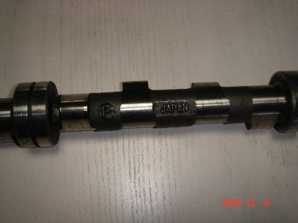

Cam install/Spring height/Rocker dilemma
ozconnection replied to Babalouie's topic in Nissan L6 Forum
Saw this cam and I thought I would post it. Reminded me of Babalouie's cam. I don't know what the letter 'F' means. I haven't seen that before. -
