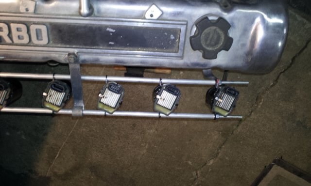

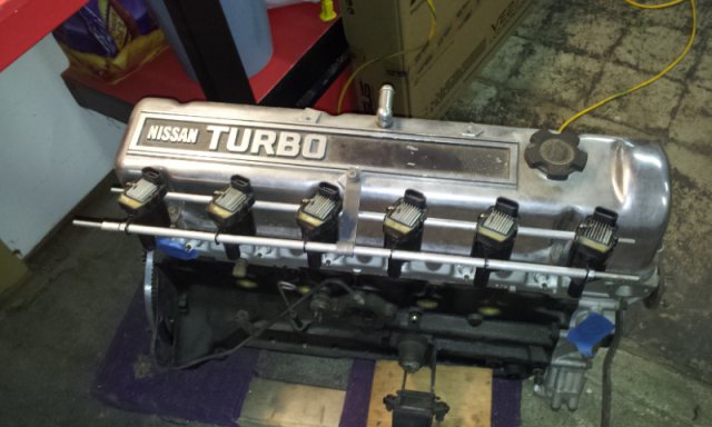

LS2 truck coils. I picked up eight, with pigtails and OEM brackets off eBay for $113 shipped. I spent another $45 on aluminum tube and 1/8"x3/4" mild steel bar stock that I used to make the mounting brackets. -

I don't have access to a machine shop, so I thought I'd try for cheap and simple. I'm fairly pleased with the results. Materials (about $45) (2) 20" 1/4-28 all-thread (4) 1/4-28 nuts and washers (4 nylock nuts to be installed after final tweaks) (4) 4" 3/8 OD .49 wall T6061 aluminum tube (4) 3.75" 3/8 OD .49 wall T6061 aluminum tube (4) 3.55" 3/8 OD .49 wall T6061 aluminum tube (2) 4" x 3/4" x 1/8" mild steel bar (1) 6" x 3/4" x 1/8" mild steel bar The coils are spaced apart with the tube using the pattern 4" - 3.75" - 3.55" - 3.75" - 4" The end brackets were fairly simple, a 90 degree bend 1" from one end, then a 90 degree twist about 1.5" from the other end. I twisted the brackets in opposite directions and mounted them such that the brackets would pull against each other. I then drilled 1/4" holes 1/2" from both ends. The short ends had their corners rounded off using a bench grinder to fit in the valve cover hold down pocket. (sorry I did not get a good picture of these) The upper middle bracket was eyeballed, and has loop on one end formed with a vise and pliers, and a 15 degree or so bend 1" from the other end to provide a slight lift to the outside aluminum rail. About 90 minutes worth of puttering to make and adjust the brackets. Once the coil rails were tightened the whole structure became very stiff, and trying to twist or flex the setup just moves the whole motor. I still need to trim the all-thread and replace the standard nuts with some nylock nuts.
