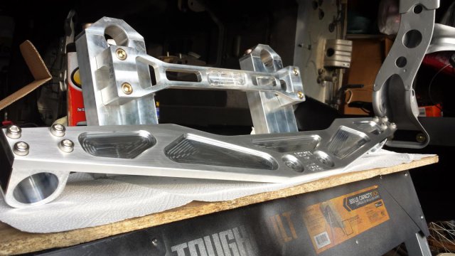

  3. Few irregularities I want to address here. First and foremost, as stated before the First few who ordered our Rear suspension kits have had issues with delivery times, axles, and fitment. That being said I have addressed those on this thread on September 25, 2020. That being said Matthew, otherwise known as 05plst4 was one of the first who ordered our rear suspension kit. He purchased it on 7/11/2019. So the issues with lead times and quality are present as the early buyers. (also highlighted phrase in pictures attached) That being said, Me and Matthew have agreed on a set of Front Control Arms, discounted and shipped for free to Canada, along with an extra set of ball joints and boots. We did not "Give up on the customer" (see attached) That being said we are slightly over 1.5 year old of a company when he purchased so the growing pains are apparent as found in any new start-ups and was still working part-time at the time. I'm not giving excuses, just some insight as to the situation. Now to proceed, If a customer ordered a rear suspension kit in the last couple of months we had them shipped (as long as they were not custom and a popular diff/wheel bearing option) we were able to have them shipped in 2 to 4 weeks. Complete, with axles, all hardware plastic wrapped and packaged in a double walled box. We have finished ALL the Ford 8.8 to 370z axles, ALL the Ford 8.8 to 300zx axles, All the 300zx to 370z. The last few 300zx to 300zx are finishing up and are on to the R230 diffs. We are also caught up on ALL Black Friday orders since March 12th (unless custom) Which is considerably better than other vendors who still are not caught up. We all know the unhappy customers voice will express their thoughts and experience more than the happy customers, and rightfully so, it's their right and helps push companies to strive higher and perform better. We are not a company that has been around since the 90s like AZC or early 2000s like T3 we had our first control arm sold in 2018 and slowly started building products after, so we are still learning the ropes. Furthermore, we invested in the machinery to make the Axles and the CNCs to make products faster and in house. In the last 8 months we spent nearly 7 figures on state of the art CNCs, New Welders, 3D scanners, More team members, packaging equipment and now are moving into our largest facility yet on the 21st of this month. Forums (IMHO) seem to bring a one-sided view point to any company, I would highly recommend asking the Facebook groups and see the high customer satisfaction rates and growth of them over the recent years. Ask customers about their experiences and watch customers post their videos of their S30s running and driving with our suspension kits. About 38% of our customer base are repeat customers. Those who bought parts and keep coming back to us, Many of those are professional installation shops, Godzilla Race works, Fitted Garage, and MA Motorsports to name a few, if they were not happy with their products why would they keep coming back? I've apologized before and ill apologies again for those who purchased early kits and seen the poor craftsmanship, poor fit up, and long lead times, we have addressed those issues over the last year and continued to provide better results as a time went on. Again, I am rarely on this Forum unless someone messages me about it, so email me if you want a faster reply. Thanks - Apex Team

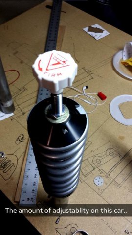

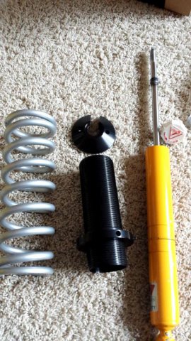

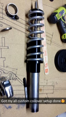

  10. you can see in this pic how the frame rails help tie the whole frame of the car together. also the new shocks i made for a custom set up. now this was about a good half year ago or so. the plans for the suspension for this car changed drastically. and i am pretty much attempting something that hasn't been done before. not going to post any pictures yet because i am planning to sell the products. but lets just say its going to be seriously insane .

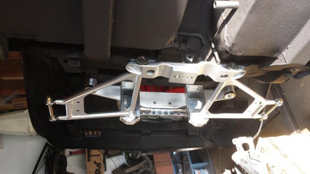

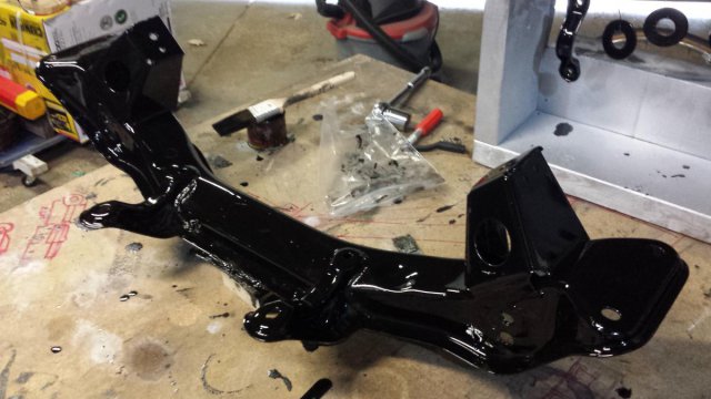

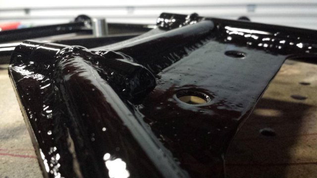

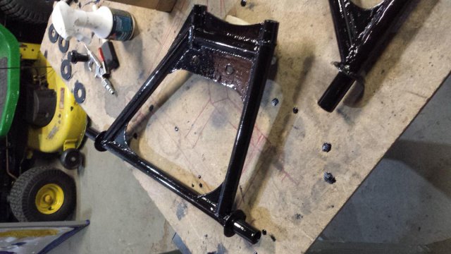

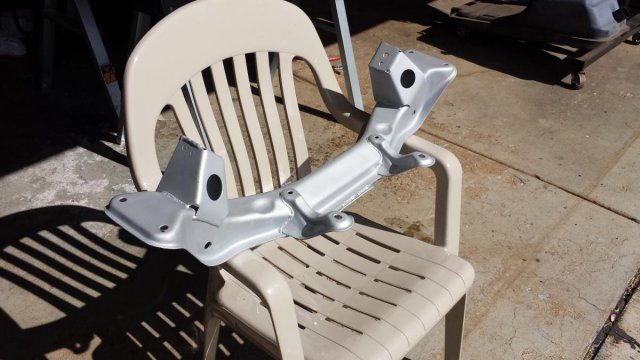

  11. this was the new front suspension i fab'd up. looks good. and very functional! all suspension was painted with POR15 for no chance of rust. and then sprayed with a color! all hardware was supplied from Midwest Control Products and turned out pretty good in my opinion!
  12. thanks! and i would say tacked unpainted and everything around $150. fully done and painted $250

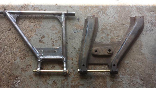

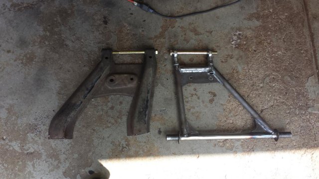

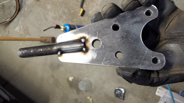

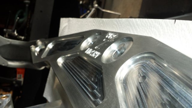

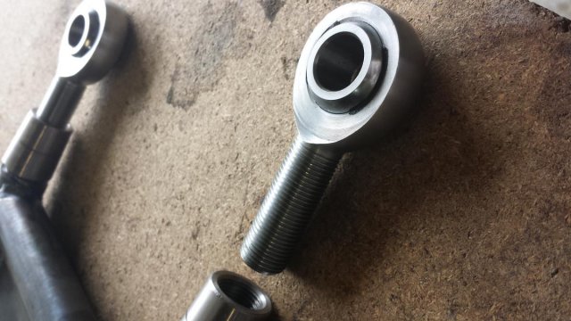

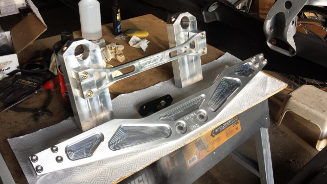

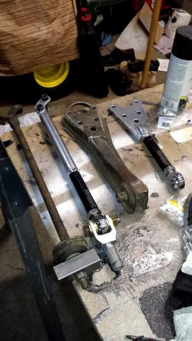

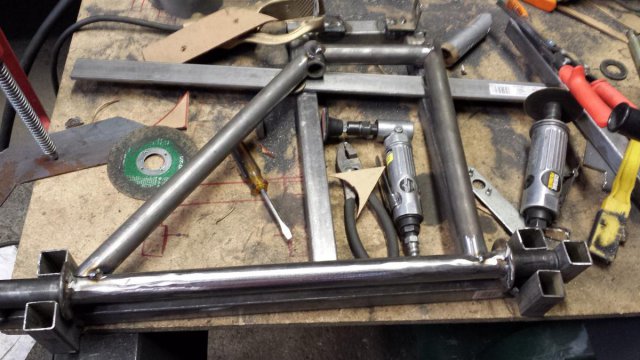

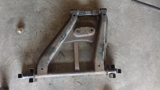

  13. then i bought the billet brake kit as well as a mustache bar from Arizona Z Car. THEY MAKE A FREKKIN SICK PRODUCT. just saying. it looks gorgeous. then i built control arms for the car using the old arms to make the jig. i bought rod ends and threaded bungs from Midwest Control Products. really good, affordable products.

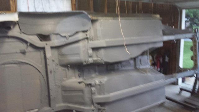

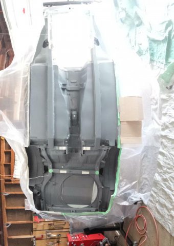

  14. wow. its been a while huh? so this was last summer when i sprayed the undercoating. i used 3M body Shutlz. works well and is though too!

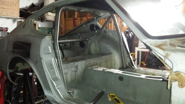

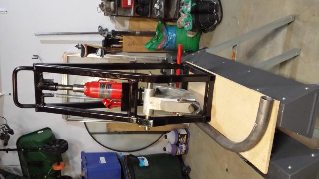

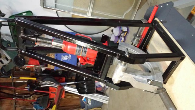

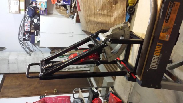

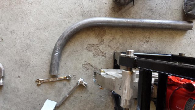

  15. then i built a tube bender so i can do my roll cage.... I BUILT IT OF LESS THAN $200!!! I MADE A YOUTUBE VIDEO ABOUT IT ...name: 200 tube bender search on youtube.... username: ohmster101

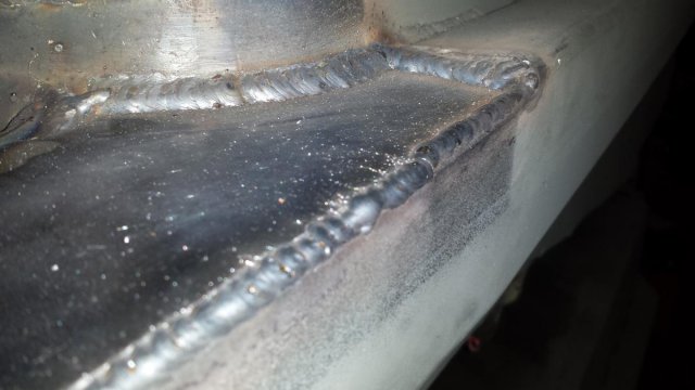

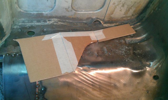

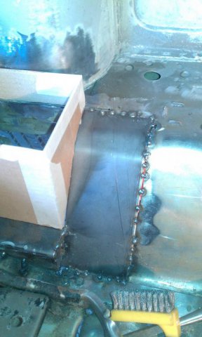

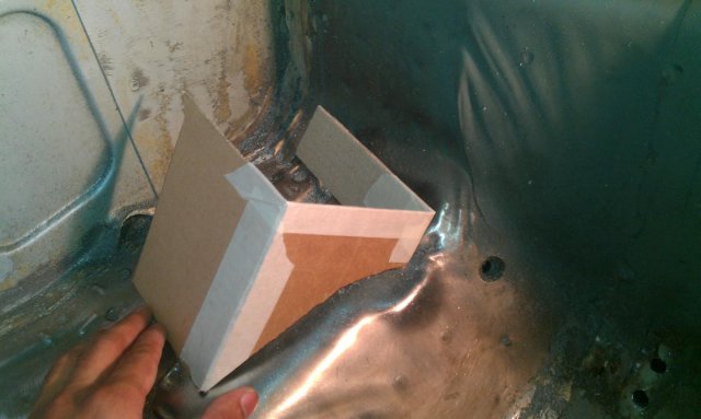

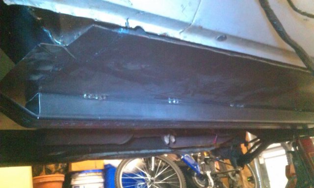

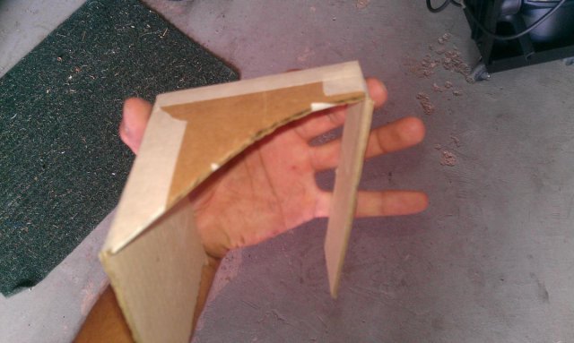

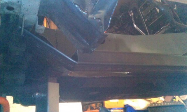

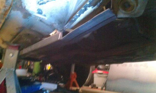

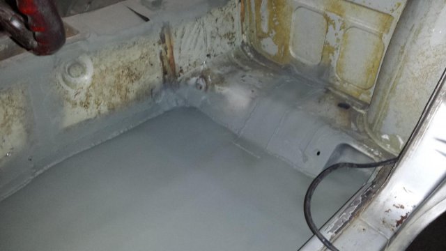

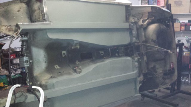

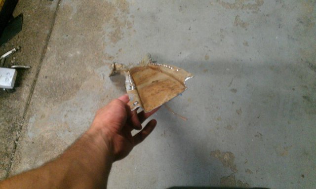

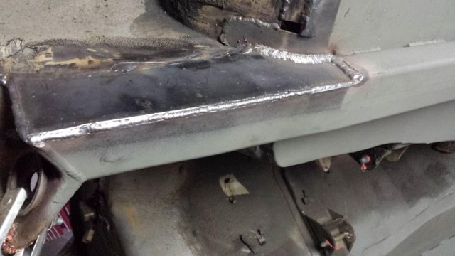

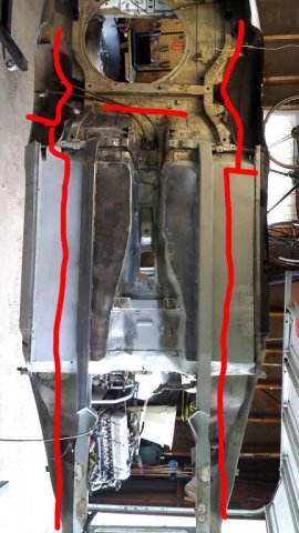

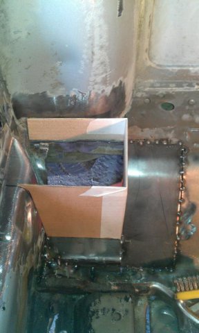

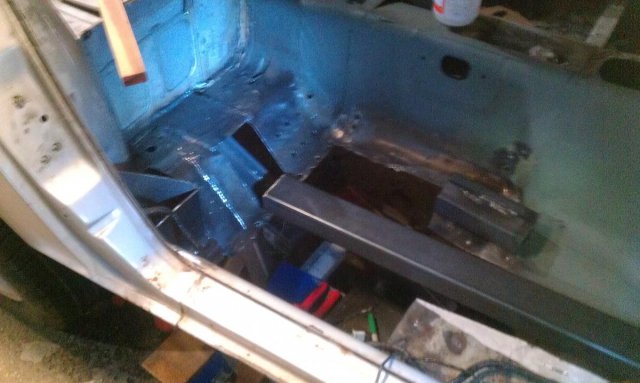

  16. okay, so i closed of the frame rails with a piece of 1/8" mild steel. 1) cut out cardboard template 2) cut it out of steel 3) welded it closed VERY IMPORTANT TO REINFORCE FRAME IF YOU WANT MORE POWWWWAAAAA!!!!! (Jeremy Clarkson voice)

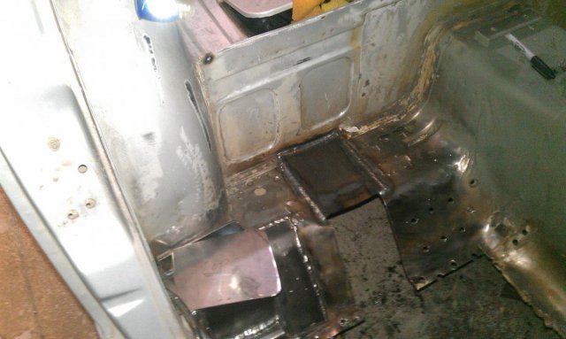

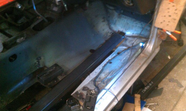

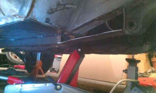

  17. then i put in these frame rails...they are 2x3x1/8" wall steel rectangular tubing...made them specifically to raise the floor of the car up 1" so i could have a big more ground clearance when i lower the car...any questions??

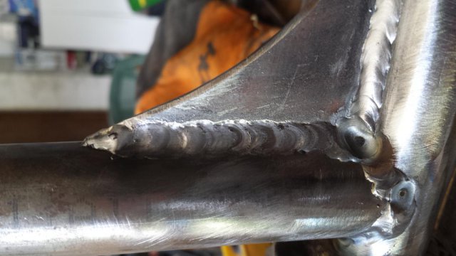

  18. I bought this Longevity mig 140....it works well....go on my YouTube channel to see a review...for the roll cage welding that 1 5/8" with 1/8" wall DOM tube it didn't work so well...i will do that with tig

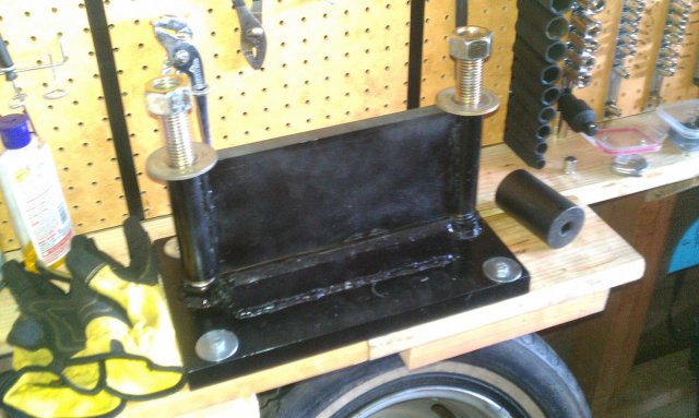

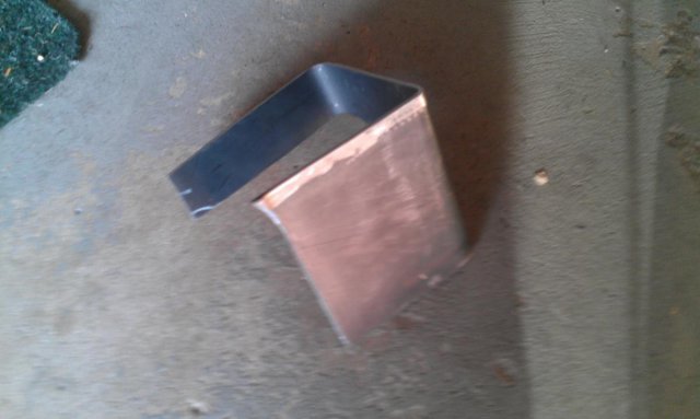

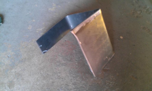

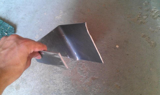

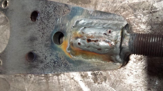

  19. i made this brake from...JUST ASK IF YOU NEED HELP TO MAKE YOUR OWN!!!...i used it to make the main hoop mounts....the mounts are made from 1/8" steel...i formed a 1/4" steel plate 4 by 4" and it bent that into a 90 degree angle without any problems

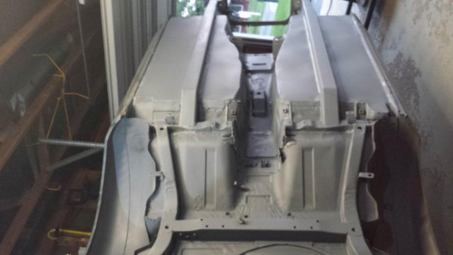

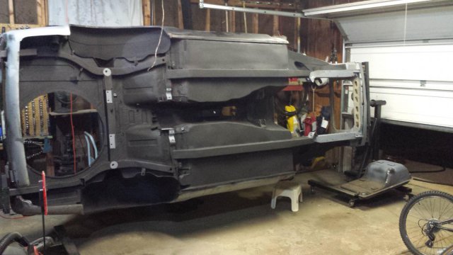

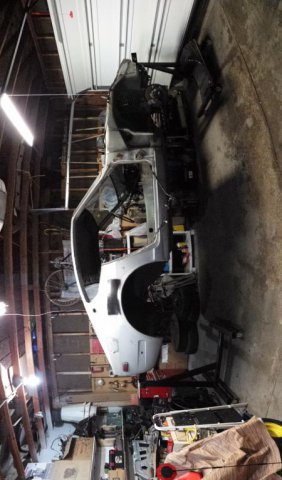

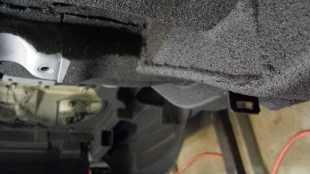

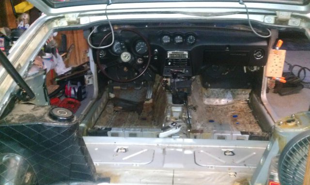

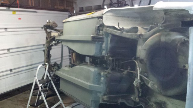

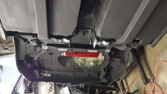

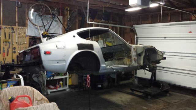

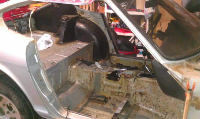

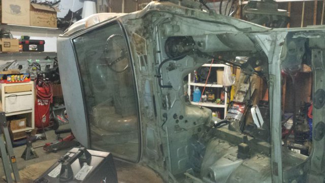

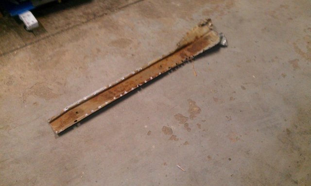

  20. Okay so here we goo...back when i first got the car about 2 summers ago...i began with stripping the car completely...i was preparing the car to put in a new floor and frame rails that i would fabricate....i used a needle scaler and a hammer and chisel to get the sound denting materiel off. It was surprisingly fast and accurate....then i used a hardware store glue to dissolve and get rid of the left over glue from the leather that was stuck in the interior
  21. yea i have...about 1 and a half years of photos...im playing catch up lol

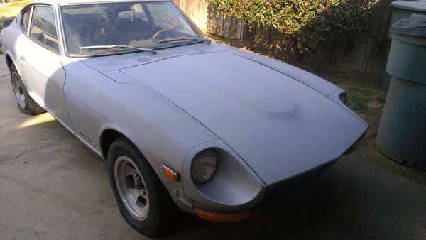

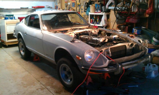

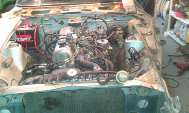

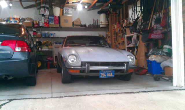

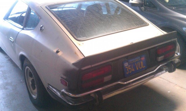

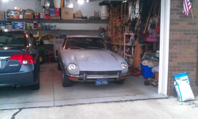

  22. well here we go....i haven't posted anything on anything on here ever...I began this project on June 24, 2013....I was 19 at the time...i bought it out of California...spend $2800 on the car and then another $1000 on just shipping it here in Wisconsin. over the next few days i will be playing catch up with showing all of you my build over the last year and a half...regretting i didn't start this earlier
