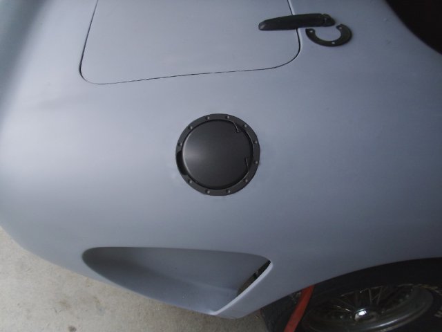

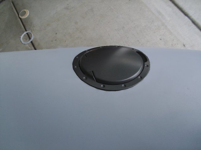

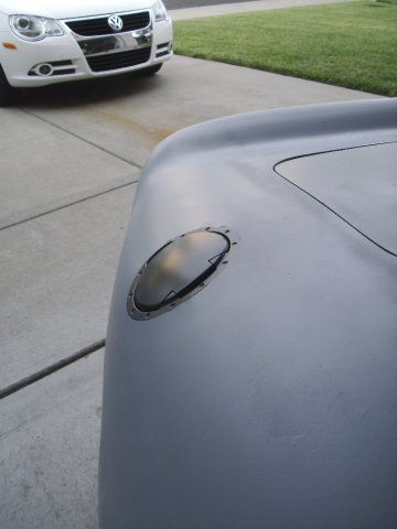

Hey Michael, here's my current plan for the fuel door. It's from a 2004 Mitzubishi Eclipse. The contour is very close to the that of the VR at the precut hole. $35 including shipping on ebay. It'll probably get a chrome finish to match the RX7 hinges. Did you bond the rear tub yet? How did it go? Wes
