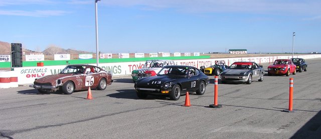

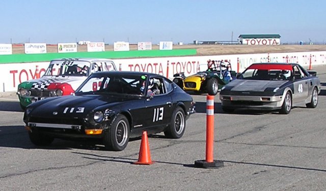

beermanpete replied to Khaserwolf's topic in Brakes, Wheels, Suspension and Chassis
We have Tokiko HP "Blue" struts and Tokiko "lowering" springs on our 73. We use the car for time trials on the race track and have been happy so far. It is not too stiff for the street in my opinion but it is perhaps a bit firm for some peoples taste. Ours is the black one in the foregournd. The tires are 225/50R15. -
