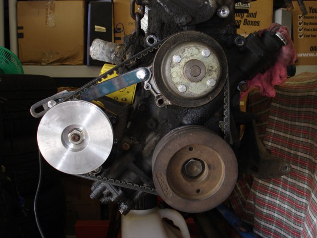

The screw type adjuster is nice. So far what we have thought about is using an aluminum braket with a PEM nut at the alternator end. The screw can go in from the back side. There is a short slot in the aleternator so it will have some adjustment, but not very much. Luckily the braket is flat so it will be easy to make a new one. We hope to eventually make an aluminum lower mount at some point to replace the original heavy cat iron part. The pulley seems ok so far. The groove is aligned nicely with the crank pulley and water pump pully. The only issue we found so far is he bolt clearance. After we get the wiring back in the car and run it we will know if the pully diameter is correct or not.

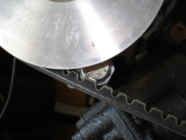

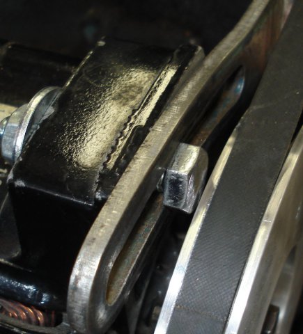

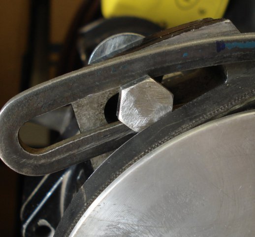

We finally got the new pulley on and a v-belt that fits. The belt size is Gates 7360. The length (circumference) is 36 - 5/8". So for it looks like it will work ok. The only snag is the space between the pulley and the mounting bolts. The pulley is large enough to overhang the bolts. The space is a bit too small, especially at the upper mount, so I thinned the bolt head a bit and reomved the washers. I think the mounting is good enough to run the engine long enough to test the alternator output to assess the pulley size. If the alternator needs to be sped up the pulley will get smaller and the bolt clearance problem might go away. If the pulley size stays as it is I will have to figure out how to improve the mounting so it will be suitable for regular service. It will be a few weeks before the car is ready to run and we can test the alternator.
