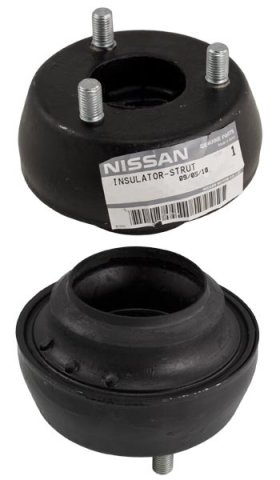

I'm looking for the big black rubber mount that goes on top of the stut/shock assembly. Specifically: 240z front or rear top mount: or 280z front. i have included a pic from MSA's website so you know exactly what i'm looking for.. Thanks
