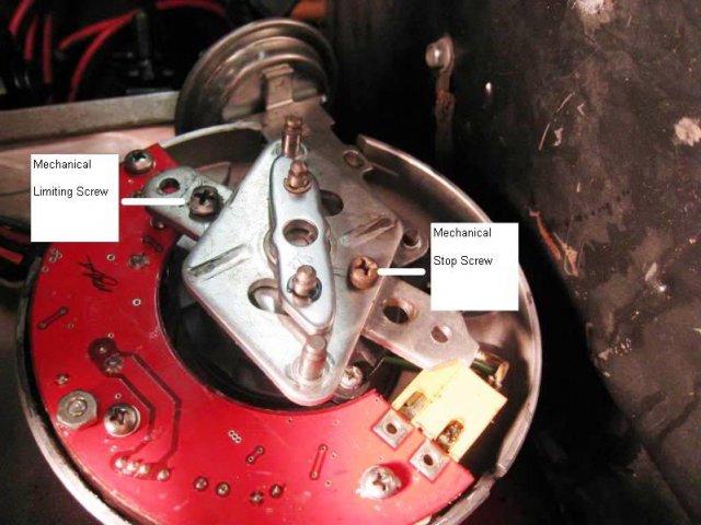

  21. oh ok ok I think I got it but just to be sure and for other people to also reference I added the same HEI picture with blue points and a red reference pointing to the welding points. Let me know if that looks correct to you.
  22. also I found this picture online it is for a HEI dizzy and shows 2 screws. so its that basically what I need to do with the Datsun dizzy
  23. Thanks for the advice guys I really appreciated. Do you happen to have or willing to share your MS file. I'm looking for a file to reference and see the different tables for AFR and spark to get and idea if im in the ballpark with the values.
  24. Thanks for the info. I'm trying to find something online to see where to weld. Did you welded by the springs to lock them up?
