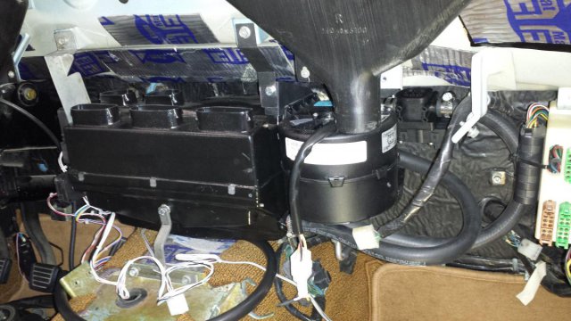

More work done over the weekend. Before going to the salvage yard for a 300Z distributor, I put the spare distributor back together, made jumper wires, and hooked it up to the MS3X. I now have a good crank and cam signal! I still show a 'cam fault' error in TunerStudio, but will work on that later. Went back to the garage and got the heater hoses hooked up and finished inside the car. I put the dash back in to see how to route the vent and defrost hoses then pulled it back out. Final location of the inside unit; It should be about another inch forward (towards the seats) to have better clearance for the hoses, but that is where it ended up. After that I moved to the engine bay. I found the heater hose outlets on the firewall interfered with the very back coil pack, so had to move the coil to the other end. I think I have the final config for the coil mounts. I need to get some different fittings for the heater hoses to connect to the bulkhead to get them angled the right way. After that, I lifted the engine up with the hoist so it would be easier to remove the oil filter bypass plug, and install the pressure relief valve in its place, and screw in the oil filter stud. Dropped the engine back in and then just fiddled around with a few other miscellaneous things.

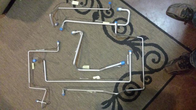

Got some work done over the weekend. We pulled the bulkhead fittings for the A/c and heater, sealed them to the firewall and finished up, installed the inside heat/air unit and the two A/C lines. Need to finish up the heater hoses, then can put the dash back in. Made a bracket for the wastegate actuator. Worked on the wastegate port on the turbo and enlarged and smoothed it out. Need to get the gasket for mounting to the manifold so I can match up the openings, and match it to the head. Need to port match the intake to the head also. I have a bunch of parts set aside to be cleaned an prepped for paint. Have to wait until this weekend to paint as it is too cold outside this week. I also finished building the MS3X and am now moving onto testing it with the stim and loading and using the software. I am still on the look-out for a PWM idle valve to incorporate. We did get the coil mount finished aside from painting...

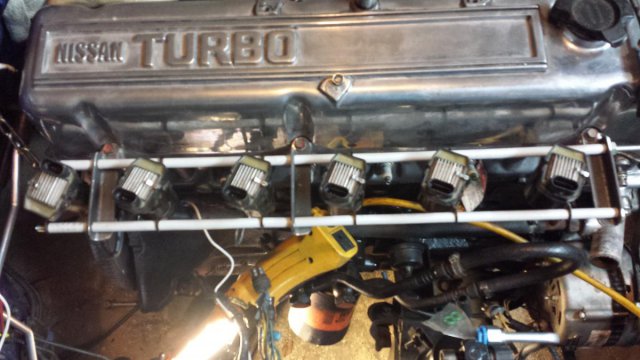

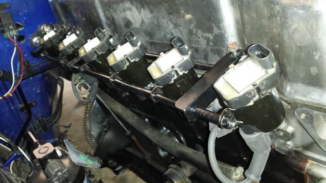

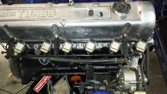

I began installing the A/C hard lines and have the two inside the car fitted. I need to pull the bulkhead fittings and seal them to the firewall, then install the inside unit for the last time. While I worked on that, my son pulled the intake and fitted the throttle body. He then pulled the turbo and we found that we will need a different mount for the wastegate actuator as the one we have doesnt fit the hole spacing, and hits on the housing. He then went on to finish up the mounts for the coils. They need some more final finishing, then I can post up photos. In between work, holidays, and family, I have been working on the MS3X building. I have run into a problem during the assembly that I am researching. I am at step 29 of the assembly where you test for 0-5V at the TSEL. When I test, I get up to 160mv, with drops to 40mv. I don't know if this is right, as I am expecting to see something higher, like 3V or so.
