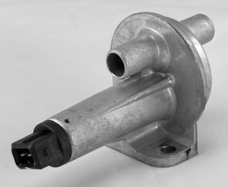

  2. I am in need of an Air regulator for a 75 280Z. The 75 is specific to that year only. Should look like the attached picture.
