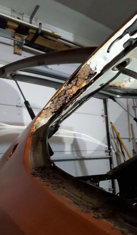

rturbo930 - Yeah that's a good point. I actually had a 2+2 prior to this that started giving me all kinds of rust surprised I didn't see coming. I saw this one and DID see the slight rust on the paint around the window frame, but I didn't think it was this bad. At least I prepared for things to not necessarily go as planned. Thanks for the tip on the structural elements - I will give it a closer look tonight and reach out to a fabricator that has some interest in this project. Neverdone - I like the way you think. I actually have an almost identical spreadsheet as you describe. Even started plugging in websites today because I know I'll forget where I found parts. I'm not ready to plug in the "Total" SUM equation yet with the 1.5x multiplier. haha
I've got the interior about 95% gutted and have run into the first significant rust. I could tell by the condition of the paint around the quarter-panel windows that there was some level of rust along the C-pillar (?). Got the windows out and wow... worse than I thought, especially passenger side (see pic). Of course I cut my palm open on it while removing some weatherstripping. I'll probably have to get someone with a bit more fabrication experience than myself to tackle this rust area. As much as I'd like to try, I can't afford to screw up this area. Besides that, nothing too exciting yet to report. Pulling engine soon, then hoping to find a rotisserie to start butchering and inspecting the underside before sending off to have the whole car blasted. I'm 99% on board with the LS1 swap, but am not focusing too strongly on it, as I have a lot of body stuff to do, and figure out the depth of "while you're in there" stuff to splurge on. With the amount of threads I'm reading, I keep forgetting what I read from a couple days prior, so it's time to hang a whiteboard in the garage. Might have to start erasing prices from my planned parts list as well
