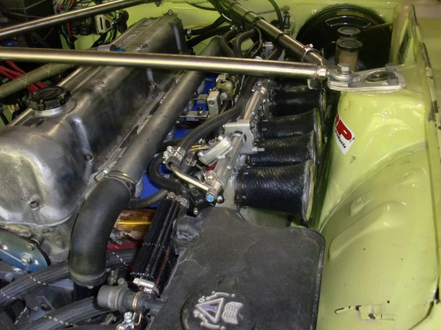

Hi, Already done years ago : 6 holes above exhaust pipes, and one big tube feeding water in reverse flow with an australian electric water pump Davis Craig. Absolutely no problem of over warming there are two little purging hoses in the upper roof of the head , for avoiding eventually steam , returning to the expansion tank excuse my bad english in my explanations Regards Didier PS : Peter Macdonnel built an amazing system like this on the Green Hornet , but no reverse flow

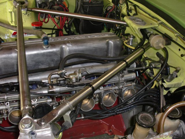

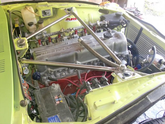

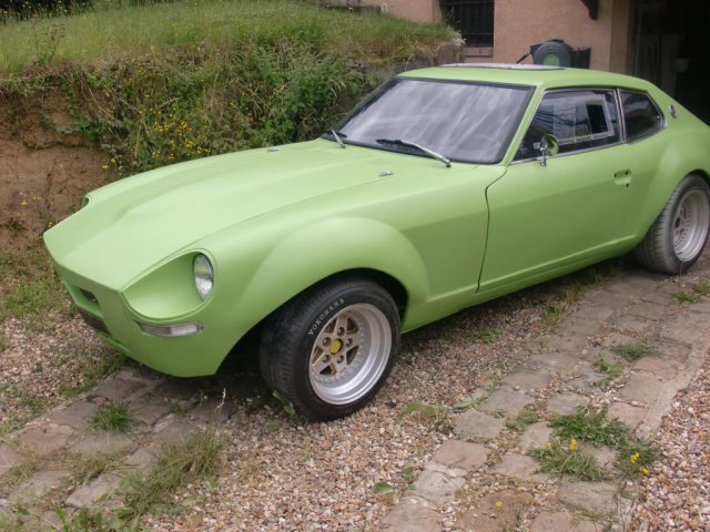

Hi, here my 260 2+2 just finished : rebored block F54 (90 mm) P90 head with cam, injection ITB's ( gsxr) mégasquirt/Edis 6 Dry sump pump, electric water pump davis craig, custom idler gear, OBX lsd, etc , etc , Big brakes front/rear all body parts in fiber glass/Polyester : front and rear hood, fenders, doors, front and rear , etc etc i made moulds myself . Gotti wheels 225/50/15 front ,,, 245/45/16 rear Plastidip with custom color, pearlizer finishing coat

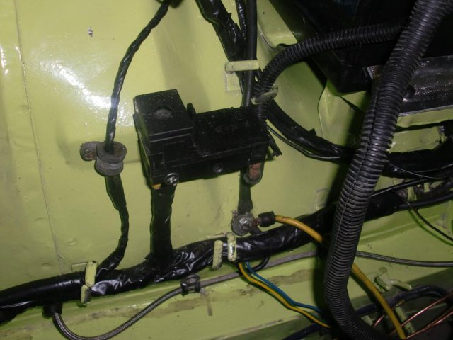

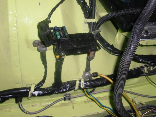

I swapped the two antic fusible links with a modern fuse box Peugeot . 4 x 30 amps blade fuses in a little box. very smart and reliable some pics :
