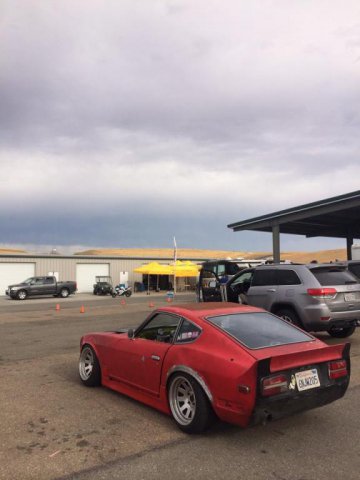

After figuring out we didn't have enough monies for ASB this weekend we decided we might aswell host our own event for us to make some skids. The it was time to take care of some things before hand. Got some adjustable front coils to replace the current ones and urethane kit was on its way. Steering coupler was finished in a jiffy . Did my control arm arm bushing aswell.....of course that shit.. Was easy too but the old control arm bolt decided to completely cease in the bushing which required me to cut the bolt... Putting the rack bushings in was kinda Tricky to get them to seat properly but we got them in. Blow torch, wire wheel and knife made the mustache bar bushings quite easy Found nail in my tire a week prior to this and I pulled it out. Came back to it and it looks this. Luckily there was some 16's at work at put them on Set me up on 195/50....at the track went over a storm drain and all the tread came off with it. Luckily only one side And lastly the crossmember bushings were put in few days before event day. With a few phone calls, meet ups, packing, and last minute maintenance it was time to make the 200-220 mile round trip to Thunderhill. First time driving the car on track, first Time drifting in this car , and first time hostin our own event was quit a blast. I have some GoPro footage but mainly I wasn't concerned on recording since I just wanted to drive. Also acquired a new job That i start next monday and looking into some possible fixes for the Z since I have some hardcore axle click, weird clutching in noises at freeway speed and my 9.5's are smacking the tension rod. Next event we are trying to attend are Sonoma Drifts Winter Jam which all three of us are going to try to attend which requires cages and essentials. Till next time! -
