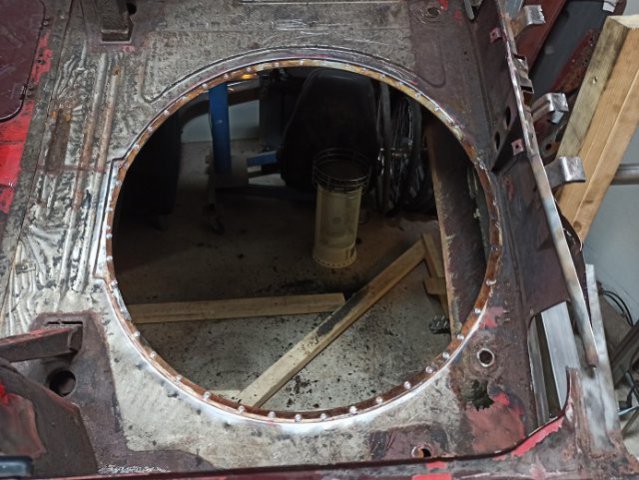

  24. Hi guys, since my last update I have been cadet on a ship and haven't had much time to work. But I'm started getting back at it, especially considering my girlfriend is leaving for 6 months to be a cadet on ships, i will get a lot done. I made a rotisserie from wood and some steel, as it was cheaper and the chassi doesn't way that much, (lifted one end with engine crane and the other by hand with my friend.) I cut out the spare wheel tub, have decided to make a lite bigger fuel tank and a flat floor. And I have almost finished making my own frame rails as I wanted some more strength by having the rails connected to the rear part of the chassi, and partly to make the floors land in the same place. And for those of you whom are curios my rear swaybar goes behind the dif, came that way when i bought it. I also decided that i will be changing the drive line to something more modern, to be more precise i bought a bmw e46 323i, which means i got the m52b25tub engine, and the reason for getting this engine and not the 2.8l one or the s52 m3 engine is that I live in sweden and the law say i can change the power of a car by 20% form my cars specific power, and I do want the car to be fully legal, even if I will be making more power than the bmw made stock. thanks for reading, and i will try to update more the coming months as i finish things on the car!
