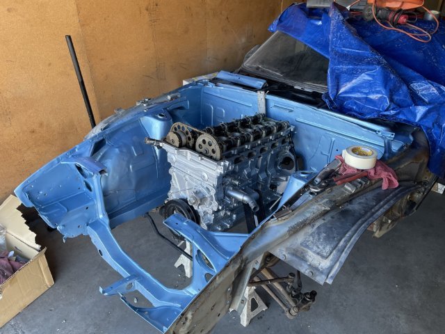

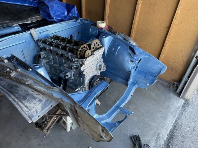

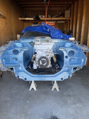

  3. 11-08-2026. I finally got the broken exhaust manifold bolt out, got the new studs installed and then got the turbo header from Forever Fabrication mocked up on there, and re-clocked the Turbo and have it mocked up on there as well. PICS.

  7. 10-31-2026. 5 cylinder ATLAS update: I began the process of drilling out and removing an exhaust manifold bolt that was snapped off by the wrecking yard before I got it, so I got started on it but then took a break, as the drill bits I have aren't cutting it. I went ahead and finished painting up the power steering and tensioner bracket, and mounted it up, then made a small plate to cover an EGP port on the side of the head. Then I began the process I did on my 4200......use the power steering bracket to mount a plate with a hole in it to mount an idler pulley. Tuned out pretty good! A spare socket made the perfect spacer for belt alignment too! The alternator bracket I had made really needed a coat of silver so I got that done as well. The early part of the day was spent doing brake work on the ATLAS Z.....bleeding things out. PICS.

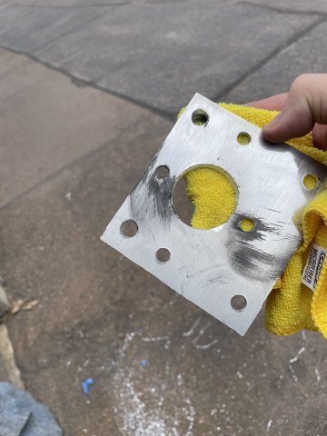

  10. 10-23-2026. I ordered 2 idler pulleys from Amazon....they arrived, very nice, but the hole was too large. So, I took them to Ace Hardware, and got some Bronze bushings. I tapped them in, and then got bolts to bolt them up. Pretty cool.

  16. 10-07-2026. I had a few moments today, So I took some measurements to get started on the DMZ intake DIY kit. Because of the intake, the original alternator location won't work, So I will make my own bracket and move it down to about the halfway mark. Plate steel or plate aluminum, M10X1.5 all thread screwed in to the threaded holes there, and start drilling holes and get it on there, and then slot holes as necessary to get belt alignment just right. PICS:

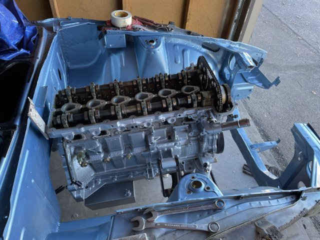

  17. 10-04-2026. I took some time today, and went ahead and removed the wiring harness, the intake manifold and some other parts bolted to the block. The stuff still attached, all the bolts are now broken loose and will be easy to deal with as we go. The parts I removed either got tossed, or put into a pile.....I then cleaned them up and took a couple quick pics. Engine looks a lot smaller once you get all the "junk" off! PICS
