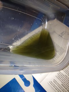

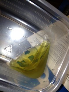

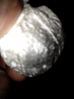

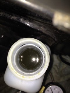

Posting a few pictures that may help diagnose/fix the problem. Brake fluid was about 2 weeks old. One photo shows how it looked in the master cyl. Then I bled some off into a tuperware. Paper toweled out the reservoir and the dark gray residue had a fine metal flake appearance. Final photo shows the color and clarity of new Motul high-temp brake fluid. There appears to be NO fluid leaking anywhere.. Level is staying constant and no drips from bell housing. Search of internet suggest that the fluid shooting up in the reservoir is sign of a bad seal somewhere inside the master. Gonna order a new master cylinder, and while waiting for it, gonna get a brace made to stop the firewall from flexing. Will change the master and bleed everything again. If that doesn't fix it, then I guess the tranny comes out..... After flushing the system last night, drove car 4 hours today on roadtrip. Fluid is dark again. -

So I "bled" my Tilton 1" clutch master cylinder on my LS2 swap tonight. Removed the little "basket" from inside the reservoir and sucked out most of the fluid (which had become discolored and mirky with a metal-flake appearance in just a few weeks). Added some new fluid and used a Mighty Vac in the center hole of the master cylinder reservoir to vacuum out any air trapped in the master. Then, I brought the remote bleeder line up into the engine compartment (hoping air will rise) and bled it with the help of my wife on the pedal (I tried to Mighty Vac it, but the fitting on the remote bleeder was too small to keep the the vacuum hose on). For a change, we communicated pretty well and I don't think I sucked any air. Never got a satisfying burp of bubbles, but I bled and bled until the dirty fluid (funny, it has only been in the car for a few weeks) was gone and I got clean fluid, the color and clarity of the fluid in the reservoir. Cleaned everything up and put the cap on the reservoir, but forgot to install the little basket. Then I had my wife pump the clutch pedal and I noticed a lot of commotion inside the reservoir. Took the cap off and had her push clutch pedal again, expecting to see some bubbles followed by me swearing. Well, when she stepped on the pedal, hydraulic fluid shot straight out the top from the center hole in the bottom of the reservoir and lands right back inside the reservoir, making no mess. I put the little basket back in, and everything seems ok. Master is working properly. Is that squirting of fluid indicative of a problem, or is that normal for the Tilton master cylinder if you forget to reinstall the basket????
