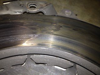

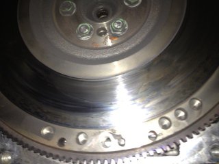

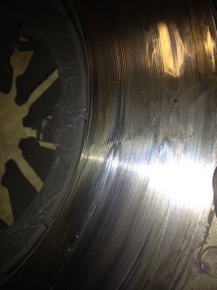

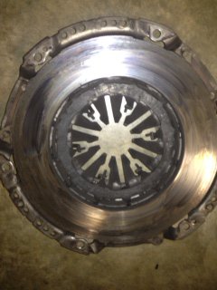

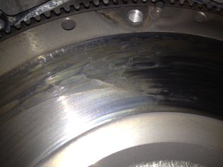

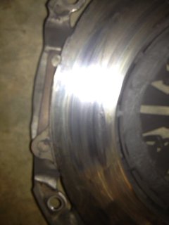

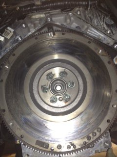

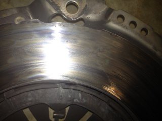

Been draggin' my LS2/240z, stock original 18k-mile 2006 GTO clutch, with slicks and as many posts have described, it stopped going into 3rd or 4th gear on high-power shifts. Around town it was still driving fine. After screwing with the hydraulics for over a week, I finally took the advice of several of you and dropped the tranny for a look around. Attached are photos of what I found. Most of the wear/deposits on the flywheel are in two places 180 degrees apart. Clutch plate looks fine by visual inspection. 1) what is the diagnosis? 2) Is this why I can't shift at hight rpm? 3) Can the parts I have be even temporarily fixed to get me thru next weekend's drag racing? I'm ordering a new aftermarket Mantic ER2 clutch system tomorrow, but I understand that it will have to be broken in over 300-500 miles. Even if new stuf is overnighted and I do a fast all-nighter assembly, I don't have time to do the break-in before next Saturday's planned trip to the strip with a friend coming from out of state. Can a pressure plate and flywheel be re-surfaced and re-used anymore?

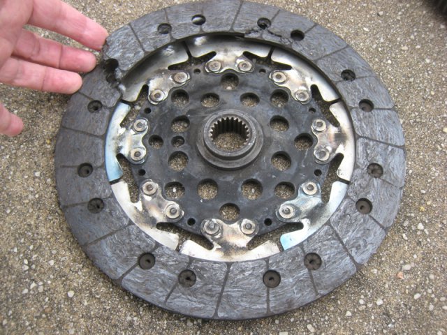

While I'm waiting on parts...What are the chances that changing tranny lubricant will improve up-shifting? I'm running Advance Auto Dextron III. Thinking about trying some GM synchromesh... Found this thread in a jaguar forum (see picture) sounds familiar-wondering now if this is what I'll find when I tear down: "Well, now I'm experiencing what seems like synchro bearing failure, and I'm wondering if that "clunk" wasn't just a precursor to what I'm dealing with now. The car has 92000 miles on it. The transmission will shift into every gear just fine while standing still. If I accelerate very gradually and shift at low rpms, the shifter will drop into place from gear to gear fairly quickly - just about normally - with just a little extra pressure from my shifting hand. As I increase the rpm of the shift points, I need to increase the pressure on the shifter or have a great deal more patience for the shifter to drop into place. That effect starts at about 3000 rpm. Much above 4000 rpm, it wont shift at all. Exuberant acceleration, like on a highway acceleration lane, "just ain't happenin'." -

Sunny, don't worry, I'm still looking at small approaches to the problem. I've ordered a speed bleeder for the remote bleeder line (I want to keep bleeding even though the pedal feels good), and I'm looking at different transmission oil (maybe synchros aren't working well with the cheap Advance Auto Dextron III I put in it. Anybody heard of a Mantic clutch? Dropped tranny last night: warped flywheel. Mantic ER2 ordered today from East Coast Performance. -
