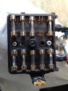

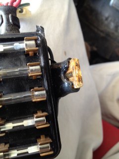

Found the fault: a melted fuse holder. See pictures. The first fuse box I had in the car (when I bought it 20 years ago) melted on one of the tail light fuse posts. So, I found a newer one and sent it to somebody 15-20 years ago for an "upgrade." Well, that external fuse holder melted. Somehow over the years, I had placed a standard fuse in the fuse block-that is why it showed volts on each end, but in fact, the green/white wire was no longer even attached to it! The green/white wire was attached to the melted externalized fuse-I was totally overlooking the externalized fuse in my wire chasing. I replaced the melted fuse holder today. After that, it was just a matter of putting the electrical system together. The gauges are still pretty dim, but the new rheostat is smooth; all the lights work. So, why did the wire get hot enough to melt a fuse holder? Maybe the burned contact in the combination switch? Maybe the marginal rheostat? There is a questionable ground on the left rear side-marker light according to my ohm meter, but the light still works - could that cause it? During re-assembly, I noted that my rheostat post has a little warmth to it... And, what' up with the dim instrument lighting? Any last suggestions before I get back to the dragstrip? Edit: the missing fuse is for my missing windshield wiper motor.

Another stupid question. I see some test light probes that are sharp enough to poke thru the insulation into the wire. What's the party line on that? Is it ok to poke thru the insulation, or do you guys always go to the end of a wire segment at a connector to check for voltage/continuity? I'm betting it is gonna be a connection, I'll find it or be damned! Yep, checked bulbs. Hazards work.
Thanks everybody. Checked rheostat, checked switch, now I'm trying to go thu each light bulb now. Weird thing is that I'm not popping fuses... Question: If there is a short in the green/white wire in the section I am checking, that wire should have zero volts and continuity with ground, right? ..instead of 12V? Sorry, I made a C- in electrical engineering 30 years ago, I really struggle with the basics. Getting close to towing car to an electrical shop, but that would be so lame...
bjhines- Lets assume it is a side marker grounding out: What is the fastest/easiest way to identify the offending side marker (I worry that disassembling each of them, cleaning and reinstalling could be inconclusive too). If I disconnect each side marker one at a time with the swith on, should the lights turn on as soon as the offending light is disconnected?
BJHines-thanks for your advice. I have replaced and checked my rheostat: both the old one and the new one are good (the old one has some spots that don't work good, but all in all it was OK). I rebuilt the headlight switch per a thread I found: it was ok too. I guess the fact that my fingers were adjusting the rheostat when this all went down was just a distractor to take me down a lilly path to nowhere! Now, it is on to the rest of the circuit. You said you'd been thru this twice before. Any advice before I move thru the harness to the marker lights (it had just rained like a mother right before the lights went out). How were your side markers grounding to the body? I haven't disturbed them in years - it was 20 years ago that the car was last painted! I'm a real idiot on electrical stuff, so please use short words and be as specific as possible. With the headlight switch in the OFF position, the green and white wire has 12 volts. If I switch the switch to the Running Lights position or the Headlights position, the voltage on the green and white wire drops to zero...does that mean that there is a short or an open somewhere?
