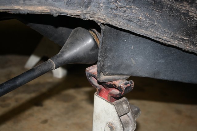

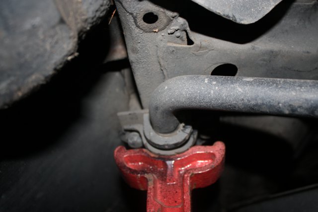

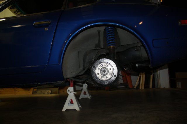

Lack of strong places to put a jack is a real deficiency of these cars. My car is about 5 inches off the dirt at the rocker panels, so much of the undercarraige is less than 3 inches from the floor. I have an airdam, so I can't get to the front crossmember (which is the strongest part of the whole car). I use a $59 Hargor Freight aluminum low-profiile jack and I have padded the handle because I have a knack for smacking my paint with it. For the back, I jack from the differential. For the front, I have to turn the front wheels away from the side I'm jacking, then I place the jack on a little flat spot under the TC-rod mount (about the only heavy steel on the frame rails. My frame rails have little bends all over them from prior owners jacking and bending; the metal is too thin. I then place my jack stands under the front cross member with a 2X4, then let the car down and start swapping the location of my jack and jack stands until I have a jackstand on each TC rod mount (takes about 15 minutes to get car on jackstands). On the back, I put the jackstands on my swaybar mounts. I just picked up some 1/4 inch steel to make jack plates on the front frame rails so that I can start jacking the car up quicker. I would not jack from the rocker panels on a car with paint that I cared about; mine were all kinked up from previous owners before I replaced them. Watch your jackstands for tipping and reposition them as you go with a rubber hammer. If you drop the whole rear suspension as a unit while the engine is in the car, you will want some extra jackstands under the front crossmember. When the suspension comes down, the weight of the engine will lift your car right off the rear jackstands and you will either drop your car or pee your pants while holding down the back of the car and screaming for your wife to help you. Of course, that has never happened to me....and of course it wasn't at 3am on a Sunday night in a pouring rain. -

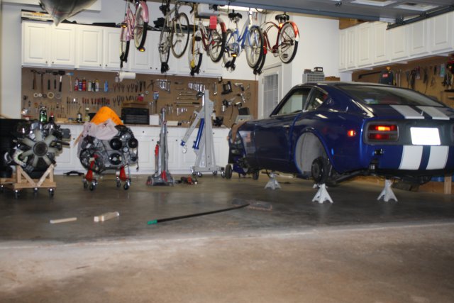

L24 is out and on rolling stand; Have LS2/T56 on rolling stand with camaro pan/windage tray/dipstick installed. Have A/C and P/S off. Used a neat dummy power steering pump from nookandtranny.com that allows me to use original serpentine belt (With the simple ribbed idler pulley replacing the smooth one, I was afraid of the proximity of the belt to the lower alternator bolt (even when I ground the head down to 11mm). So, belt system is all squared away. Have installed JCI front mounts, but having trouble with long mount on driver's side (too tight in the Datsun engine mount tower-will need to grind some off spacer washer or JCI mount). The little TC rod cup washer is pretty rusty and seems kind of pointless (do I weld it or epoxy it to the JCI mount?) - so I'm probably going to buy some adjustable TC rods that will replace the rubber bushings with a metal bearing. Mr. Coffey says I need more caster, so I'll kill 2 birds with one stone. Have relocated driver side brake line and as I HATE brake fluid, I'm going to get all my brake line relocating done next to have that behind me. Anybody object to my plumbing front and rear brakes directly from master cylinder and eliminating the little housing that turns on the brakes idiot light - I haven't had the wire connected for 10 years and I don't think it does anything else)? I have cut/ground out the tran tunnel ears (I still can't hear and can't get thru airport security). I'm trying to work up the courage to cut off the throttle linkage on the firewall since I'm using the DBW pedal. All this cutting is pretty hard on me..this car has been my baby for 18 years and I feel like I'm cutting out it's soul. I know it sounds funny, but I spent a lot of hours getting the stock throttle linkage to work perfectly with my triple sidedrafts and now it is in a cardboard box; the custom stainless exhaust I pulled off the car was beautiful. My modified 240z tank is about half finished. I took some pics of the inside of it before the fabricator closes it back up. I should be done sometime this summer. Appreciate all the expert advice the forum is giving me - priceless. Plan is to assemble everything for a test fit and then pull it all down, paint and reassemble. The coating on the JCI stuff looks like it will be rusty very quickly and I figure I'm going to spill a lot more brake fluid before this is all over. Taking LOTs of pictures hoping to contribute to forum. -

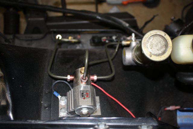

I searched for a thread on this and can't seem to find one. This is for drag racers or folks who just like to burn tires. Here are some pictures of my line-lock roll-control system on my 72 240z. I use it primarily to control movement of the car in the burn-out pit. Car has manual trans. I got the Hurst system from Jegs on-line. The system is actuated by pushing hard on the brakes, then pushing a momentary switch on my shifter handle; this locks fluid pressure in front brake lines. I can then release the brake pedal and do my burn-out. Release the button and the brakes again work normally. Little light on dash tells me system is engaged. Pics attached. Open to questions. Looking for in-put on how to install a 2-step rev limiter for LS2/T56.
