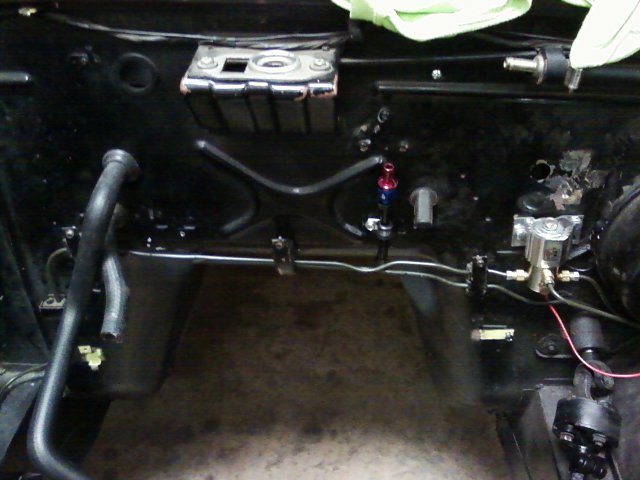

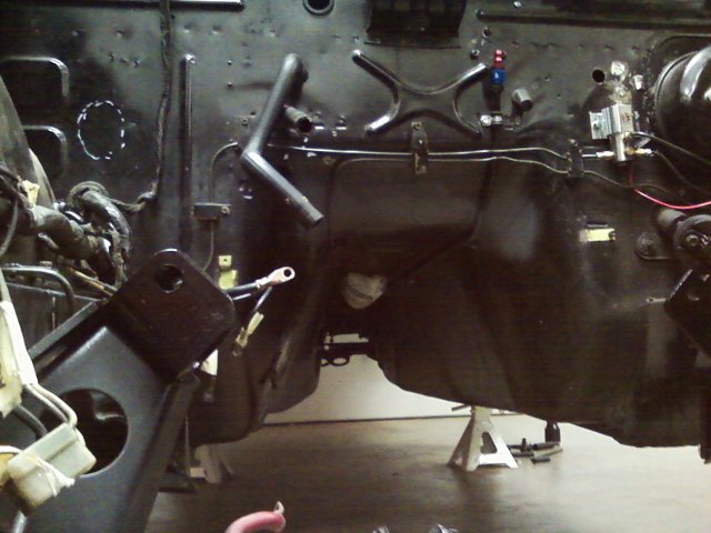

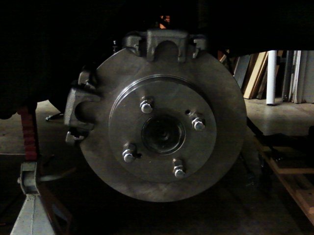

Cleaned garage and organized boxes of parts into categories - I was getting disorganized. Gave away a bunch of L24 parts I don't need anymore to a friend who came over and helped out. Hard fuel line is in, running thru trans tunnel and is awaiting a motor at one end and a fuel tank at the other (see pics). Rear disc brake setup is all painted (see .Drifting Hydraulic Handbrake thread) and awaiting reciept and install of 280z stub axles to replace my bent 240z stub. Front brakes and suspension are totally complete. Cable e-brake handle and cable are installed; went ahead and swapped sides for the cable anticipating the need for shorter cables to go with the disc conversion. Transmission tunnel spot painted in primer. Fuel tank is to be ready Tuesday to be picked up at the paint shop; will wait to install it until stub axles, diff and axles are in place. . Radiator is on the wayThought about going to extended wheel studs, then reconsidered because I have 4 sets of wheels all requiring special nuts! Spent another $350 at Summitt.com on odds and ends; I should have everything ordered except exaust tubing (mandrel bends} and wiring suplies. I've stopped keeping reciepts and keeping traci of expenses. -

Cleaned garage and organized boxes of parts into categories - I was getting disorganized. Gave away a bunch of L24 parts I don't need anymore to a friend who came over and helped out. Hard fuel line is in, running thru trans tunnel and is awaiting a motor at one end and a fuel tank at the other (see pics). Rear disc brake setup is all painted (see .Drifting Hydraulic Handbrake thread) and awaiting reciept and install of 280z stub axles to replace my bent 240z stub. Front brakes and suspension are totally complete. Cable e-brake handle and cable are installed; went ahead and swapped sides for the cable anticipating the need for shorter cables to go with the disc conversion. Transmission tunnel spot painted in primer. Fuel tank is to be ready Tuesday to be picked up at the paint shop; will wait to install it until stub axles, diff and axles are in place. . Radiator is on the wayThought about going to extended wheel studs, then reconsidered because I have 4 sets of wheels all requiring special nuts! Spent another $350 at Summitt.com on odds and ends; I should have everything ordered except exaust tubing (mandrel bends} and wiring suplies. I've stopped keeping reciepts and keeping traci of expenses. Sorry about the duplicate post-I fell asleep in the chair and my finger hit the send button before pics were attached. -

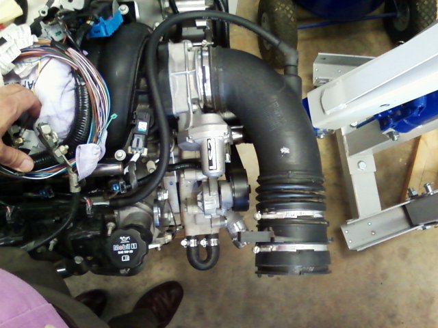

	Here is what I have so far. Engine is LS2 from 2006 GTO. Flipped the snout (4" diameterto) around toward passenger side, connected valve cover vent with 3/8 rubber hose running across throttle body. Cut out a section of the accordian section of the ductwork (3.75" diameter) and pushed it together which made the baffles interlock together really tight. I may try to squeeze some silicone adhesive into the attachment. Then MAF sensor. Will get a reducer from siliconehose.com to reduce from the 4" MAF outlet to the 3.5" JCI metal tube. Will fashion a welded flange for 3.5" JCI tube and trim out the radiator support hole to 3.5". Will use 90 degree bends from JCI. Total additional cost will be for silicone hose reducer, welding of the flange and an airfilter. Thanks for the pictures and imput.

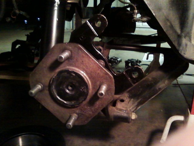

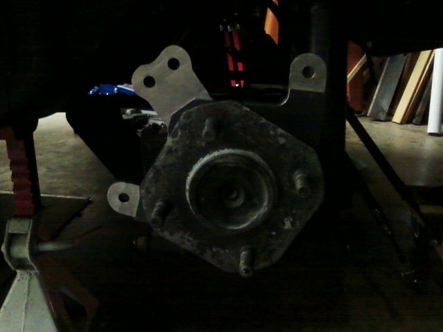

Got brackets back from machinist today. He somehow let the template twist a little before drilling the holes to bolt onto the hub, so the clearance between the cable parking brake and the strut tube is just closer than I had hoped for. I think I can clearance it by trimming a little material off of the cable bracket. My drawings were such that the lower caliper would be level with the ground. I got jacked pretty hard on the brackets - $1000 total for both prototypes, but that is life in a small town with few machinist options. I would have to find more cost effective option if I was an entrepreneur and wanted to manufacure these. I need to find one brake hose that is 1 to 2 inches longer, and I need to move one of my brake hose-to-frame brackets up a little to complete the plumbing, but I think this is going to work. Pictures show the starting Maxima set up, then the double Maxima set up. I'll start painting parts Saturday then there will be a delay while I wait for new stub axles to arrive, get new bearings pressed and re-install. -

	I am having some custom maxima brackets made up (see drifting hydraulic handbrake thread). If you are not in a hurry, I could sell you my old ones. I have one that is uncut and requires either cuttting or removal of the stub axle. The other I have cut to allow mounting with 3 bolts without removing stub axle. I could cut the other one as well. These "old" brackets have only been used to mock up the conversion and are not even dirty. My new brackets should be ready Thursday and I should be able to mock them up over the weekend to ensure that the new brackets will work.

JCI mounts and steering shaft painted and installed for final (I hope). Radiator, fans and shroud ordered to ship Monday. Finished bending up solid fuel line (major PITA); headed Monday to get AN fittings welded on both ends. Fuel tank re-sand blasted and delivered to paint shop for shiny black paint (on the outside). Rear disc brake calipers are at machine shop ready for pick up. Just gonna clean up garage today and get an order off to Summitt for fuel fittings and high pressure hose. -
