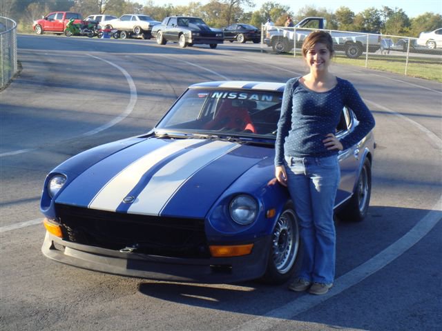

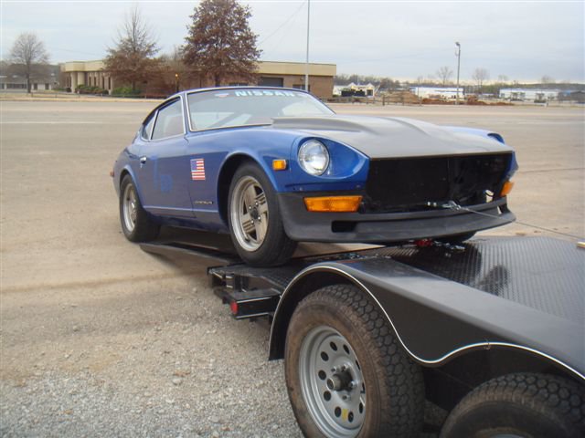

I am about to start the project of putting an LS/T56 in the 240Z I have owned and worked on for 17 years. This is a street-legal track car that is shiny on top and bottom, but gets driven very hard at events. I'm looking for a mentor who has done one or more LS swaps. I will buy an engine/trans drop-out in November and start collecting parts, hoping to start hard into the swap in January. I want to do a straight-forward, clean install, hoping to keep it as simple as possible with the goal of being at the local drag strip in the Spring with drag/autocross throughout the summer. I want to keep it simple and avoid making avoidable mistakes and spending money on things that really don't matter, but I don't mind spending money to save time and aggrevation. Clean fit and finish desired. Body, interior and chassis is already sorted out. I want to alter my stock wiring and fuel system as little as possible. No posers, punks or tire-kickers, please - only answer posts if you know what you are talking about.
