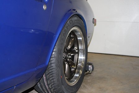

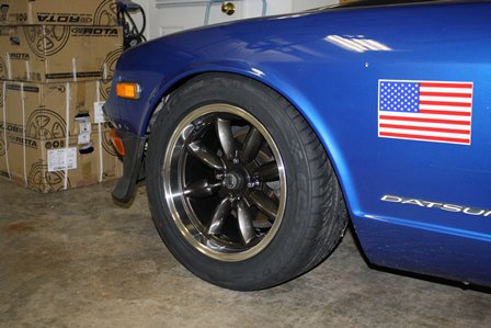

	  Wheel Show! Post your pics of you wheelsRebekahsZ replied to k3werra's topic in Brakes, Wheels, Suspension and Chassis 225/50/16 Kumos (cheap) all 4 corners. EMI camber plates in front with 3 degrees camber-plenty of room all the way around. Rears have no camber plates, but have them in a box to install-wheels would scrub on outside of fender at a good sized bump without them. I think a few degrees of camber will solve the problem as it moves top of the tire IN. Will get to it when I get car off jackstands on this infernal LS2 swap! Thanks for the compliment.
