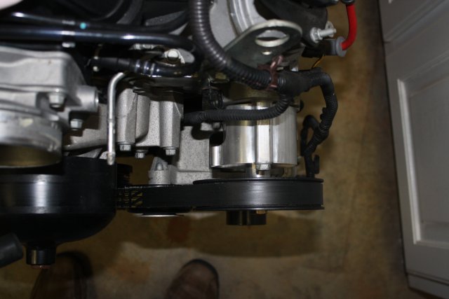

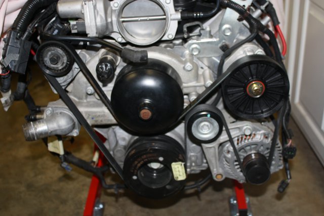

	  LS1 Alternator Bolts to Belt Clearance IssuesRebekahsZ replied to SUNNY Z's topic in Gen III & IV Chevy V8Z Tech Board I tried grinding down the bolt head to a 11mm hex size, but the clearance was still too close for me. I solved it by installing a LS1 dummy power steering pump from nookandtranny.com. It was pricey at $178, but it is right and i won't worry about it any more. 1tuffz has a great solution listed above and i would have probably done it that way had I known about that method. I'm not in love with the clearance between the plastic valve cover vent tube and the factory idler pulley.

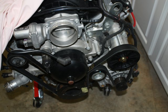

	  LS/T56/240z Project Mentor WantedRebekahsZ replied to RebekahsZ's topic in S30 Series - 240z, 260z, 280z I am having trouble with the alternator clearance, just like many people. I've searched the forum and found the 2009 thread opened by Grenade. I have aggressively cut down my datsun engine mount tower and the JCI inner and outer driver side mount brackets, far more than what mnoel had to do (maybe a 240z/280z difference?) and that pretty well took care of the front-to-back clearance problem. However, my LS2 alternator is ON the steering rack adjustment housing. I can get a Camaro alternator, front bracket and rear bracket pretty cheap, and the camaro alternator APPEARES smaller in all dimensions, although I haven't held one in my hand. My 2 questions: 1) will the lower amperage of the Camaro alternator interfere with my use of the LS2 GTO wiring harness and computer? (There is no info on this issue on LS1tech.com either). 2) is the camaro alternator really any smaller in diameter (top to bottom) than the GTO alternator in such a way as to get my alternator off the steering rack?

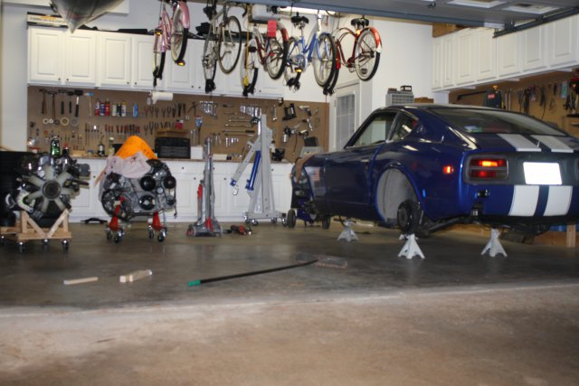

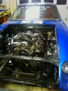

	  LS/T56/240z Project Mentor WantedRebekahsZ replied to RebekahsZ's topic in S30 Series - 240z, 260z, 280z Engine and trans are completely suspended by JCI mount kit. Still lots to do, but I wanted to share this pic with everybody who has been helping me on this thread and others. Slow progress, but progress non-the-less. One pic shows car up on jacks, one shows engine in and installed on JCI mounts, next is the modified 240z tank modeled after the dirty and rusty 280z tank. There has been a lot of discussion about the "baffles" in a 280z tank. The 280z tank basically has an internal sump. Now my clean 240z tank does too, and excessive venting removed and an 0-ring sealable access hole large enough to clean tank and even install fuel cell foam if I wind up needing it. I'll author a fuel tank thread that might be sticky-worthy when the car is on the ground and running. Taking lots of pictures for a build thread that discusses all the hiccups and mods that I've had to make. My best tools for this project are an angle grinder and a sledge. Thanks for all the support; more to follow. Keith
