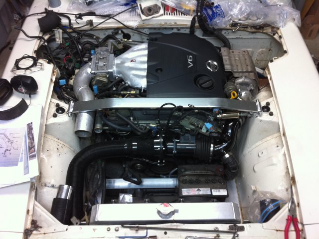

  3. I have made a brace for the front of the motor for the damper. Manifold is nearly finished and last photo is how engine bay is coming along, I have to make the strut mounts for the strut bar and engine damper.

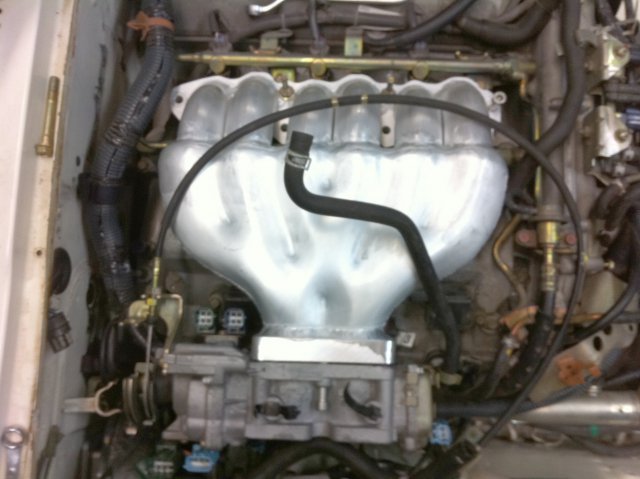

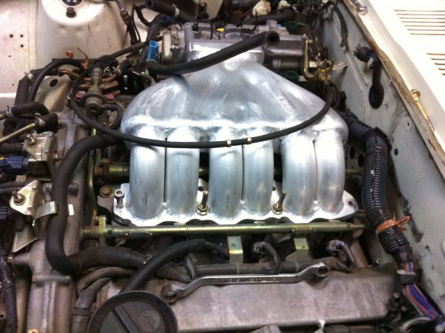

  9. Back from welding the plenum is not attached, I have cleaned up the welds on the top of the plenum and also machined the bottom flange to take out the warping. Next I have to make the flange for the standard twin throttle body. I will show more pics as they come. Rob
  10. Here I have assembled the runners and both flanges ready to be welded. Now it is back from welding. Then I cleaned up the welds insde the runners.
  11. Here I have trimmed the two halves and had them welded together. Here the plenum it trimmed at both ends. Here the end plate for the plenum as been made.
  12. I made a female die for pressing the outer shape of the plenum. I heated the aluminium plate of anneal it before putting it into the press, here you can see it pressed part way through, you have to take it out a different stages to re-anneal. The outsides of the female die were made with a 3 stage hole setup so that you could start with the widest setting first then bring them closer with each pressing to achieve the shape. It is a difficult shape being more than just a compound curve. It was then put into a vice so that I could hammer the last part to get the aluminium as close to the form as possible. Here are the two halves of the plenum pressed.
  13. I have made a male die for pressing the Plenum.One side is from hardwood and the other is 13ply with alloy formers. I first pressed a plat sheet 3mm thick using the middle alloy former only so that the center would form more easily. Then I would press again with the next former each side of the center one and so on until I had formed the shape into the top of each sheet (one for the top and another for the bottom of the plenum)
  14. I have cut the runners to the length needed and recessed them into the bottom flange about 3mm. This is a plan view of how the plenum will look.

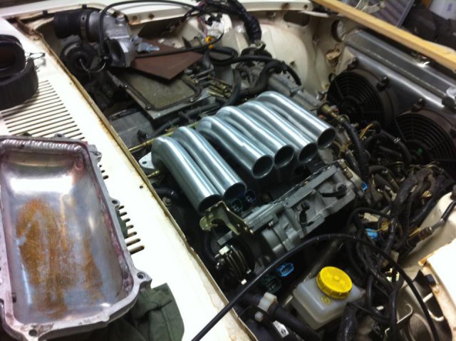

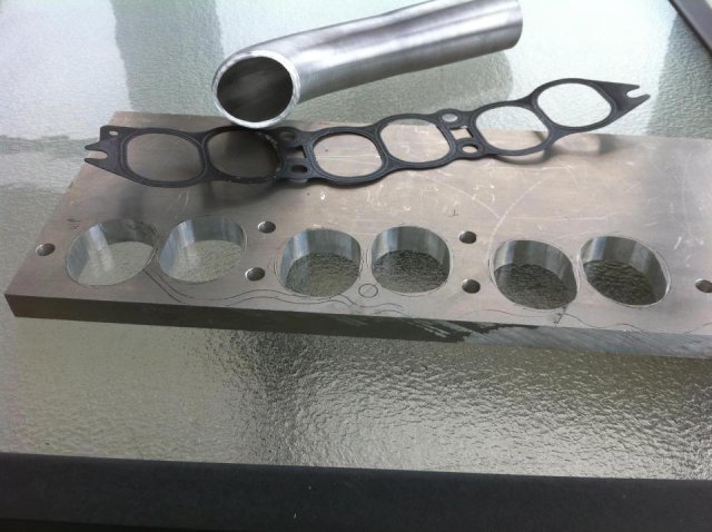

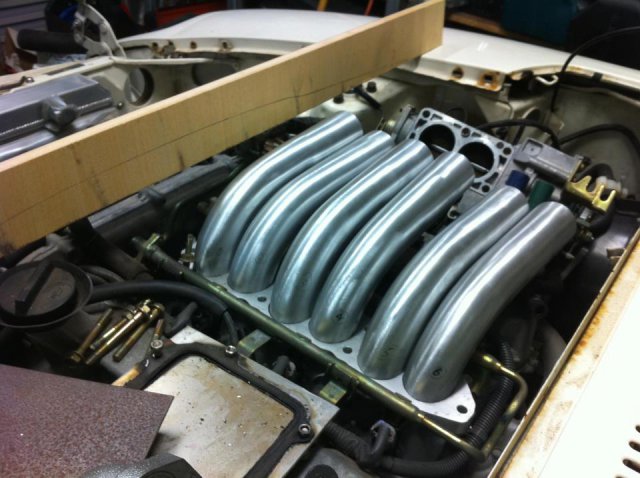

  18. I have decided to start on a new inlet manifold and have made the flange from 15mm thick alluminium. The tubes were cut in half 180deg bends, these were then squashed slightly in a press to make oval, wall thickness of the tube is 3mm.

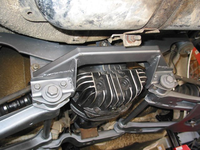

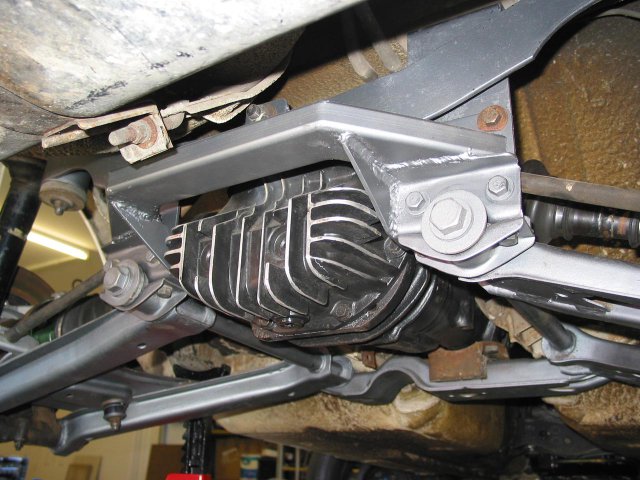

  22. Here are a couple of pics of what I did, not overly pretty but should be strong enough. Rob
