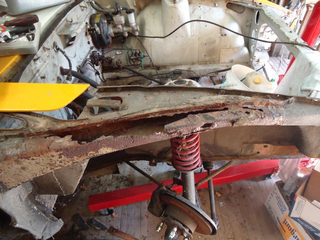

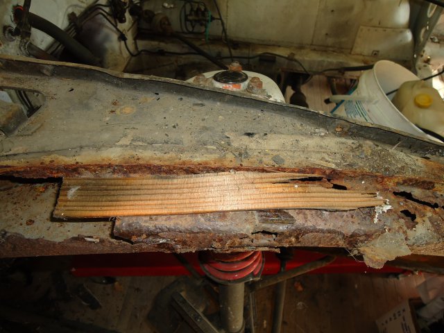

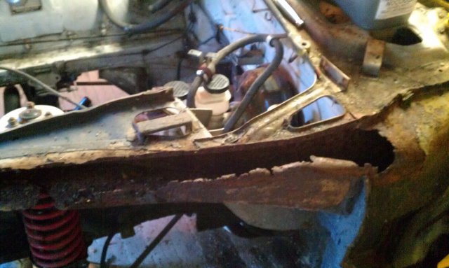

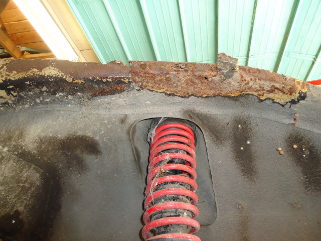

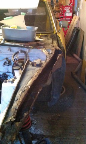

Thanks for the offer PR280z but I don'd imagine shipping 2 large pieces of metal from Puerto Rico to western Canada would be cheap. At this point I'm looking for another shell semi-locally or doing a tube frame front end.
So I took the drivers fender off to see what secrets that would reveal and...well... I am going to give the rest of the car a once over for any more bad structural rust and if there's any there then I'm probably going to scrap it otherwise I think I will attempt a tube frame front end.
Sorry, no progress to speak of...I have uncovered some serious rust issues and am trying to decide if I should attempt repairs before moving on. The project is still alive, just hibernating until more time/funds become available.
The sheet metal in the engine bay has a few patch panels (some welded, some riveted), the main frame rails have some 90deg sheet welded over them, the floors have been replaced etc. The car has definitely had some work done in the past but most of it is in the open and no rust is showing through the paint or anything. There doesn't appear to be any patches in the rear of the chassis although I wouldn't be surprised if the body was full of bondo. Its going to be a autox car for the most part so it doesn't have to look pretty, I just want it structurally sound.
Wanting opinions on my current discovery. PO had patched with an awesome combination of fiberglass and bits of cedar shingle to fill the gaps which was all undercoated over, hiding everything. Think its worth patching in new metal? Also half way considering a tube front end...other ideas?
