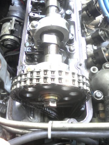

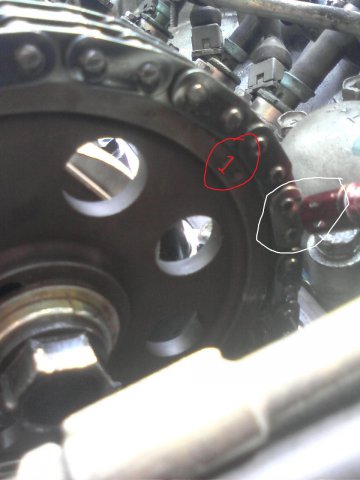

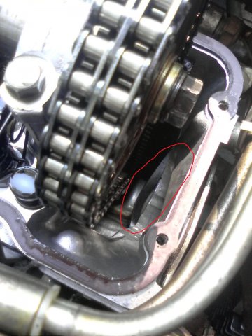

Took it all off, wedged the chain etc. Here is a direct link to all the pictures i took (23 pictures, too many for here) of the block deck with the gasket on, then the block deck with the gasket off, then the head on the manifold side, then the head on the underside etc. Engine Tear Down Pictures Make sure that you read the title on the pictures, and the description below the picture to best know what your looking at if you are not sure. I did try to organize them as best as possible, click to enlarge them. One thing i want to mention is the most coolant found was in the center of the head and block. It is where coolant was found puddled on top of the pistons and most on top of the gasket surface both on the engine block and on the head. (Do i want to dry that out right now with a paper towel, and then apply some oil to the cylinder walls after wards?) I am unsure of how to clean each different surface accordingly. Look at the pictures if you would and then give me some comments on how they look please.
The rust on the cam lobes wiped off kinda easily. Did not wipe it but once or twice and some rust came off. Should be getting everything else off this weekend.
