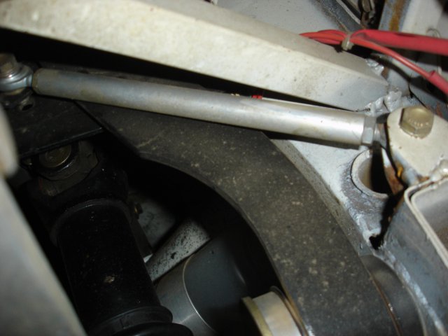

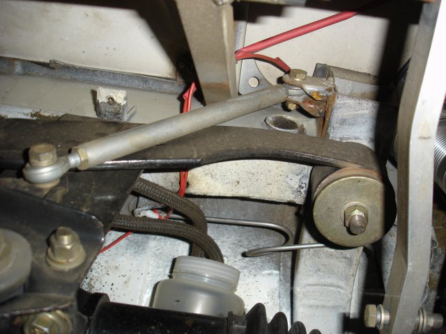

I finally got to the shop for those photos. These brackets go from the outer frame rail down to the rear suspension inner pick up point area. Hope this helps. Sorry for the less than stellar photos. Alan -

I looked up photos of your car to see the rear suspension. Are you sure all of the extra bolts on the mustache bar and lateral connector are tight? I run some additional tubes with rod ends from the frame rail down close to where the back of the control arm bolts to the plates coming down from the top. They come in at about a 45 degree angle when looking in from the rear. I did this to more firmly lock the whole assembly in place side to side. With all of the aluminum parts there are extra fasteners. Make sure they are all tight. Maybe even paint the heads to make sure something is not happening with heat. It will be interesting to see what Koni says when the shocks come back. Alan -
