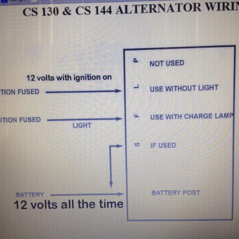

Life got in the way today, no car time. But, was calling all the hot rod and electric gurus I know and apparently my car not shutting off is a combination of a new chassis harness and my CS 130 alternator. I was to add a diode or "idiot light " on the alternator exciter wire #914 for painless and for my harness it is wire #14. I did a search on back feeding alternators and this is a common problem when you upgrade the harness and upgrade to a cs130 alternators. Try get in garage and test it out the theories. -

Gentlemen I am reading what you have posted and looking at manuals and the connections on the car. I have a CS130/144 Alternator with a battery lug and also a pigtail connection. On the connection end of the pigtail there are two male spade connectors. The instructions were to connect the alternator exciter based on two options. 1. 12 volt ignition fused when not using indicator lamp 2. 12 volts ignition fused when using indicator lamp. I use #2 ? When we were doing the wiring I did not have the Autometer volt guage, the stock volt guage was still in dash? Rags, the the exciter wire originates from my fuse panel harness and I agree there is back feed. From the LS1 pcm harness (Speartech) I only had to make connections for gray wire(fuel pump) orange wire(battery), and pink wire (ignition). I am going to test your theory. Rsicard, fuse panel and switch is fused just as you pointed out and the wiring is heavy guage. Could it be as simple removing the connection from #2 to #1 ? Keep them ideas coming, jumping on it first thing in the morning. -

I think my problem may be the Longacre heavy duty harness. The two yellow wires branch off, one tied into accessories, the other yellow wire connected to pink wire for ECM. But, there is a green wire in the harness that is connected to the starter solenoid. This may be problem. -

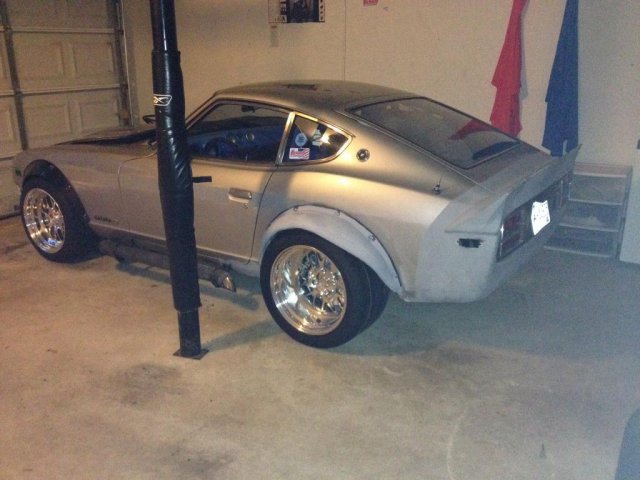

Made a bit of progress and moved the Z from my Dad’s garage to my garage. I had already gone through with re-torqueing bolts and checking for leaks. I knew the electric would be the area I would need patience with. So with a power probe I checked all grounds and then all hot wires and everything was good. But, NO START!!! I do not have a key ignition (key is just there to lock steering wheel). I have a race car panel with toggles and a push-button start, and looking at diagrams for wiring a LS1 with toggle switches, separate fuse panel and a battery disconnect, I have an idea where I made a mistake. Two days after this photo I had hernia surgery, so I want be working on the car for a few weeks –but I can’t wait to get back on the Z.
