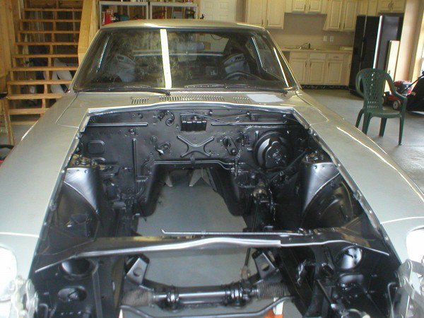

RebekahsZ, I am watching your build trying to get motivated !!!! I have a 77' 280, and I am utilizing the area where the stock intake went. The core support had a hole that was a bit tight, so I broke out the dremel with a small grinding wheel and went around the whole circle until the aluminum tubing fit through. On my list is to take some flat stock shape like a " L " and make some support brackets if it the intake needs more support.
I do not know if there is a difference between the 72 240 transmission tunnel and a 75-78 280 transmission tunnel, But I will tell you on my 1977 280, I had to take out the BFH (BIG F****HAMMER) to the tunnel on the passenger side for clearance and to have the ability to reach your hand up and over to plug in the ECM harness conector to the 4L60E. Also, the area I had to massage was just below the passenger firewall, were the bellhousing and engine connects. Before, I drop the engine and transmission in, I had did some banging in the tunnel but it was not enough in the right areas. I hope to get back on mines in a month, if you need a photo I can head over to garage and get a picture for you. Glenn A.

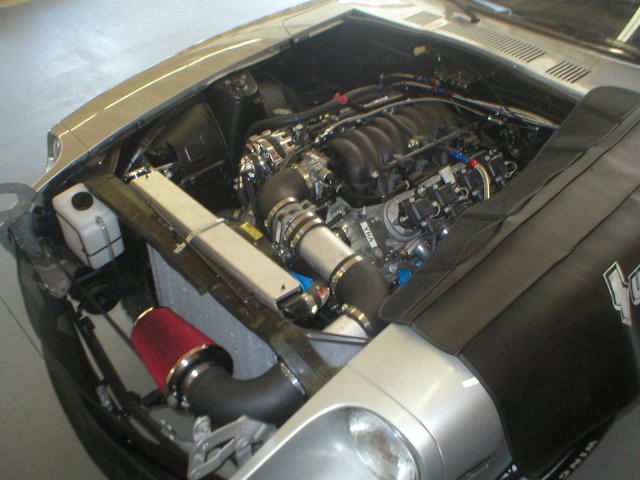

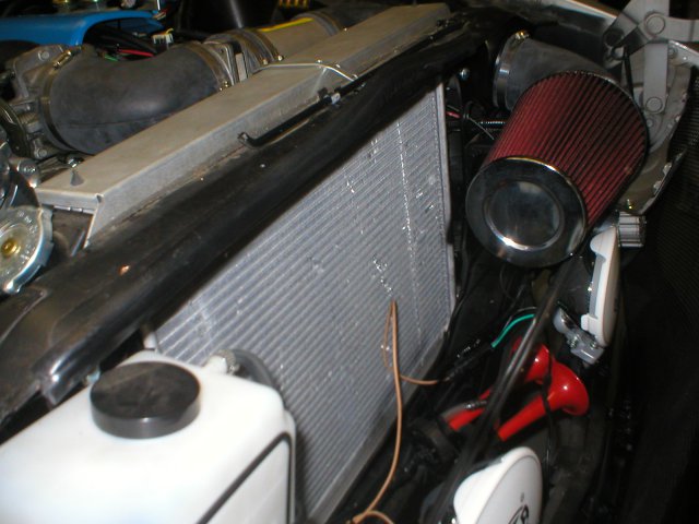

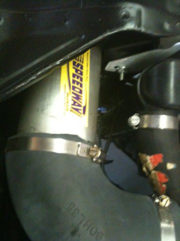

Scott, That part is the aluminum tubing you will receive in your JTR ducting. I have some better pictures attached. -

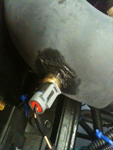

Scott, I have the JTR intake, I bought the filter on ebay and I knew I needed a filter to fit 3.5 inch tubing and I used the picture on the JTR website as reference for the shape and size of the filter. I drilled a hole for the air temperature sensor with a drill bit the size of the sensor and sealed around the hole with silicone sealant. Test fit everything in place and mark your location were you are going to drill for sensor, and do your drilling on your work table or bench so you can clean up the shavings before you install everything back on the car. -

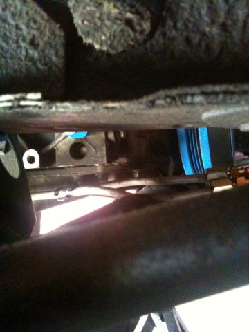

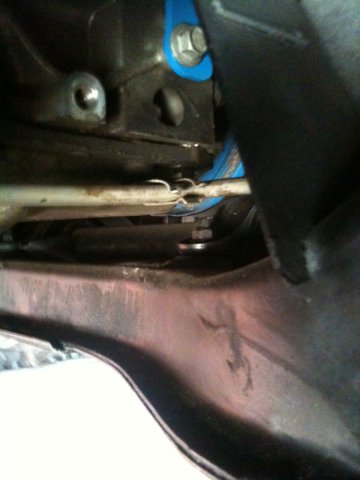

I read your post, and did not have MAC Book due to system crash and repair. Good thing, did not lose pictures and I have everything backed up, The clips bolt into tapped existing holes. I have to rev-visit my hard-lines and bend them up away from the steering rack. Pictures attached rotate to the right, in the first photo the balancer is at the top of photo, and the second photo you are looking from behind the passenger tire. -

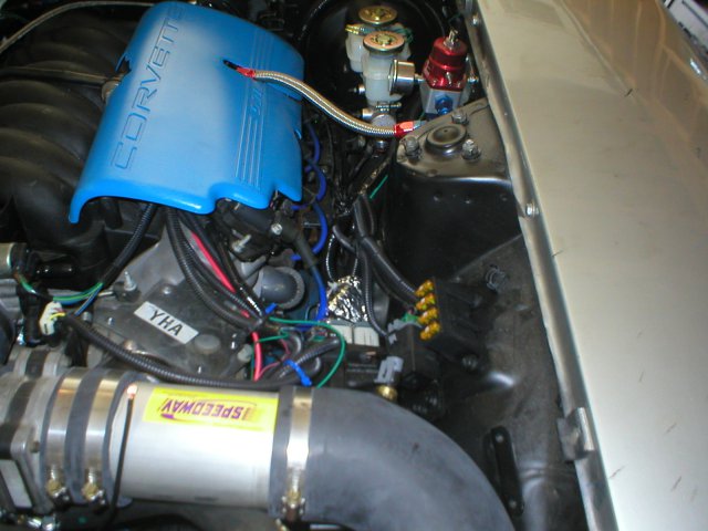

David my fuel delivery is similar to yours. I hope you do not mind, as I use that picture to figure out the placement of the FPR. KTMP, ask for the part number to the 99 corvette filter/regulator, which I discovered after I had installed my fuel lines, filter, regulator and pump. If I was to do it another LS1 /Z swap -I would go with the 99 corvette filter/regulator.
