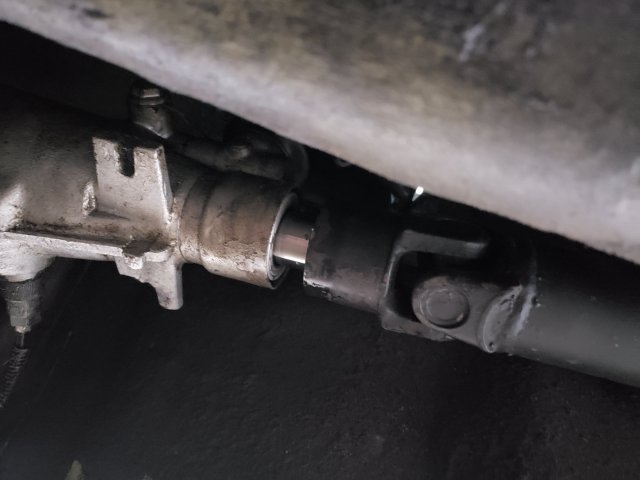

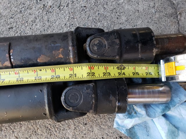

  3. I am bringing this back from the dead as I am now digging into a vibration that I'm experiencing at anything above 60mph. I pulled my driveshaft and am getting an aluminum one made with spicer joints. Diff flange to rear of trans is 24" on the dot. I have already dropped off my old DS, and when it was installed it was snug, so the DS shop suggested a slightly shorter by about 0.25" I also looked into the actual alignment of my driveshaft using a laser level. The cross is about 0.75" off from center, which is just under 2*. I think that's fine, but someone please let me know if that's too much. Lastly, some general problems I have with the T3 kit after using it for 4ish years. The moustache bar hits the spare tire well, to the point that it's dented the metal. Below are the pictures, which most people don't see. It is keeping the diff inline though which is nice, but the spacing could use some work. The RT mount with a snubber also seems to have an issue that I just noticed since digging into it as well. Due to moving the diff rearwards, the snubber is now contacting the rotating pinion flange. It seems to have self clearanced, and when everything is snugged up I can still turn the flange by hand albeit with a little strength needed. I can't move the RT mount further backward due to the lip on the metal, I would have to drive that away to do that, I may try that and instead of the snubber, I will use the GM bushing that bolts to the diff. I am also going to change the front diff mount out for a T3 piece as from what I've read there is some slotting to be able to move the diff and align it better. I have recently also started the swap of my Koni struts into the strut housings, so I will post progress on that. I'll be getting new top hat bushings since one of mine just split in two when I was taking it apart, but I am essentially going through all my rear suspension at this point. The koni yellow 8641 1031SP1 is the same length and fit as the Tokico BZ3015 which is historically the strut people would use when they section the rear. I will report back with the fronts, it should be a 8641 1142 koni yellow vs a tokico BZ3099. The difference is the gland nut provided by Koni, the tokico has an inner ring that won't fit in the strut housing with the strut.

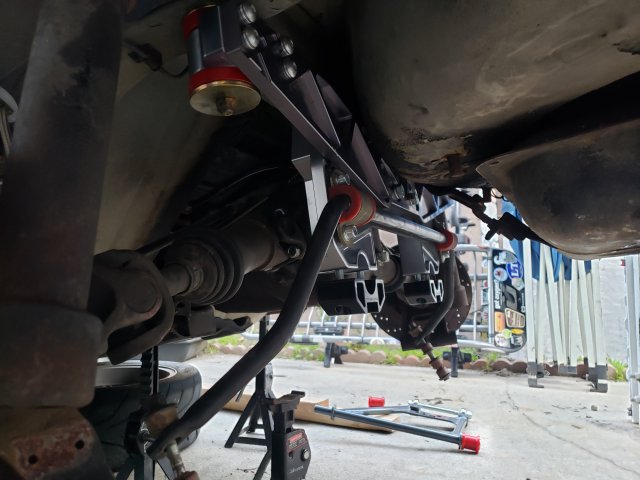

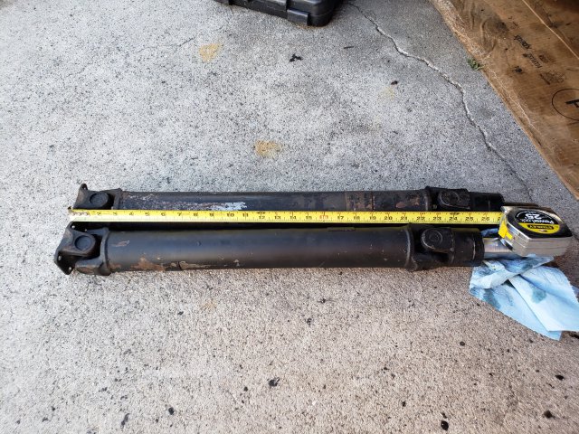

  13. The driveshaft is from a 72 or later S30 Z (as long as it had a manual trans). The biggest thing is to check the length, which I posted pictures of. I did try flipping the T3 mustache bar, but the drop mounts would not line up. That was before I even got the diff lined up, so it was an immediate problem. The T3 bar is meant to be mounted more towards the gas tank. It's a fairly tight fit with all the T3 stuff. I'm bringing the car to get aligned this week since I just eye balled the toe everywhere. Will have first impressions of the drive after this weekend.

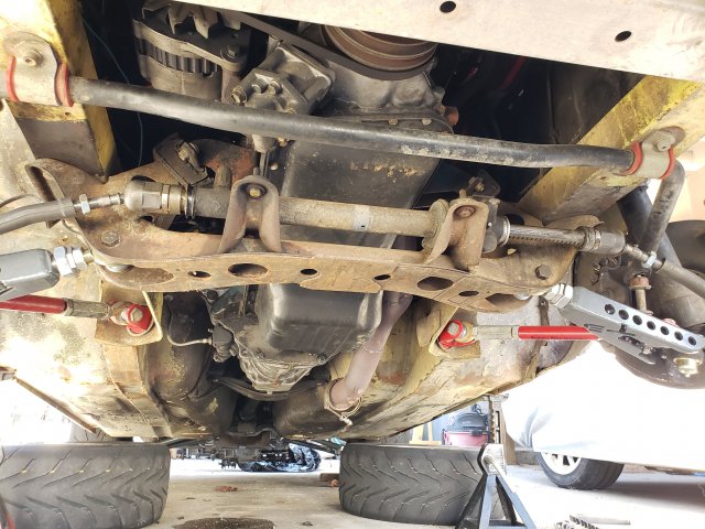

  18. Doing the fronts now. Small problem I ran into was the T3 front control arm ball joint bolts were longer than factory and therefor I couldn't just bolt the strut back onto the steering knuckle. I had to buy some bump steer spacers/roll center adjusters, which was no biggie since I probably needed them. Also could not get one tie rod off and the new outer tie rods I bought are both right hand threaded. My driver side inner tie rod was left hand threaded and crusty. So I got some new inner and outer tie rods. along with a solid steering rack bushing and poly steering rack mounts (still have to put those in). Also got the later and longer style driveshaft.

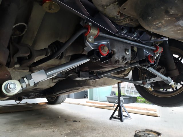

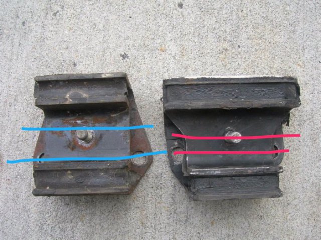

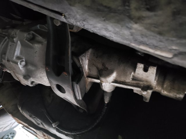

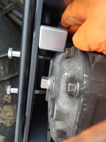

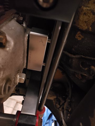

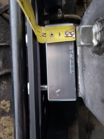

  19. So I got it all in, I did have to flip the diff mount (move the diff position backwards aka the later style) and I had cut the spacer down to 15/16ths and buy some new length bolts. Here are the spacer pics when I had the diff in the stock, forward 1970 position, notice the amount of "slack" in the spacer to diff cover vs when I rotated the lower diff mount 180* forward to move the diff back to the 1972 position: And this is the final product. I need to get it aligned still, but I have work on the front also Here is are some bonus pics of the Trans mount (type 2) that I will be replacing with the T3 KA trans mount (when I get the trans rebuilt) And here is the amount the driveshaft pulls out. My driveshaft measures 21 1/8 inch from u joint center to center, so I'm looking for the longer 22 1/4 inch. I have a few leads, but need to pick it up. Final plans are to go with the Ka transmission with a converted L bellhousing, T3 KA trans mount, T3 front diff mount and the "power braces" they sell. The front is getting T3 arms and TC rods, and new tie rods. Eventually I'll get the steering rack rebuilt and put in new bushings and a solid steering knuckle. Then I think the suspension will be done.

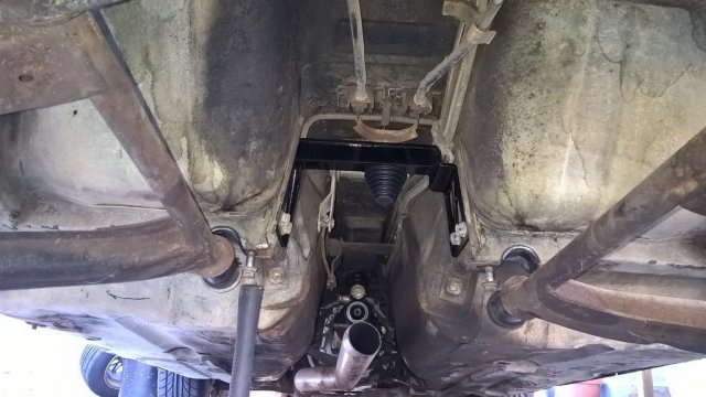

  20. I had an SR20 Swap done on my 280zx by Touge Factory in Chicago about 2 years ago. They put the car on a scale when they were done (they got the car without an engine in it) and it was at 2460lbs. All the same things as above apply, except I had some roller steelies on the car, it did have a front bumper since my Gnose was obliterated by a brick on I-10, and I did have my whale tail on.

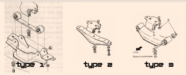

  23. I do have an RT mount, but I'm not sure what you mean by snubber on the bottom? My mount was bought from Technoversion and has the 3 bolt holes.

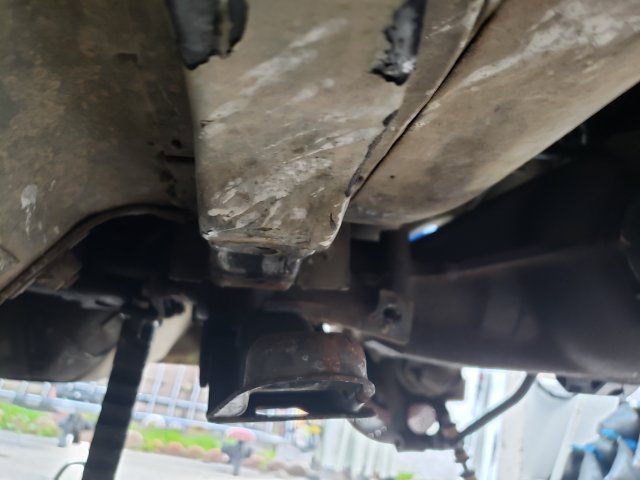

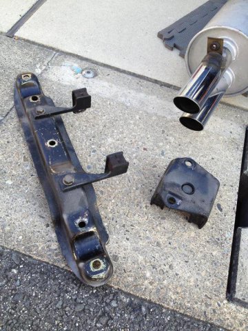

  24. So I just found this thread, and this might be the cure if anyone can confirm that they re positioned a 70-71 diff to the 72-73 position and only had to flip the diff bushing. Here is the thread, and the main picture from the thread. I will try that later this week and see if that solves the problem. I tried it quickly last night and the center line of the diff cross member didn't seem to line up, but it was getting dark. https://www.classiczcars.com/forums/topic/59052-71-z-differential-front-mount/
