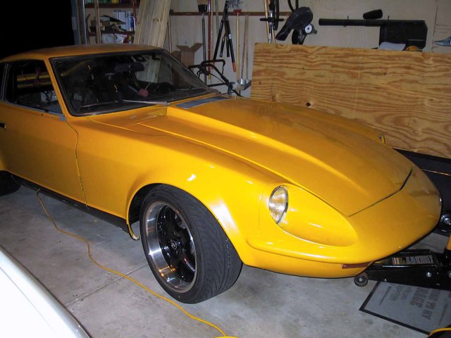

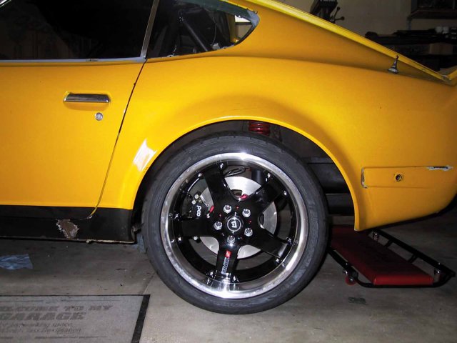

These are 18x10 Motegi wheels with flares similar to what you are proposing. I have just glassed them into the fenders. -
